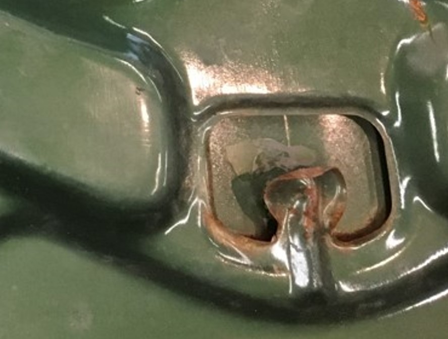

How does this even happen ?? without damage to the outer skin ??
Ah yes the Green Bastard.
After the better part of 90 minutes and getting creative I managed to get it reasonably straight... sorry for the poor pics the angle makes it still look wonky but it really is much better... trust me

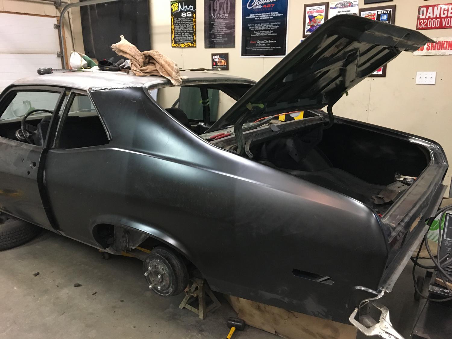

Fall 2019 Car returns home from storage. With the rear quarters complete the body can now go up on the rotisserie. Full teardown begins (with many detail photos to capture whatever original details remain for reference later).
Here are the rough disassembly steps. So... recall I only have one bay to work in thus the piling of of removed parts under the car for some time.
As returned in Fall 2019 still a roller (actually still driveable).
