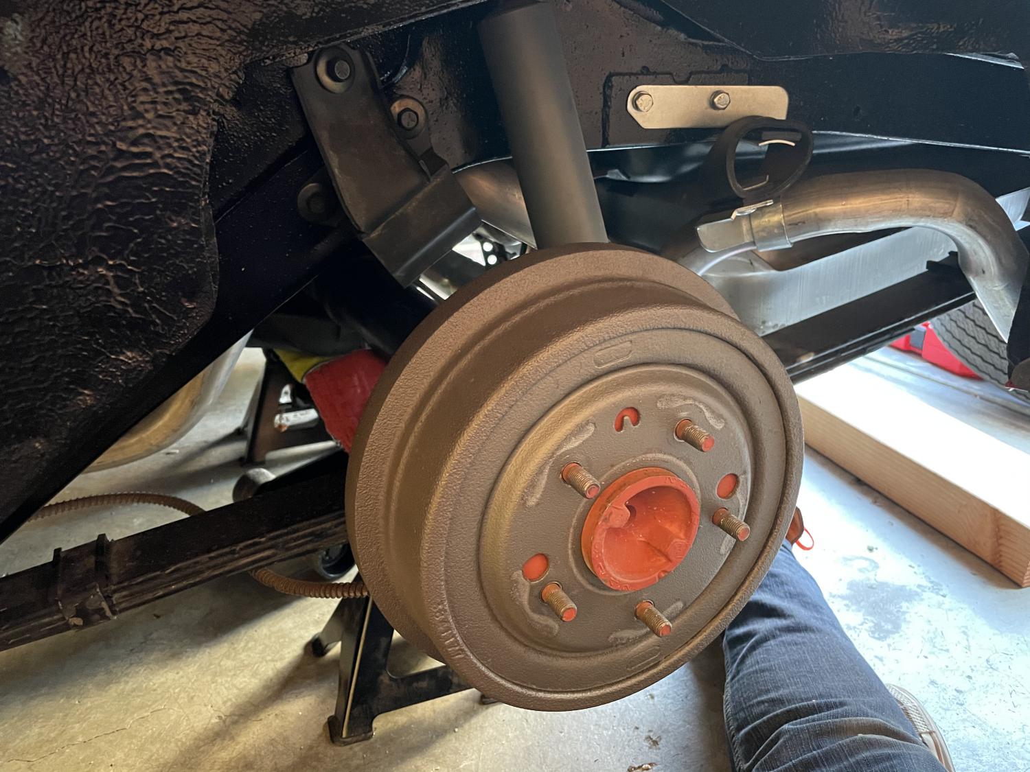

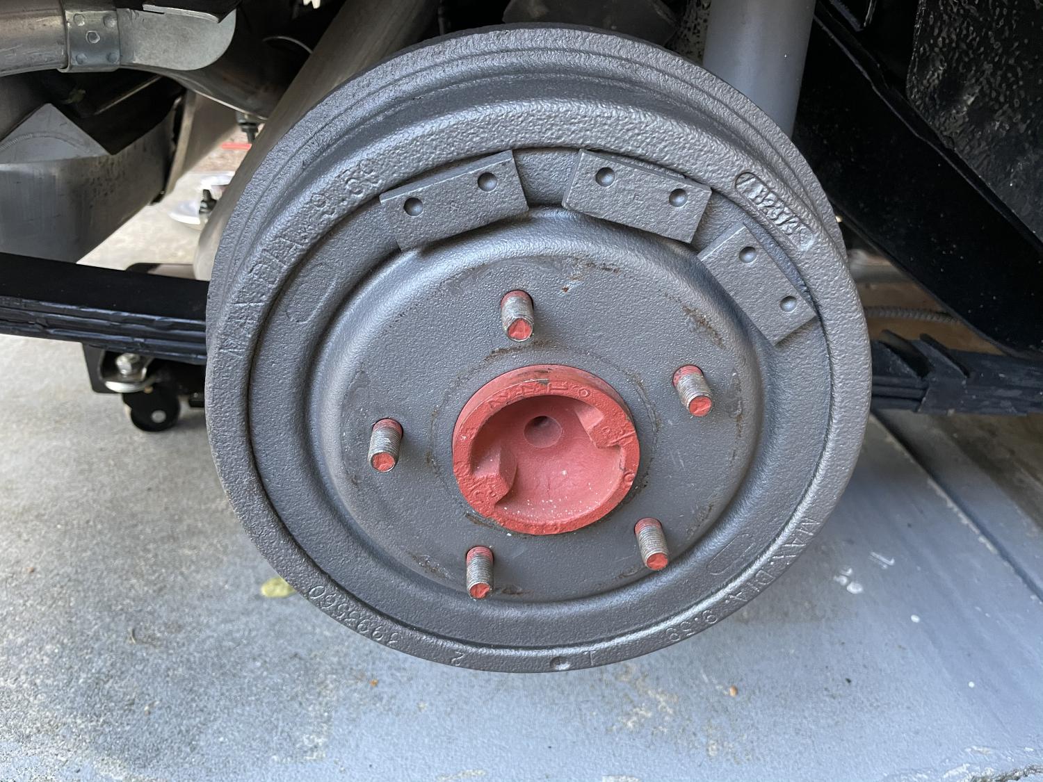

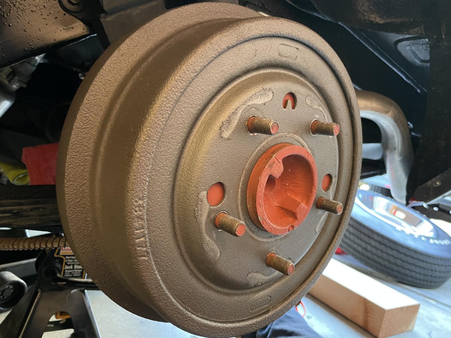

Turns out this car has the seemingly hard-to-find factory-style non-finned rear brake drums. I’m thinking to save these and run parts counter finned replacements since I plan to keep putting miles on the car. Just about every time I turn a wrench I learn something new about these cars!
Interestingly the drums are different left and right. Left side is p/n 3841177, which I think is the OE number but I don’t see a date code. Right side is p/n 3993560 which might be the early ‘70s replacement part? Note that the star adjuster windows haven’t been knocked out. Fun stuff.

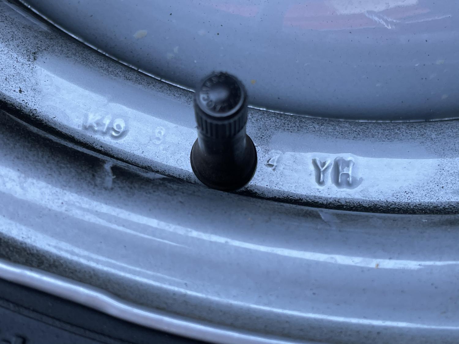

Also pulled a wheel trim ring to see the date code. Looks like August 4th so not original to the 2D car but still fun to have YH wheels.

Your are right, the drivers side drum 3841177 is correct. The pass side is a later model drum.

Date code on the 560 drum looks like Feb.23 of 73??

Aha! Yeah, looks like maybe a leading 8 actually on the 560 drum. Maybe during the resto the restoring owner could only source one of each. I don’t see any other markings on the 3841177 drum - maybe a replacement drum didn’t have a date stamping?

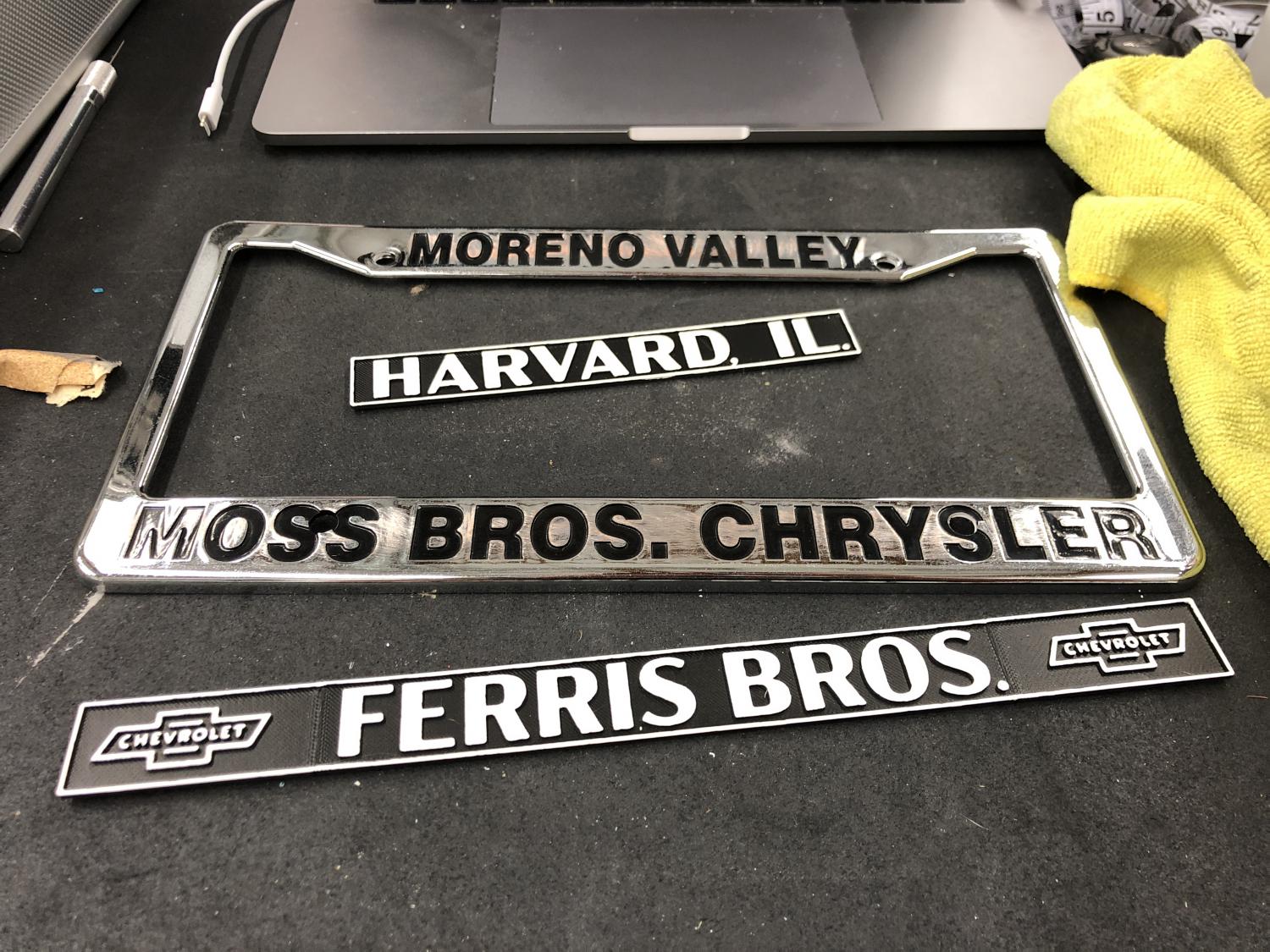

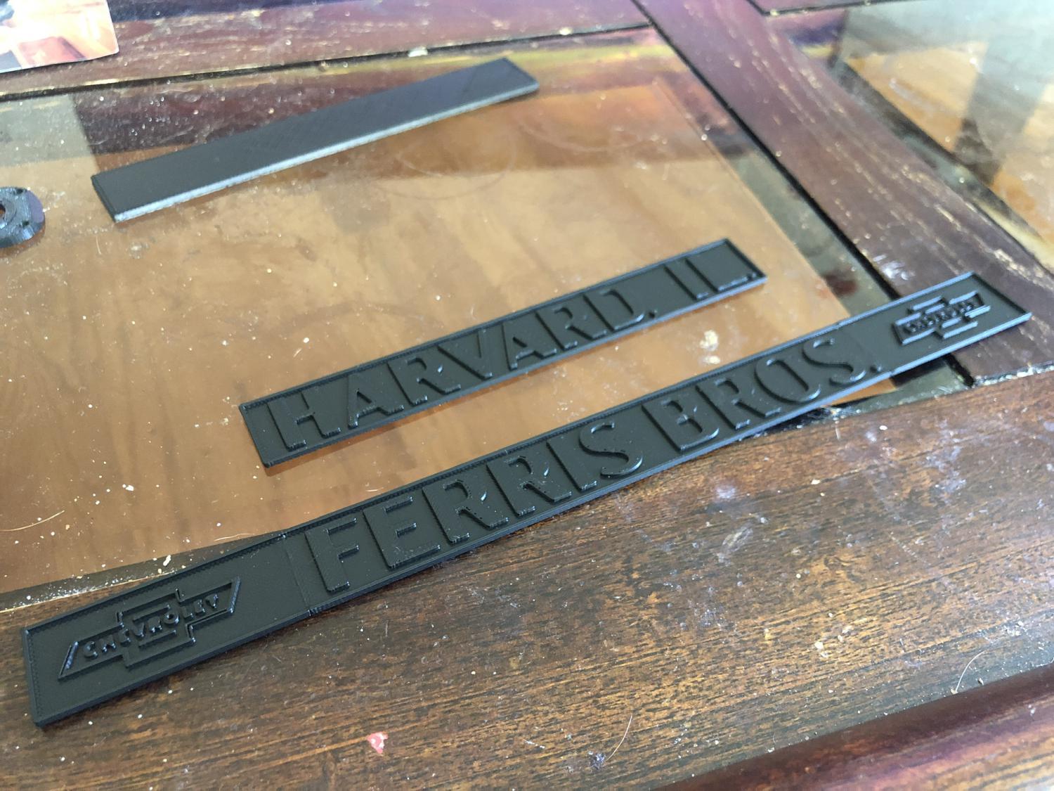

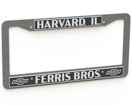

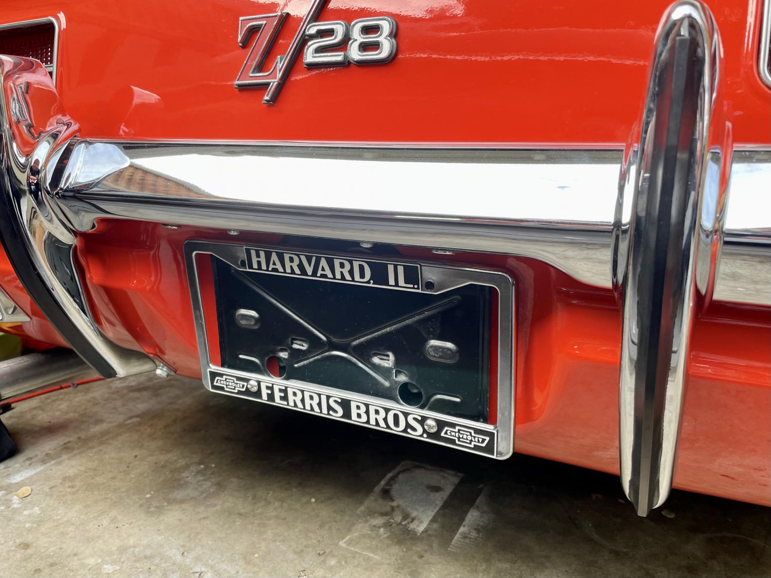

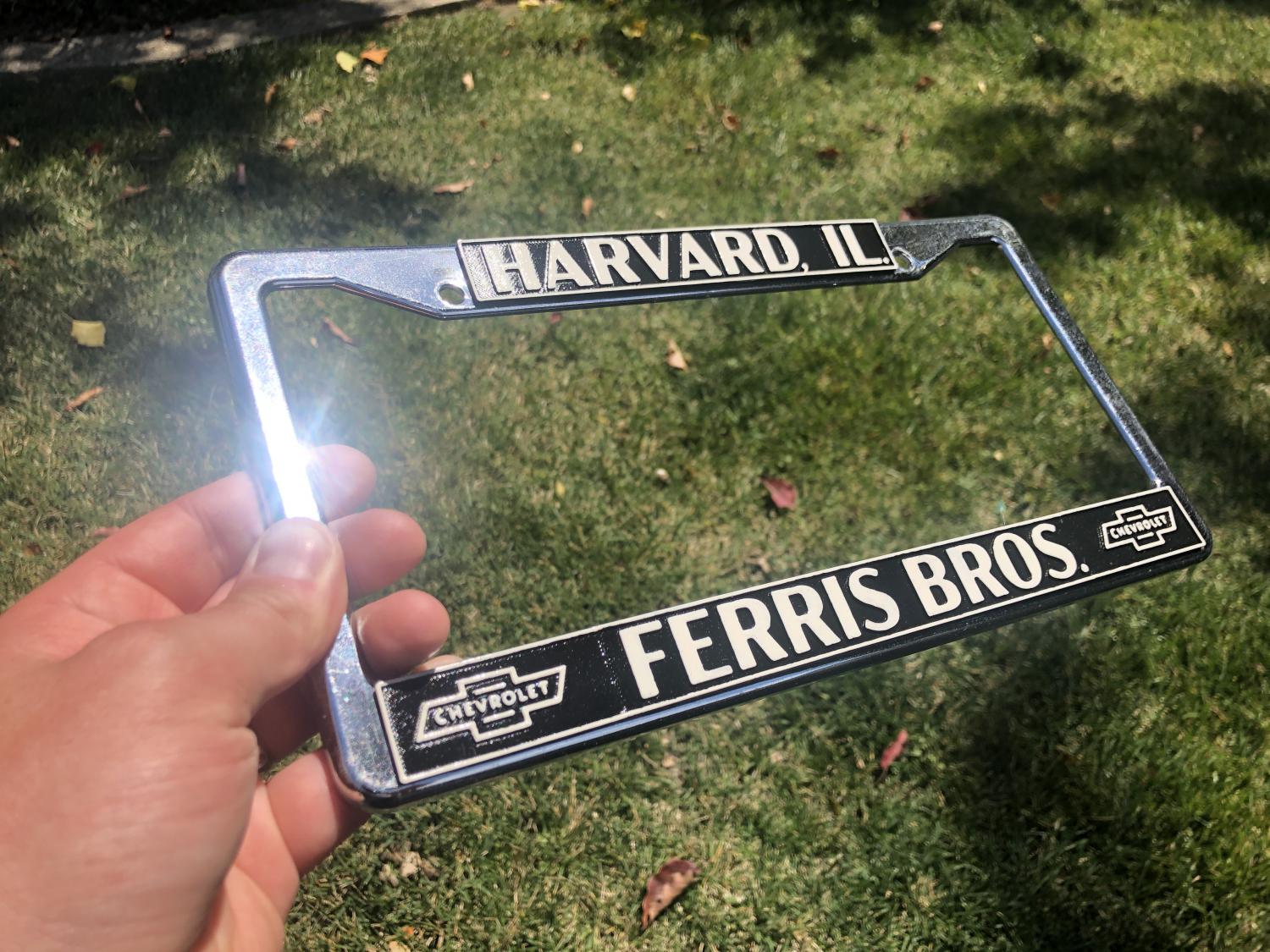

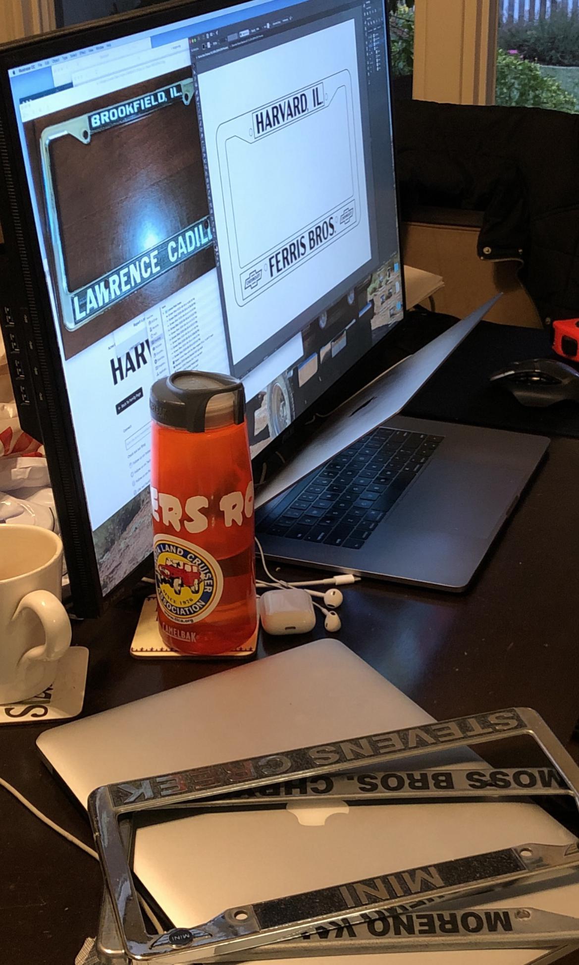

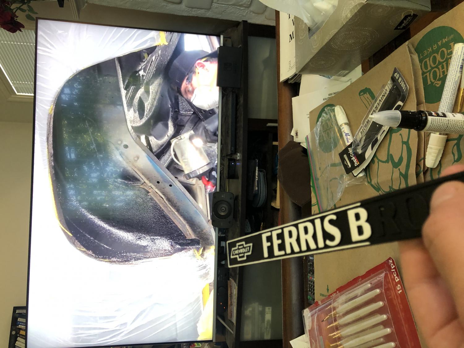

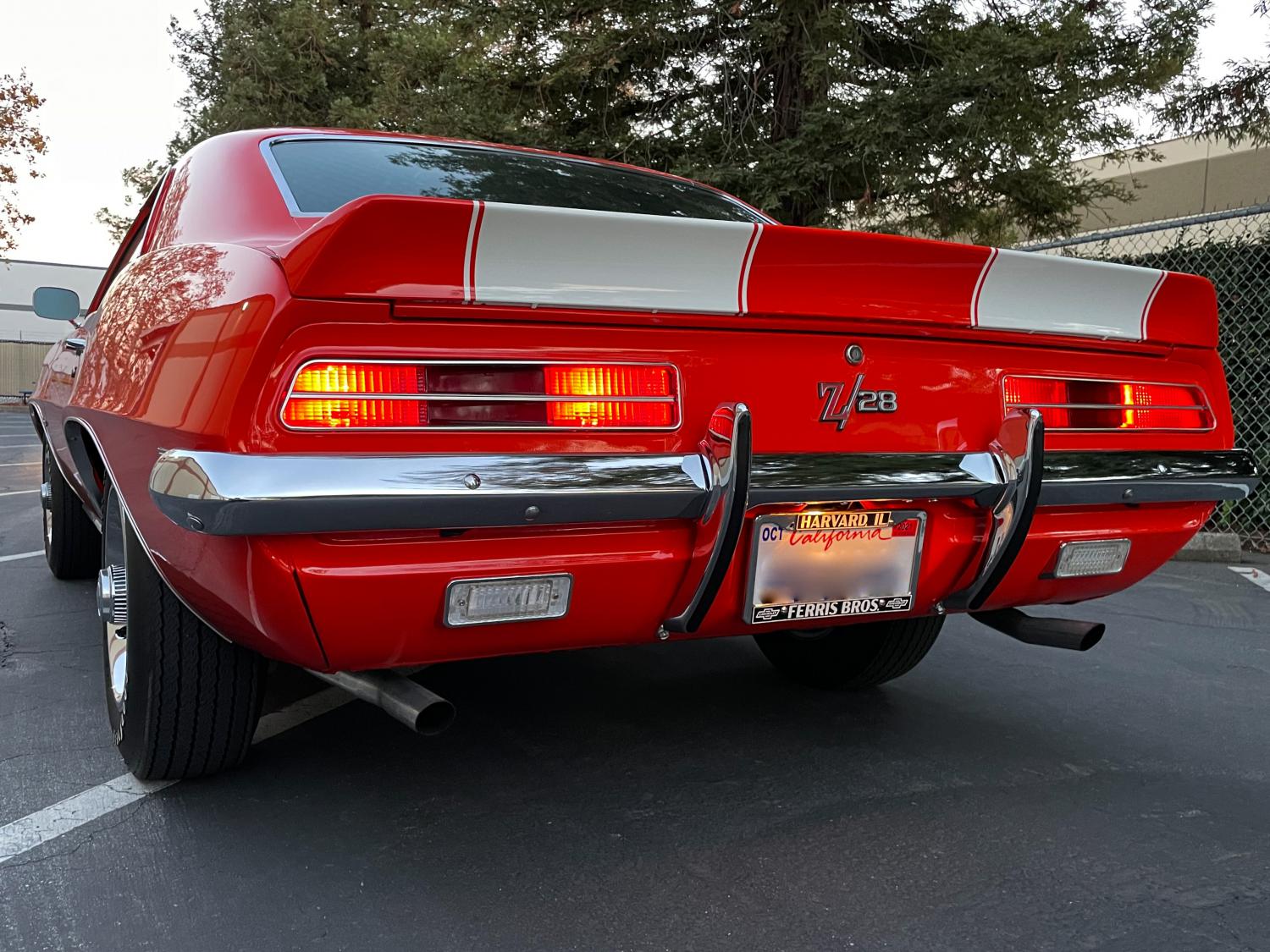

I decided to honor the history of the car a little bit and make up a Ferris Bros license plate frame. Since they’re from the Midwest I would bet they did dealer emblems at the time but being a California kid (and the concept being a bolt-on) I went for a frame, with the style influenced by so many classic California dealers.

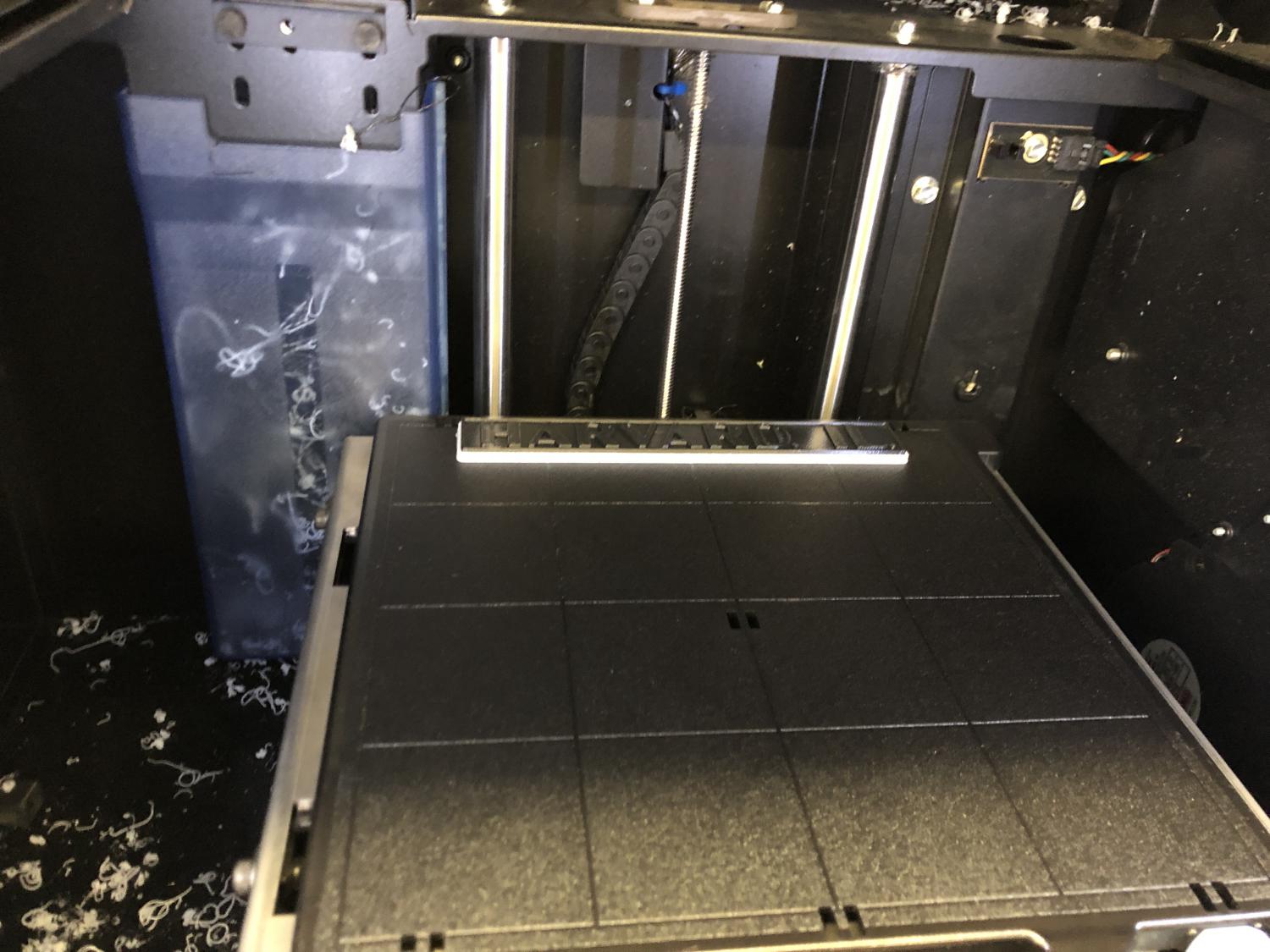

The title blocks are 3D-printed in ABS plastic, then I hand-painted the letters, bonded the blocks to an old frame I had, and then clearcoated the blocks. I decided to leave the black print texture as it both mimicks the texture often found behind vintage license frame letters and showcases how this one was made. And then up close it’s clear that this isn’t original but a modern riff on a classic look.
Pretty happy with the result

Great job!!
