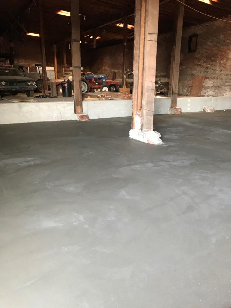

Finally, in October, the new floor was poured. Took a lot of prep to get it here.
Pretty darn level for being a fairly large area without being able to drive pins. I specified no pins, as they would compromise the vapor barrier. New floor is 45 wide, 25 deep.
It is very level for 20 feet, then a gentle 5 foot slope to the existing floor on the lower level. Space for the gantry crane, welders, sandblast cabinet, grinder, etc. Even have room to park a couple of cars well out of the work area. That way, if I run into a snag on one car, I can roll it over to the side, and still use the lift and flats on other projects.
Still needed to contend with that big 6 foot by 6 foot square hole in the floor with a well in it.
