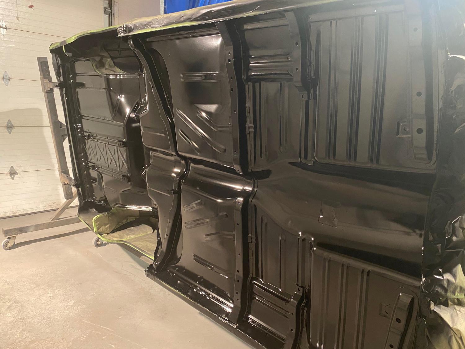

Finally back on the rotisserie!

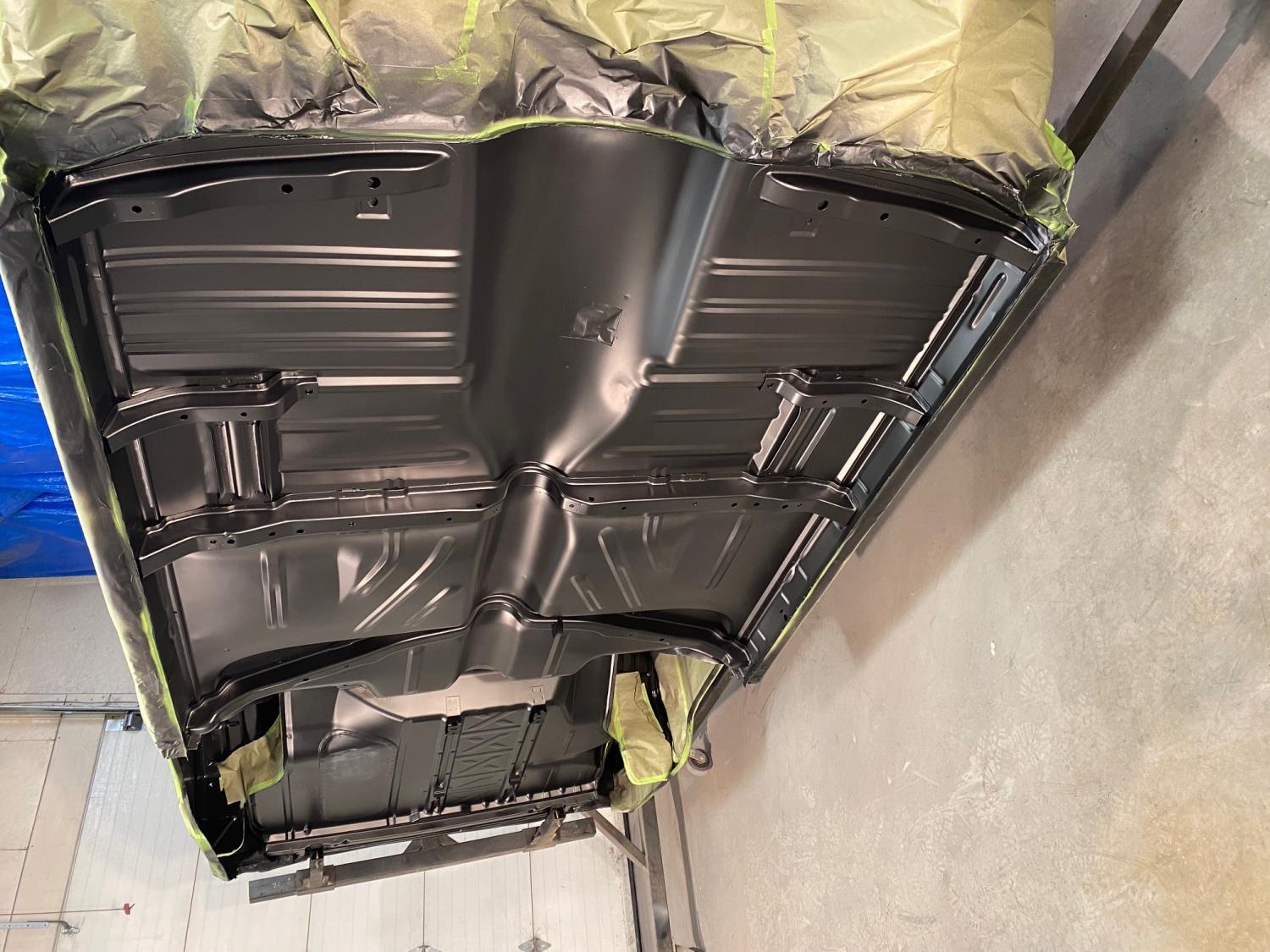

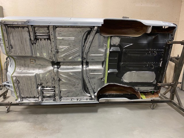

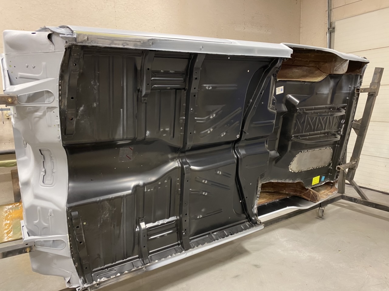

Agreed I really think its going to POP! Had to take a week off from sanding no skin left on the tips of my fingers. That EDP coating needs to be removed. I found lots of surface rust under it. Some spots it just flaked off. Probably spending way to much time on the bottom of the car.

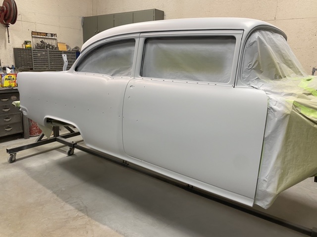

bottom of the car all seam sealed up epoxy primed and top coated. Now onto some exterior color!

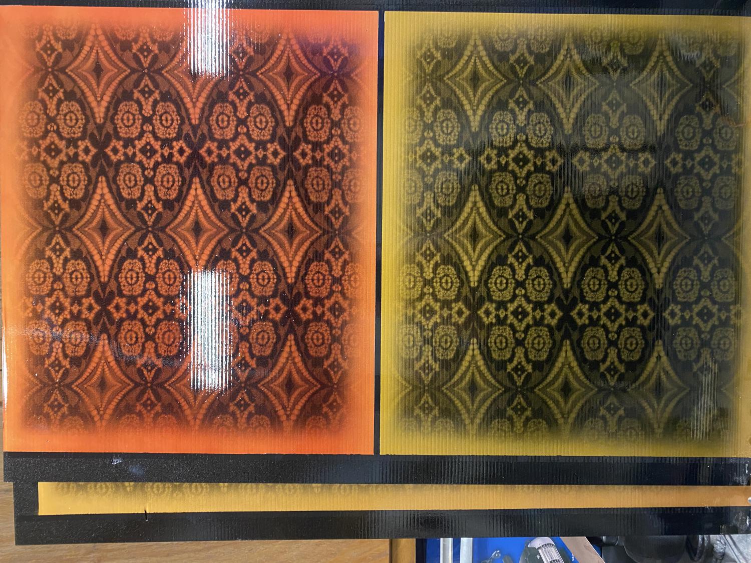

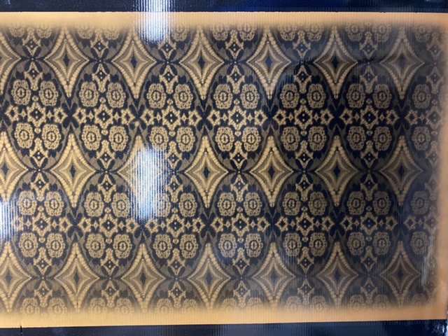

Spent Saturday messing around with some lace panels for the 55 roof. Utilizing black skylight base I applied the gold base over the lace. Then tried a couple of coats of yellow and red candy. I think i’m just going to stick with the gold base and no candy. Still pegging the fun meter blocking the car out!

That will be cool. Maybe just a little flake in the gold to make it glitter in the sun ?

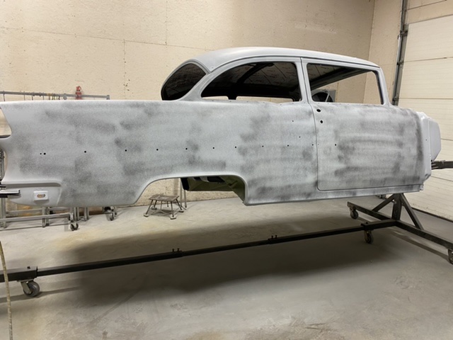

Oh so close to color. Onto second round of block sanding!
