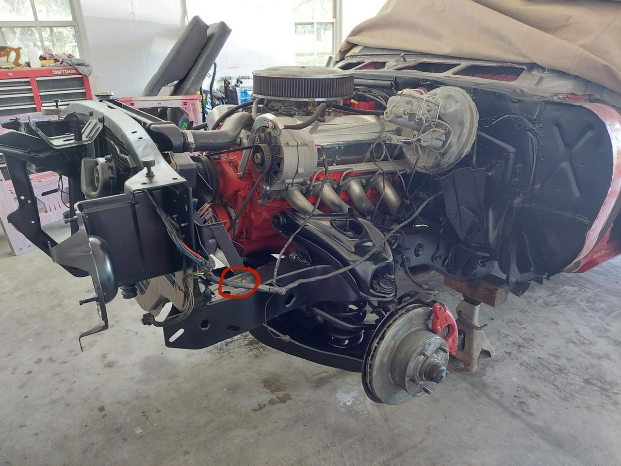

Lack of frame mounted bump stop, and what appears to be the 3rd elongated hole on the horn…. Hence I said “that appears to be” as the wiring harness is in the way. FYI I never admitted to be 100% correct as I could always be wrong.

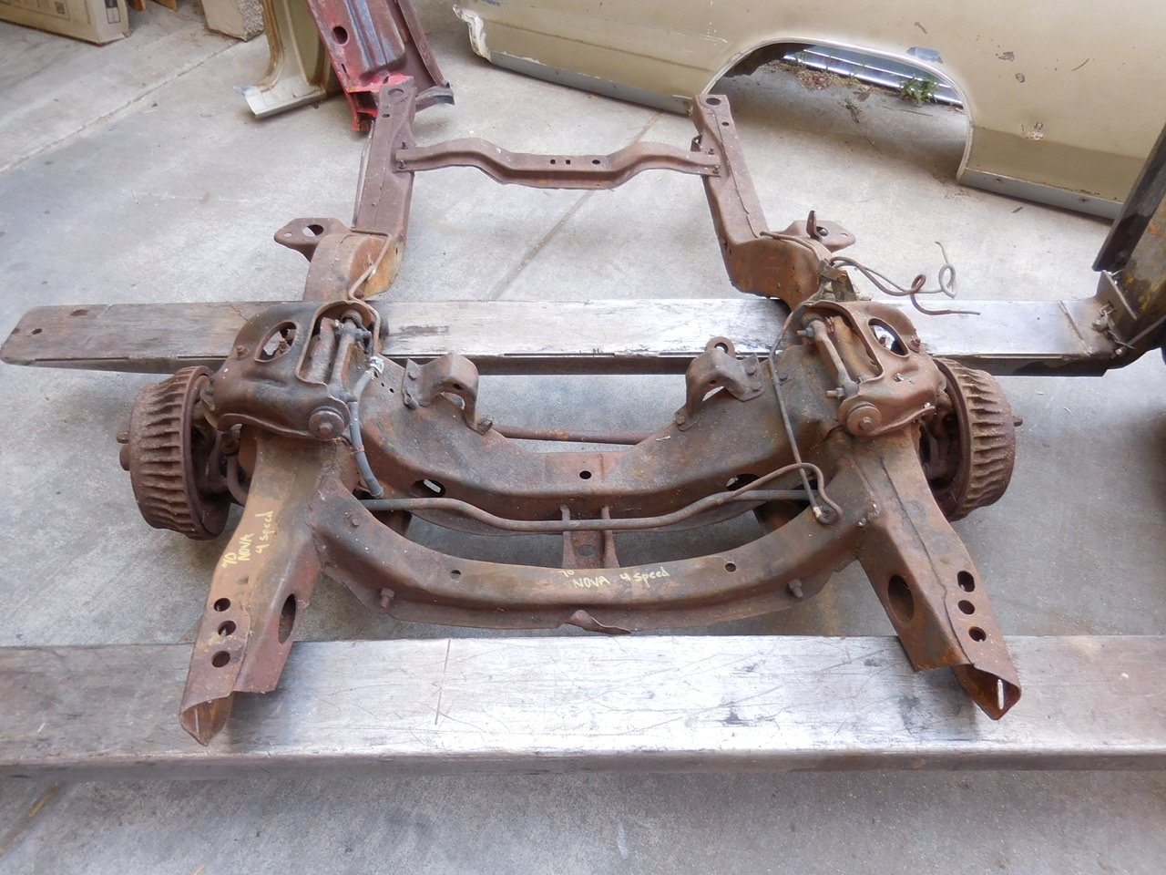

In general.

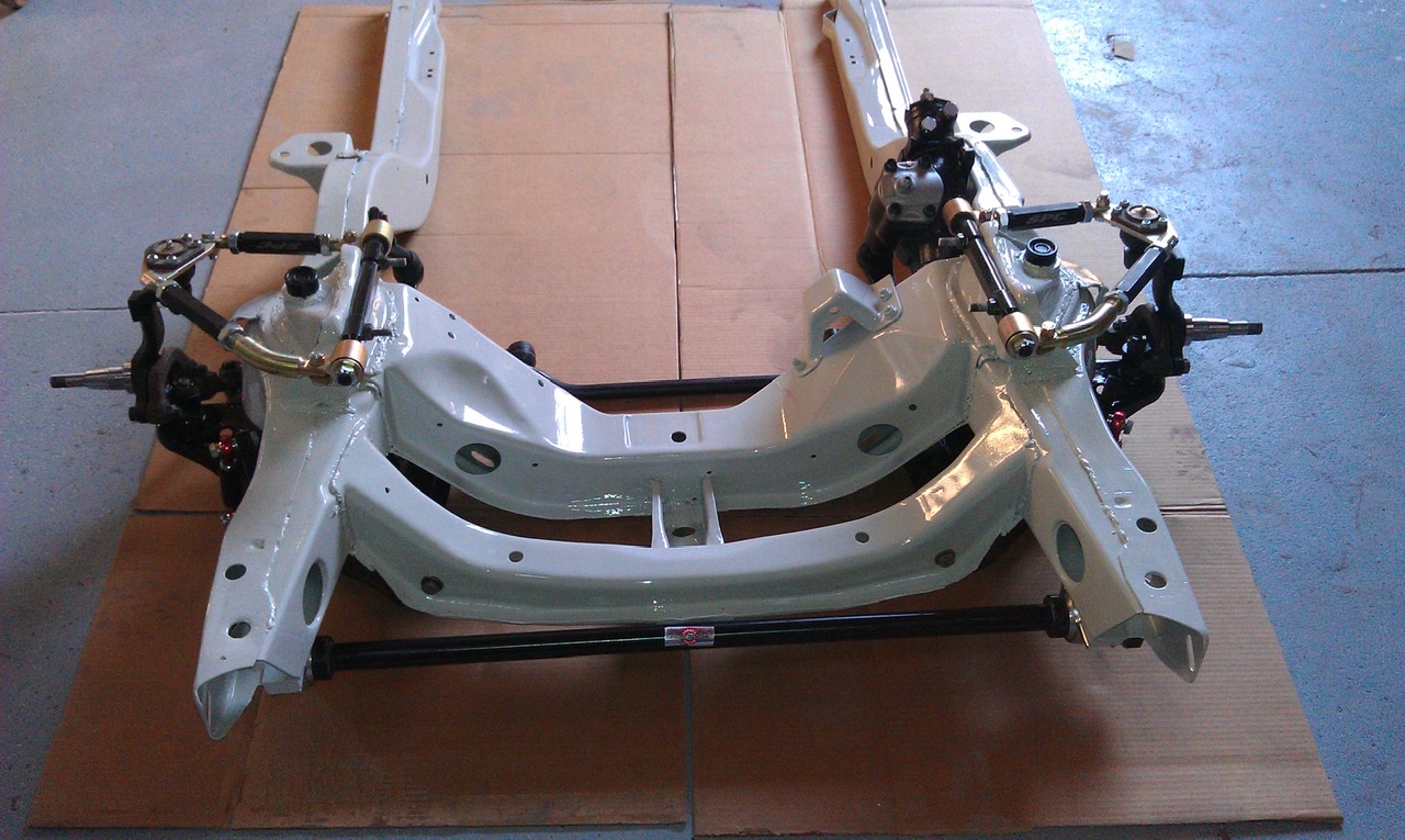

68

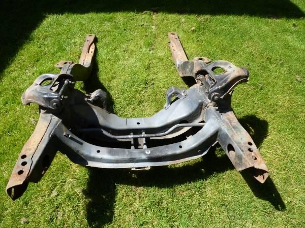

69. Now there is some overlap between 68/9 but you get the general idea. Also the location of the bump stop changes each year. That can be found here..http://www.camaros.org/suspen.shtml#aarms

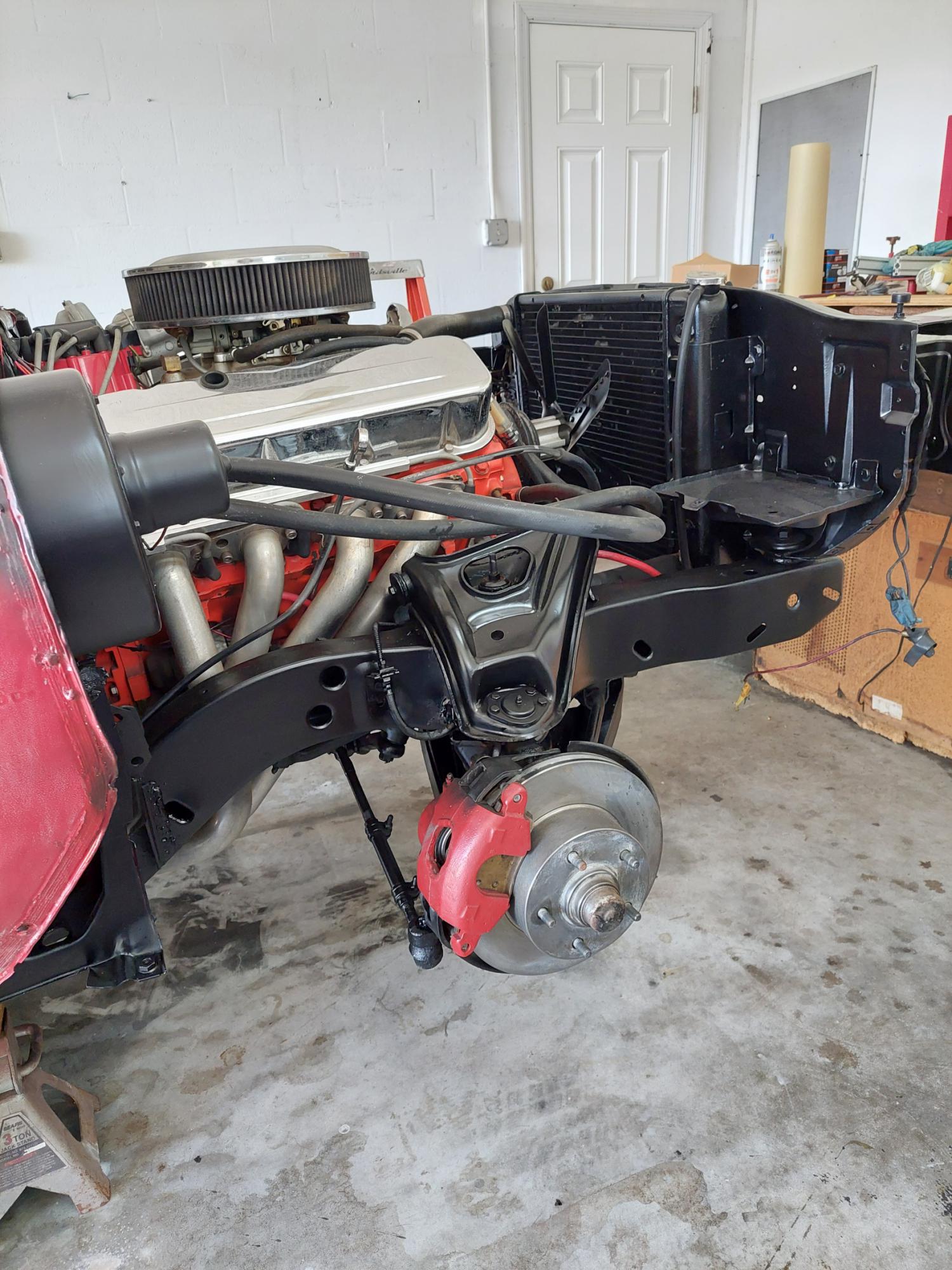

Thanks. I don’t believe the welded bump stop bracket would be visible at these angles. There are no bump stop bolt holes in the a-arms, and there is no elongated or round third hole. Looks like a 67 frame to me. That 69 frame you posted says 70 Nova on it.

Nova and camaro shared the same frame.. as I said I could be wrong from the photos presented.
