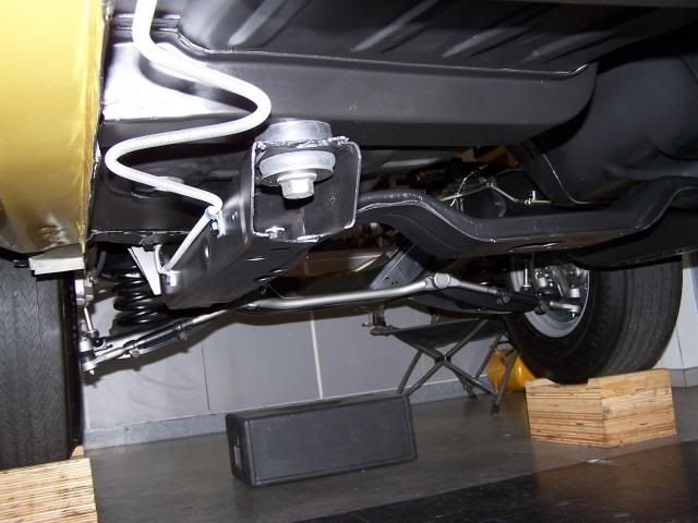

After getting home from the GM Nationals/Solid Lifter Showroom, I jumped right back in. I stuck the chassis back on the Nova. I also put all the brake and fuel lines on, that I picked up at the show.
I also got the sound deadener in.

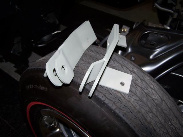

I also picked these up from Paul in the Solid Lifter Showroom over the weekend. I blasted and primed them. Still deciding on a color, but yellow is probably the #1 choice.

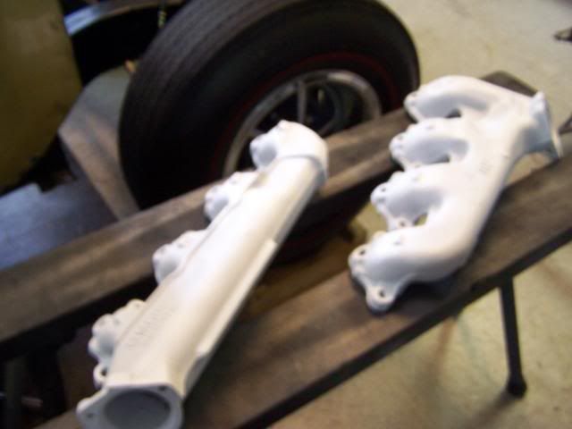

Lots of progress since getting back from the Maryland Chevelle Show. Got the exhaust manifolds back from alum skinning. I'll paint them tonight, and put them on the motor.

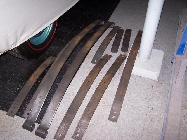

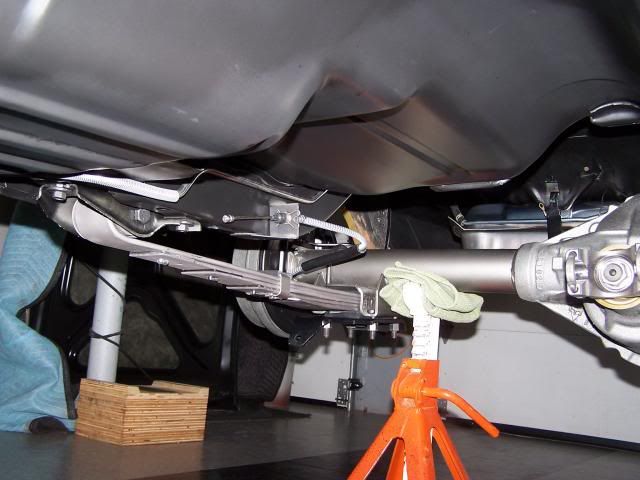

Picked up the rear leaf springs at the Md show, disassembled, stripped and sanded, then painted and reassembled them, and bolted them to the rear.
Got the rear installed. It fought me a bit, but it all fell into place.
I just painted the manifolds, so I added a picture of them.
