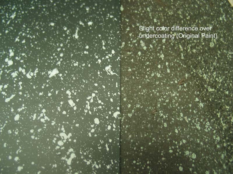

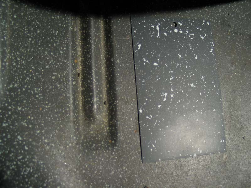

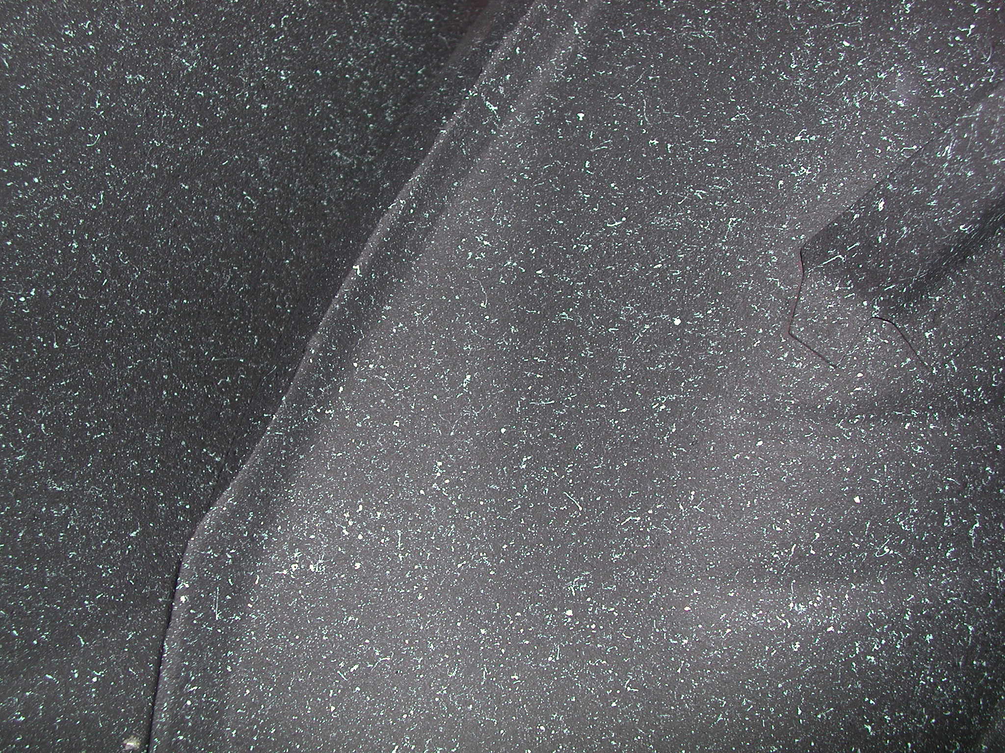

Guys, I think I finally have a good recipe for the trunk splatter paint. The dots seem to be about the correct size and pattern for a NOR built car. Here is a picture comparing where I am at and an original sample. Let me know what you think. I will take samples to the MCACN show tomorrow and compare with original cars. George

George:
Looks pretty darn good. I have been sidetracked and haven't gotten back to my trunk.
Take plenty of pics of the original cars when you compare, assuming the owners don't mind.
Thanks again for all your work on this.

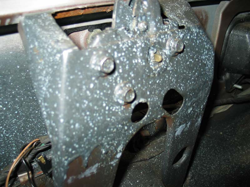

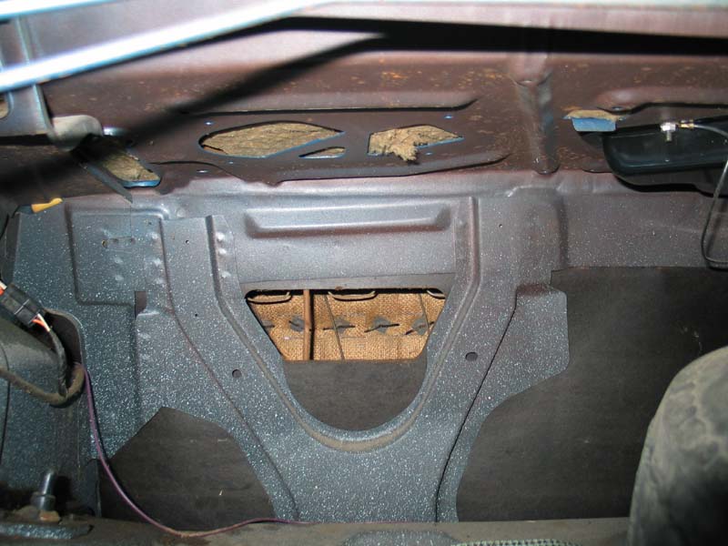

I can't comment on the Nova but Johns paint is very close to my Kansas built 70 Chevelle.
So I got some great pictures from two really nice unrestored Camaros at MCACN.
John Haislip's Silver Z very well preserved car,I used it to compare my sample. I got some interesting shots of the tail panel coverage also. The splatter looks aqua in some pictures because of lighting or flash but it actually more grey.George

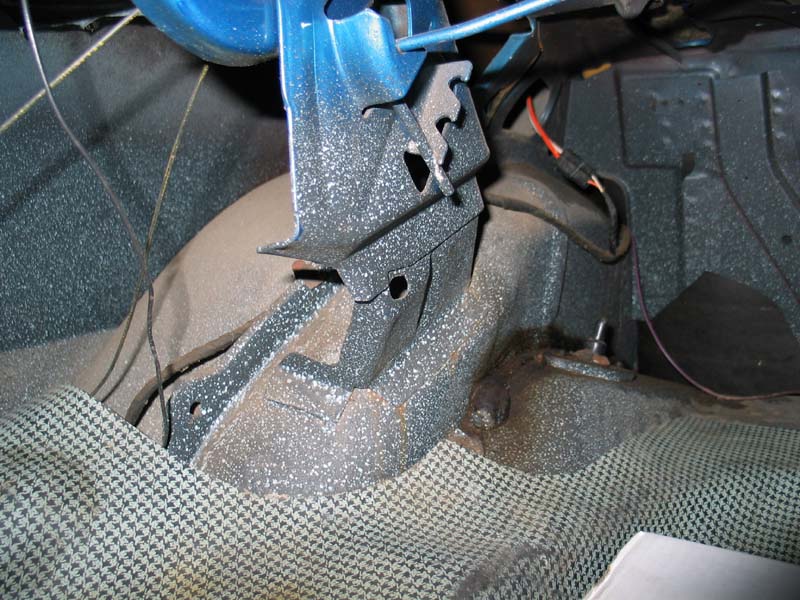

Default Re: 1969 Camaro Trunk paint
More pics

These pictures are of Terry R's car, also very nice original car 69 SS/RS LeMans blue 396 loaded. These pictures show more details on where trunk paint was applied or not. Also notice the wire harness metal tab was folded up after the paint was applied, bare underneath. George
