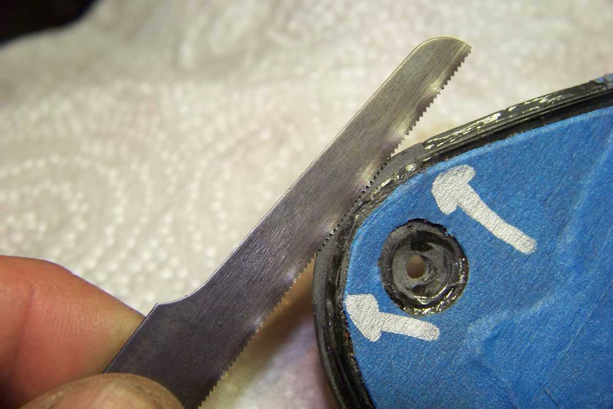

The wood grain is a pain to remove. Every inch of it has adhesive. Took me about 4 hours with a real thin blade. I then sent the thing out to be metallized and then had to mask off the edges with petroleum jelly. Then spray black. Got about 20 hours in the thing. I did this on mine about 20 years ago and it is holding up well.

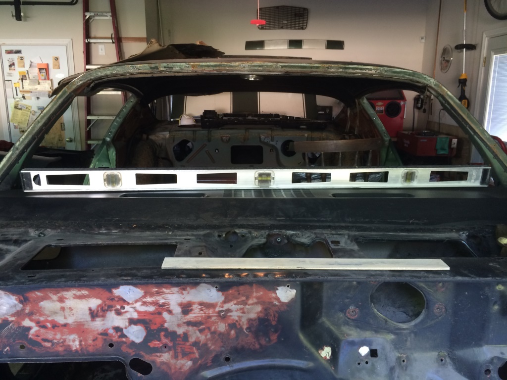

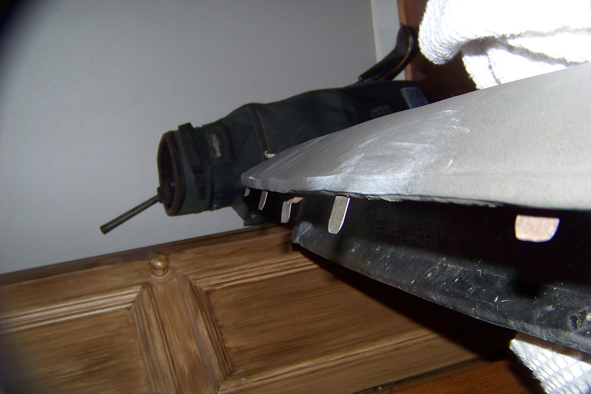

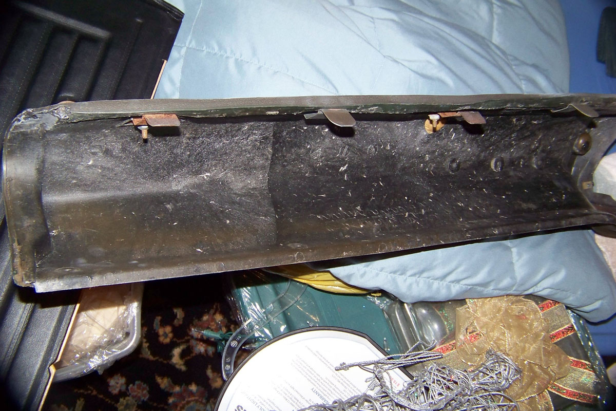

Originally Posted by BCreekDave View Post
For me the straightening was the easy part. I used a hot air gun, a 4 foot level on the undersides and a series woodworking bar clamps to slowly flatten it. My problem was the shrinkage of the original cover. This can be seen in your second photo down in post 71. The leading edge where it curls around is uneven. I heated and stretched and heated and stretched and finally got mine to wrap around somewhat to satisfaction. Not perfect, but close. Did you get yours better than the photo in 71?
I was afraid I was going to rip the cover after it started to split at the sharp angle to go over the edge after working it so much.
I used a halogen lamp and a few pairs of sheetmetal pliers with the WIDE clamping area and pulled it over.
Part of it was really good... the part I did after fixing the backing.
I first tried to stretch the drivers side about 2 months ago, prior to straightening - then straightened it and then pulled it over on the pass side. It cover was a good inch short from
I am going to get another screwed up pad and try a few things...
If I had an oven large enough I would have heated the entire thing up to about 200 or so...
I was thinking that in a black bag in the southern sun for a few hours would make the entire thing pliable.
If I were going to do a couple I would weld up a jig to hold them in the correct position so they could be straightened and stretched.

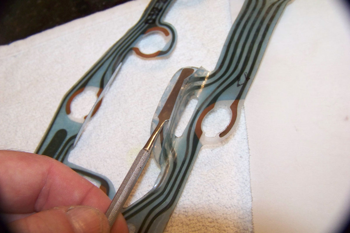

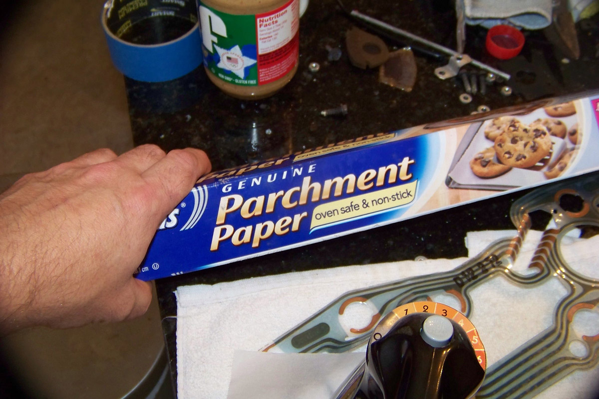

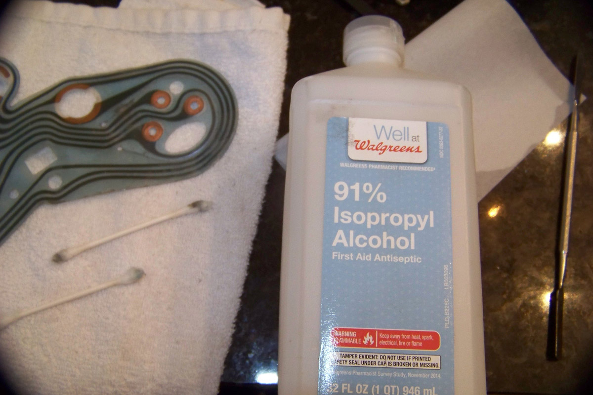

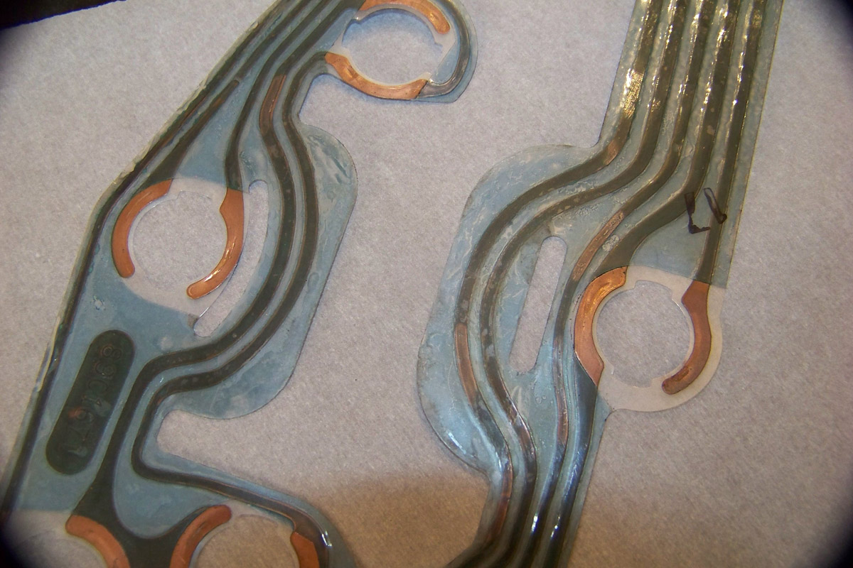

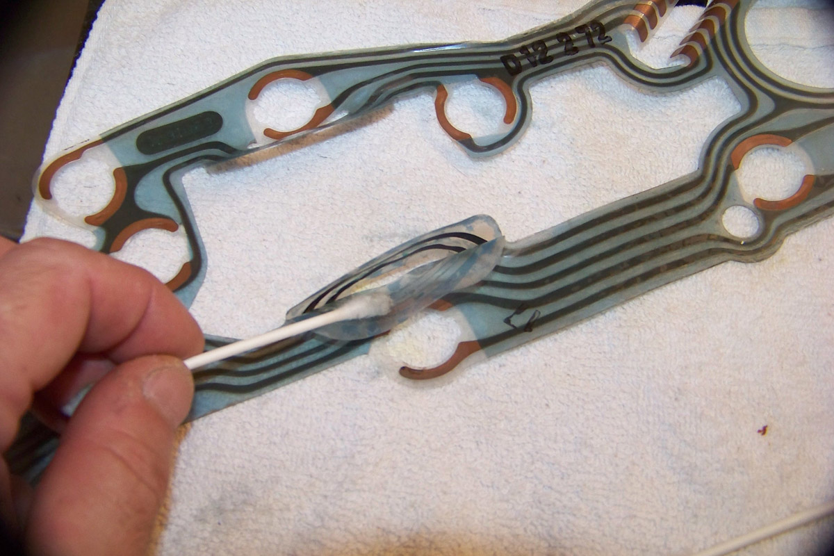

Some photos of the relaminating the cluster circuit board

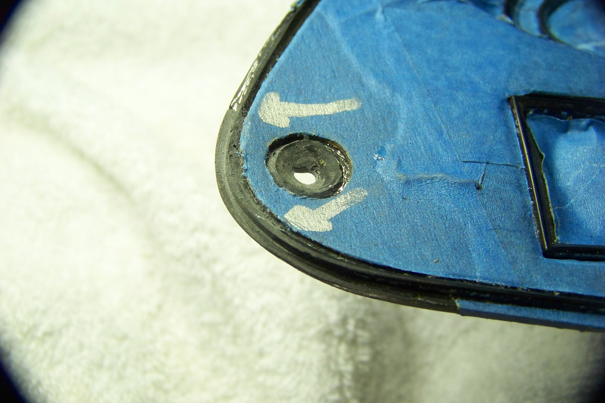

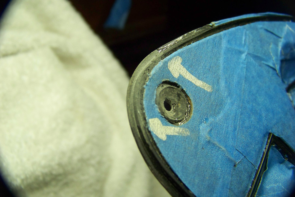

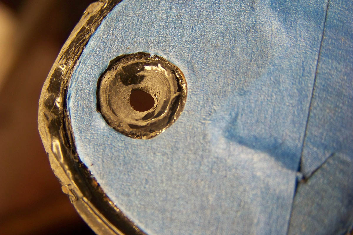

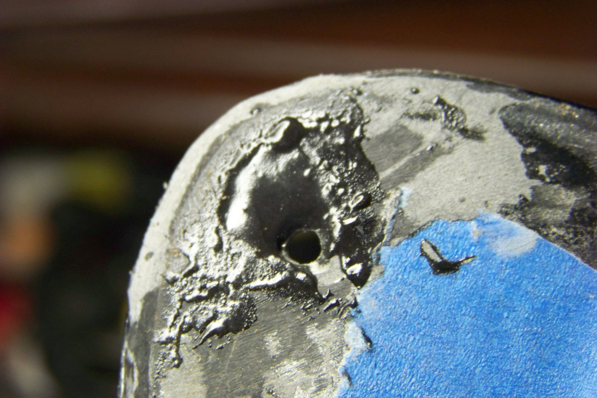

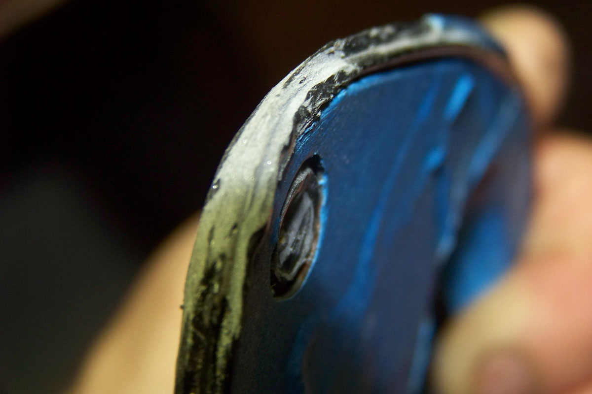

There was an entire corner and half of the screw hole which were missing... I taped up the wood grain and used 3M automix repair material to build up the area and worked it back down.
The lighter gray color is all replacement material

THE DASH PAD I realized after the first fitting about the bow on the edges - that I fixed.
The air vents I took apart so I could tighten up the vent blades and then made a hand rivet tool from a pair of hole punchers to rivet them back together.
