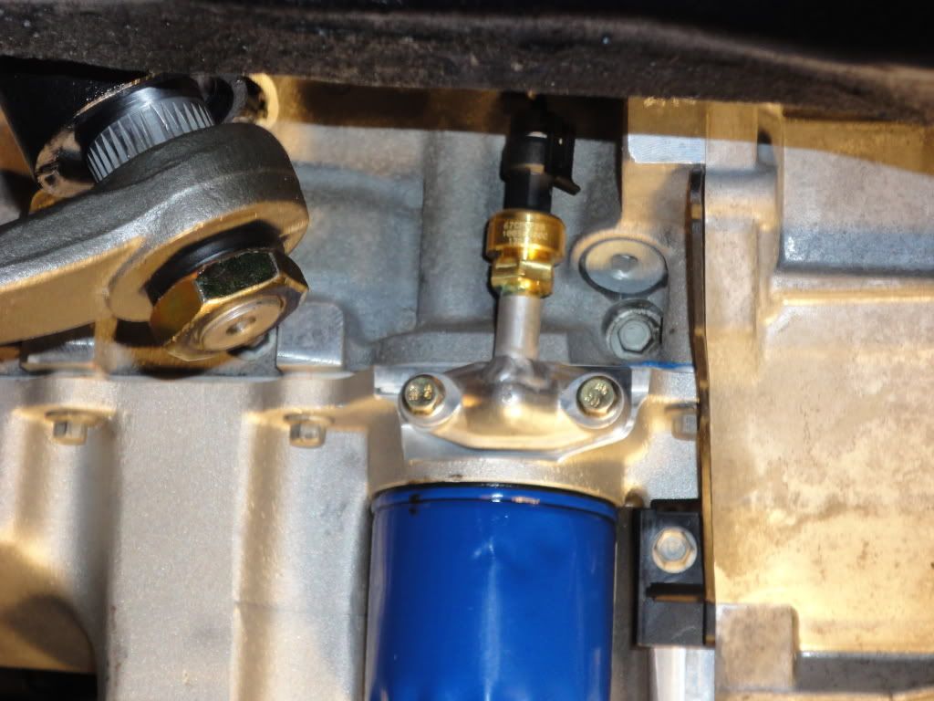

2nd issue.....the car didn't use a drop of oil thruout the trip....when I get home last night and unload the car......I noticed oil droplets on the rear of the car and bumper....I check the oil and I'm a quart down.....put the car on the lift today and I notice the oil pressure adapter for the sender that we made at the shop had a slight crack in it at the fitting and was leaking oil all over the bottom of the car.......small issue but a big mess on the exhaust system....burnt on oil....Yuck!!........I'll make a new one tomorrow out of a solid piece of aluminum......I used 1/2" round and welded it to the stock GM piece but after tapping the pipe thread it was pretty thin and cracked there.....Lucky it happened at the end of the trip.....
Other than that the car drove like a Dream without issues at all......and that Big trunk was a blessing......LOL
Here's the Culprit.......

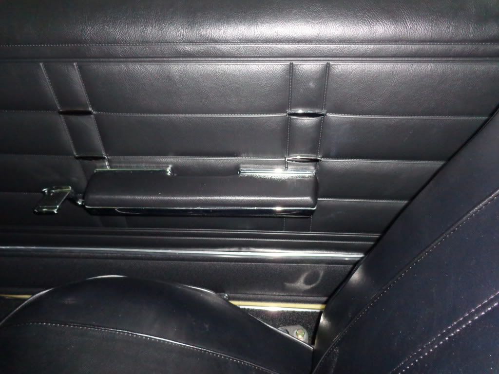

I also took the Door Panels off and added the decorative trim pieces that I mistakenly thought would have been included on fully assembled door panels as bought......LOL....again...didn't have the time to order and install them prior to leaving......but....they are now installed....

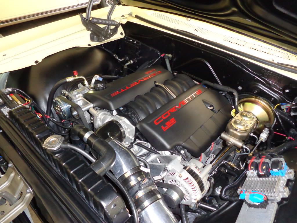

I also got sick of looking at the engine without an engine cover......I had a Camaro engine cover I was going to use but it ended up being too short....so I got some Corvette covers and trimmed them to fit.....
