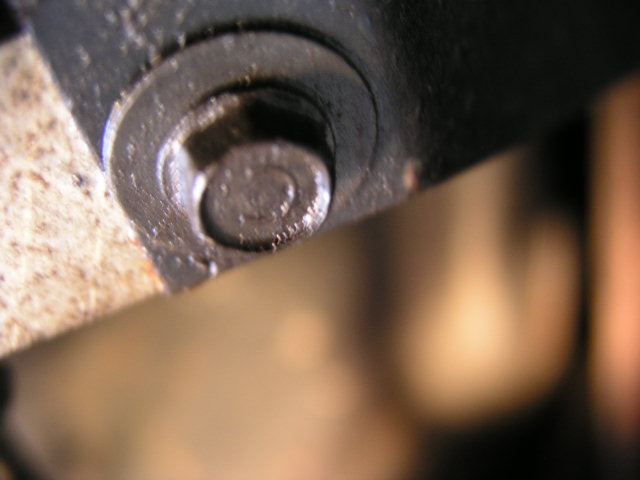

This is it coming out the back of the hole . It still has orange paint on it. I'm thinkin this is a big points deduction.

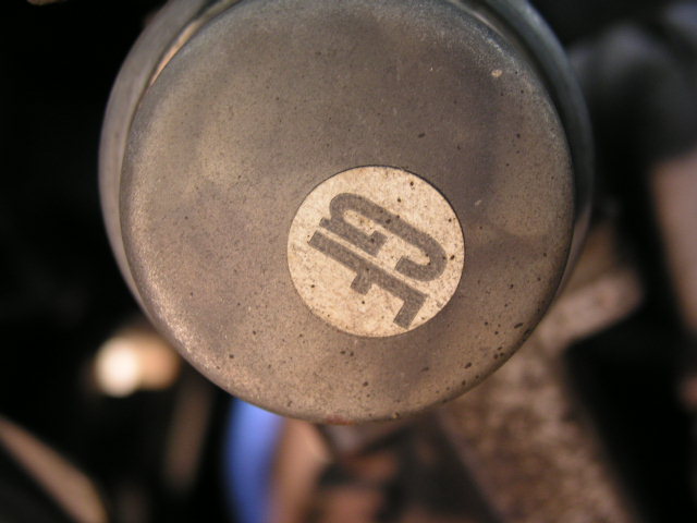

alt bracket on thermostat housing stud...no washers, just the nut.

transmission flexplate cover bolt with washer.

Nice white paint highlight on the Rad.tag.
Does the mounting end of your fan clutch stalk have any black paint on it/around on it?
Interesting how the W/P pulley mounting face has bare metal showing under it.
