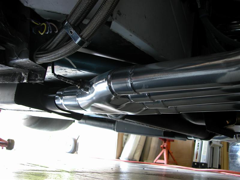

Is that part of the exhaust going on the car, peeking through the floor pan?
<font color="blue">
You got it right. I designed an exhaust in my head, (because the car has verry little ground clearence), &amp;
with the welding skills (&amp; same crazy mind) of Gene Goodyear it came to life.
The exhaust slips together, so no clamps hanging &amp; even has a bolt in crossover pipe.
This saved me 1.5" which was what I needed.
I Silver Ceramic Coated the headers (for obvious reasons) &amp; black ceramic coated the exhaust &amp; crossover. It looks killer.
