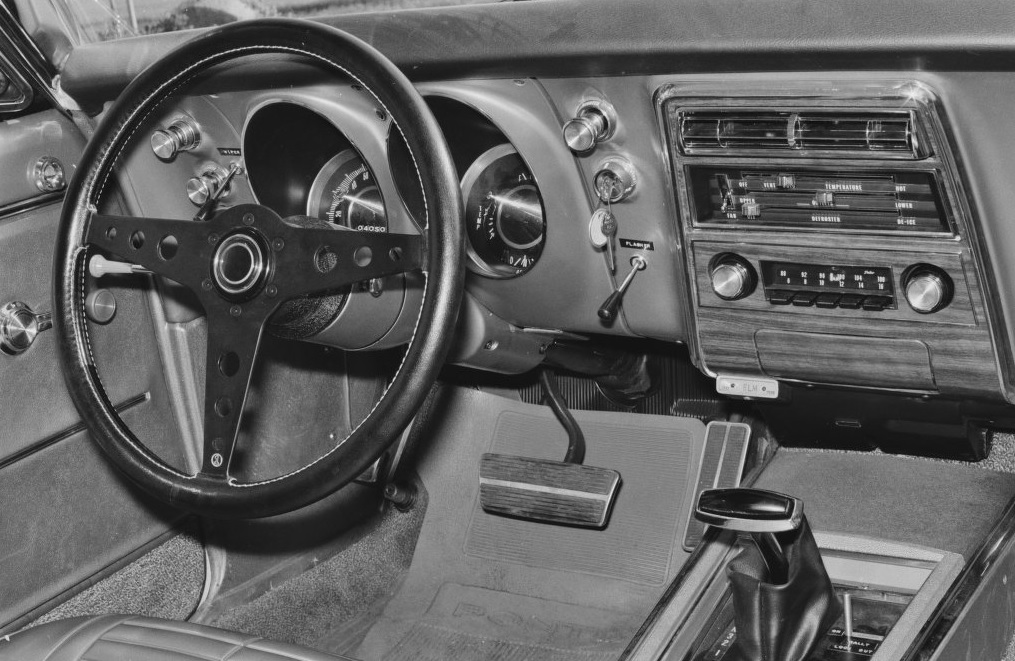

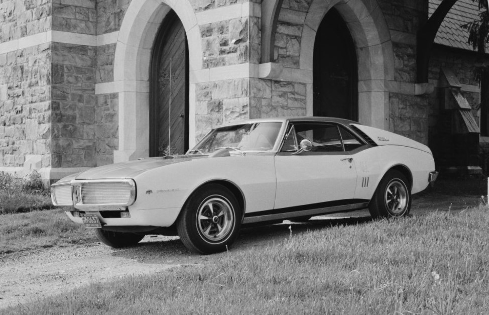

My car is the OHC Sprint engine car. For factory options my car has rally gages, console, tilt, wood wheel, deluxe
interior, 4 speed, am/fm, hood tach, rally wheels, tinted glass, power disc brakes, and radial tires (actual option
on Firebirds in 67). For Fitch mods there's Koni Front shocks, Lucas Flame thrower driving light, mesh in front of
the light/grill, adjusted caster, rubber bumpers on the shaft of the front shocks (to change spring rate), re-valved
steering and brakes, headlight flasher switch, one time wiper switch, light monitoring panel, leather steering wheel
cover, Judson coil, dual exhaust, and the fins an the quater panels (they were to cooling the brakes and let air into
the interior but never developed). Also for the 6 cylinder car Fitch want to supercharge it, but never actually
developed it. A fitch opted car would sell for about $1000 more than the sticker price on a car.
The car was fairly solid when I bought it in the late 80's except for the trunk which was rotted bad because the fins
let alot of water leak in. The floors and doors were good.I had to replace the roof skin because someone put a moon
sun roof in at some point. The interior is all original except the rug and headliner. The car was missing the mesh covers and light monitoring panel, I recreated them from pictures and by talking to Fitch.
I found 2 broadcast sheet in the car both say "Tag Fitch & Co." and the Pontiac PHS billing card shows it was
paid for by the Engineering department of Pontiac.

That thing looks wild! Kinda has an AMX look to it with the fins...did those OHC-6 cars originally come with dual exhaust and the 4-barrel? How does it run?

Thanks for the compliments on the car.The resto was done 12yrs ago and it's held up pretty good except the engine paint. It does look like a big AMX from the side, somedays I think it looks cool, anothers I wonder... but it's different for better or worse.
Pontiac offered the OHC in 2 versions, the base was 165hp 1 barrel carb engine, the other was the Sprint 4 barrel with 215hp. Pontiac never offered dual exhaust on either, Fitch added the dual exhaust.
The OHC Sprint (4 barrel) engine runs great with the 4 speed (They say autos are dogs),the 4 speed has a 3.11 first gear and the Sprint engine redlines at 6500rpm, so it suprises alot of people because it gets up &amp; goes pretty good but it tops out were a high horse V8 keeps going.
A few of the Fitch cars have shown up from time to time, but they seem to disappear again. I talked to an original owner of one of the Fitch 400ci cars, she sold in the late 80's to someone in the mid-west haven't been able to find it. She also said she thought Fitch sold one to someone in Italy. There was another that was for sale at the Pomona CA swap meet about 7yrs ago, I here that it might be in the Long Beach area now. Also in the early 80's in Tampa or Daytona Fl, there was one for sale.
Fitch was trying to make a euro GT type car. He was even going to make a supercharger for the OHC package but never followed though on it. He actually liked the OHC engine car better because there was less weight up front which helped the handling over the 400ci cars. He felt the OHC with the supercharger would have been enough for 99% demand made on it.
