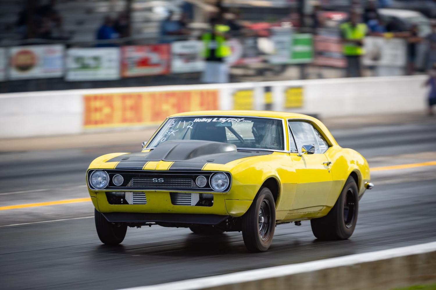

I got the car out last month first time ever, went 12.4 and on my 4th pass went 9.30s. Later went 6.04@123 in the 1/8 maybe a high 9.2x pass.
I am redoing some of the front suspension for next season to rid the car of the current death wobble at high speeds.

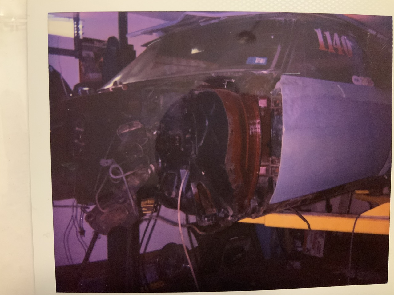

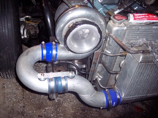

This is my turbo charged bird pretty much locked myself in the garage w my buddy Chris for 48 hrs built the whole set up w the goal of running 9s and went 10.00 right off the trailer . That was carberator and no. Inter-cooled w water meth and a diesel turbo.
I sized the turbo this way.
455 cid x 6000rpm is the same air flow as 900cid and 3000 rpm !
Bingo Detroit diesel turbo works!
Everyone said it wouldn’t even make it down the track. I did a forum on a Pontiac site teaching guys how to build it and I had guys in New Zealand. Iceland , Australia all over the place w my basic designed set up on theirs cars. Put it together last long block version in about late 2005 and changed it up top to fuel injection- Intercooler and a ceramic ball bearing turbo - right before the HPP race at englishtown 2009 (which I won BTW ) it’s still together running without even a spark plug change. Still has gen 7 DFI on it and one of Jason betwardas old turbos I got from a buddy who worked at turbo people . Which I’m proud To own jason was the best of the best!
