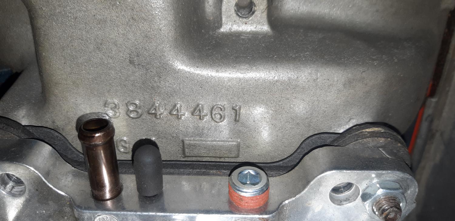

Thanks guys, and yes, no painting it for a while. I’ll enjoy it as-is then get to it in the Spring. In the meantime, I’ll fix whatever I find it may need.
Very happy with it! Right now, it has the 340HP intake on it and I can see it’s a Winters intake. Are these dated? I though they were but were on the underside, maybe? It has the Winters logo on it, and it appears it’s correct for the 340HP engine. Any way to tell it’s a real one?

Dave, the part number is on the top of the manifold and should be 3794129. The date is on the bottom of the intake manifold, but it's under a metal splash plate that is riveted on.

Thanks Tim. Mine has the Winters snowflake, but the part number is 3844461 behind the carb.
Just a regular speed part by them?

I think that’s a 64/65 365hp or 350hp L79 piece

You're correct, Tom. 1964/1965 365 Horse intake.
BINGO!
