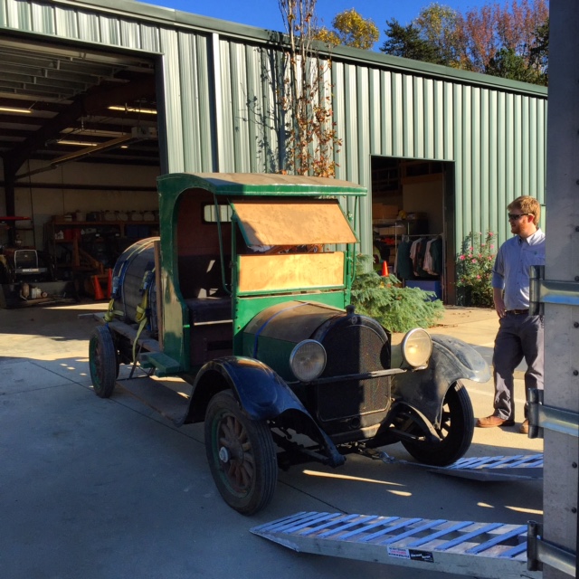

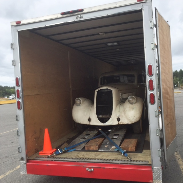

Tommy,
I haul a variety of transportation related cargo.
My first enclosed trailer had a ramp door with extra hinges on the bottom.
It wore out from daily use in less than a year.
I need an 8 foot rear clearance door because I haul tall vehicles on occasion.
Rear barns doors actually cost more than a ramp door.
I requested (5) hinges per door to save on hinge wear.
My ramps are commercial quality American Made by Discount Ramps in Wisconsin.
