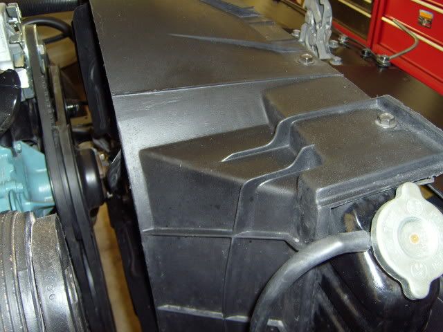

Running out of things to do at the moment so I decided to tackle the annoying unused and incorrect mounting hole in the top of the radiator shroud that comes standard when you buy the new/repro GM shroud.
Here's the before shot:
What I ended up doing was getting a 1/2" hole saw and boring out a 1/2" plug from the burned/melted original shroud that I've had hanging in the garage:
I then carefully filed the edges of the plug with a flat file and used a small rat tail file to file the hole in the new shroud. When I was satisfied with the fit of the plug, I placed a piece of tape on the underside of the hole and filled it with 5 minute sandable epoxy. I then pushed the plug into place. After it sat overnight I used my mini-mouse sander with some 240 grit and made the excess epoxy disapear. A few mist coats of SEM Laundau Black (my new favorite paint) and the repair is invisible.

Looks great Steve. I am going to take your lead and use SEM Landau black to restore my original fan shroud for my Nova. Did you use SEM's plastic prep or other prep to ready the plastic for the SEM paint?
Sam...
  #760
Old 07-07-2009, 09:05 AM
Join Date: Sep 2001
Location: Santa Cruz, CA
Posts: 6,585
Thanks: 404
Thanked 727 Times in 376 Posts
Default Re: Home at last...
I don't like the plastic prep. I have never had a problem cleaning the surface with lacquer thinner and applying the SEM product directly.
