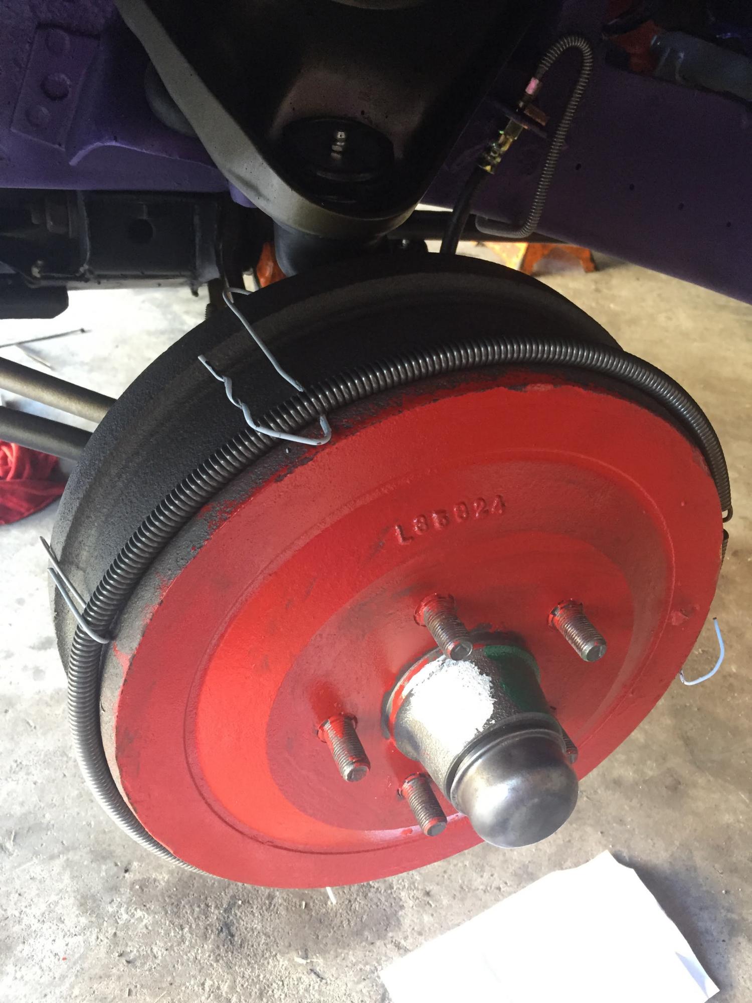

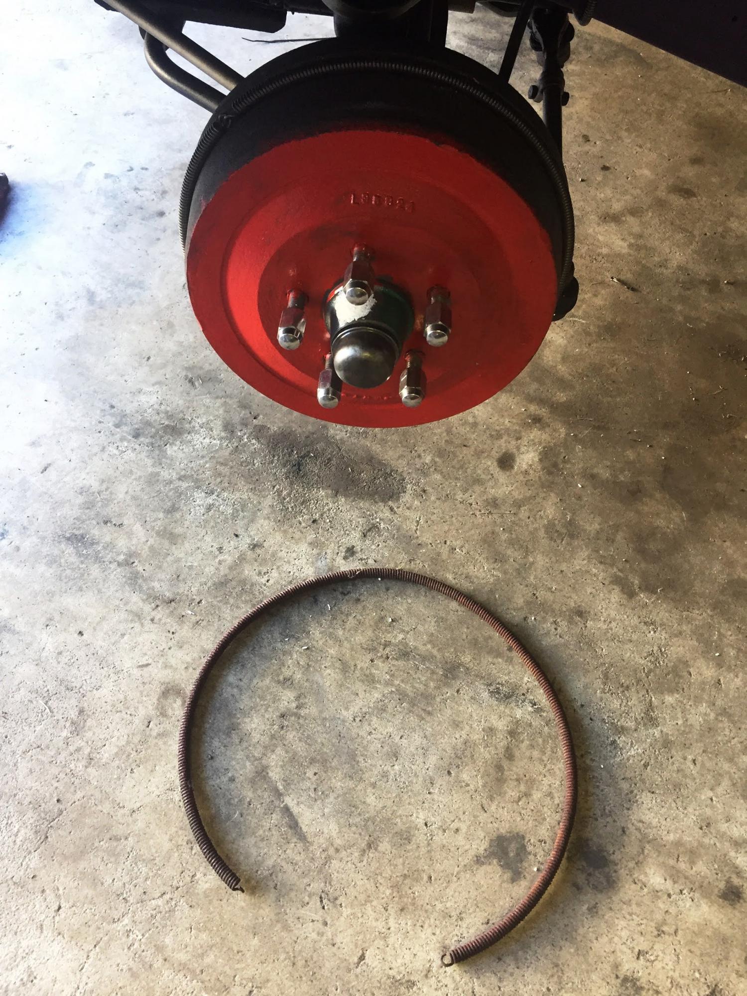

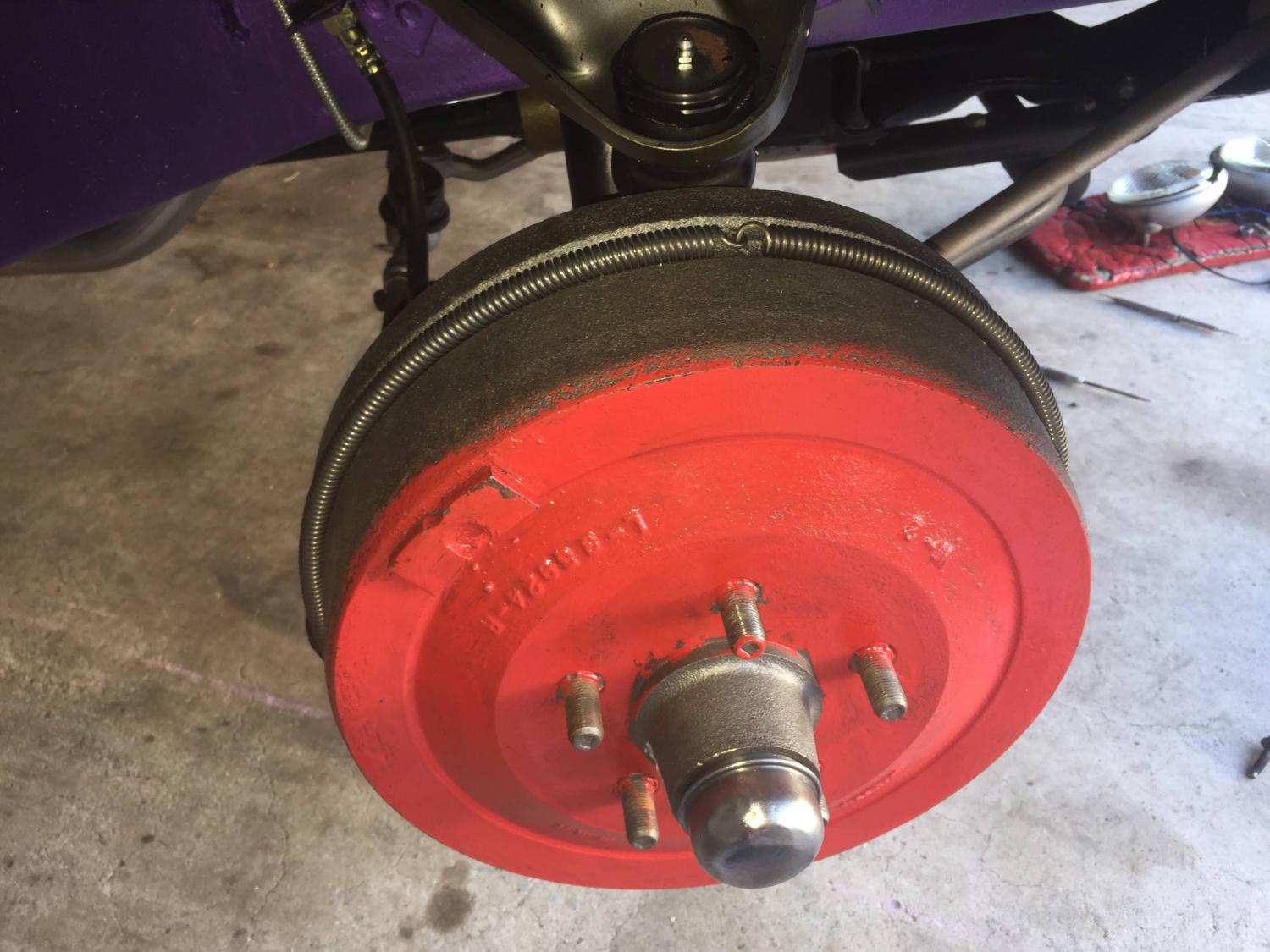

So I installed the dampener springs on the front 11" drums. That was exciting. The new springs are about 4 inches shorter than the stretched out, rusted originals, which no longer have any tension. The directions said to cut up a coat hanger into "S" hooks and use them to hold the opposite sides of the springs while you roll them onto the drums. That takes a whole lot of patience, agility, and skill. Those three items are currently on backorder here in Joysey. It took five tries per wheel, with that high tension spring flinging around the garage at crotch level at Mach 2. I have agility now! Here's a shot of the S hooks for the half second the stretched spring stayed in place when I took the picture. It the rolled off and snapped back to its original size. Smarter idea was to take the next photo after it was fully seated. And the original, rusted "formerly known as a spring" on the floor below it. The 50 year old originals were so tired they fell off the drums and when I tried to straighten them, you could hear them cracking apart. Last edited by njsteve; 09-19-2020 at 04:34 PM. |
