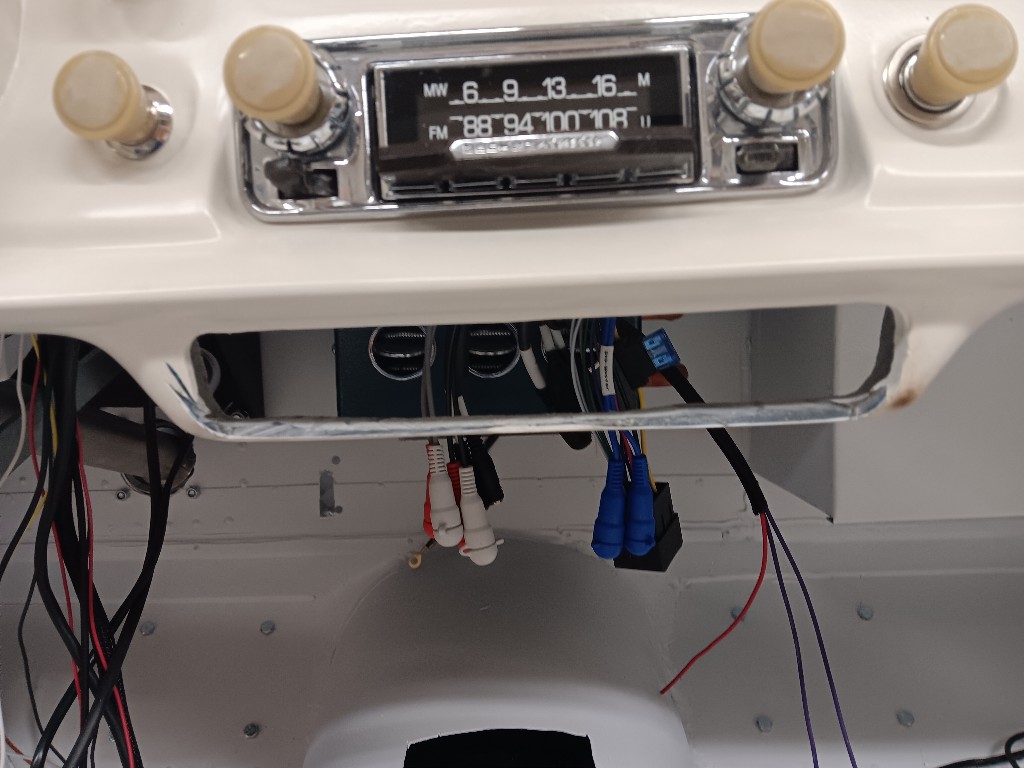

Heater bezel control face is up next. I fabricated the control levers and will show that on the next updated. The face will bolt to the dash and the controls bolt to that. More work to come on this!
