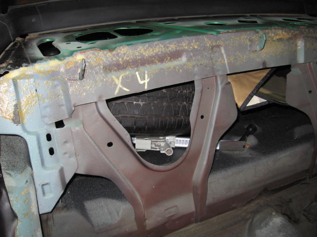

Wow. I have never seen a chalk mark that brite or clear before either. Also, all the ones that I have seen have alot more glue on the brace. Of course, I have only seen 8-10 in person, so my experiance may be limited.
Here is another for your inspection X11 04C NOR
More glue
Mike
Here is an example of an 3B NOR X44.

That's interesting. Where's all that the glue on the survivor car?

There was no exact amount of glue that was used... some have more than others. The car you posted still has the package shelf flap covering alot of the glue...if the flap was pulled up you'd likely find a very similar residue of glue, maybe not "quite" as much, but very similar. I don't see why anyone would assume every car had the exact same amount of glue or the exact same style of hand written X codes. All these things were just hastily and sloppily applied by some line worker in about 2 seconds without concern over who would be scrutinizing their work 35 years later.
