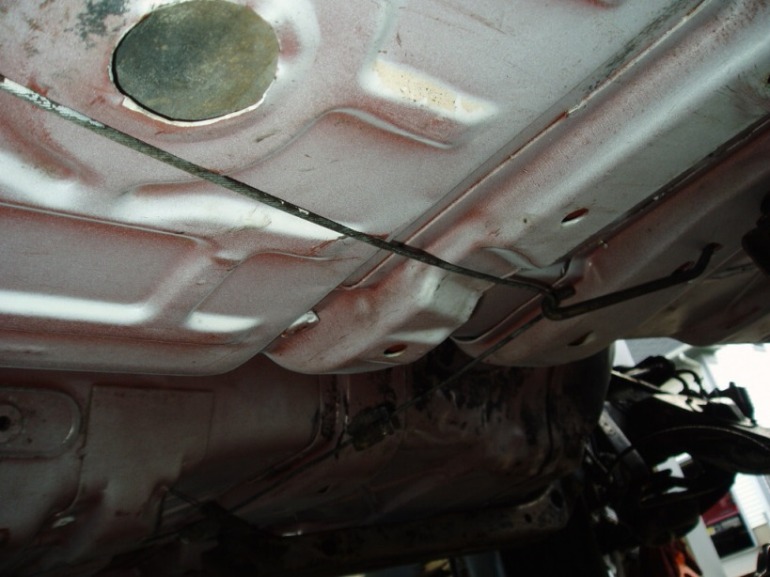

Passenger side, front floor with the overspray visible. The factory white overspray was everywhere underneath this car.

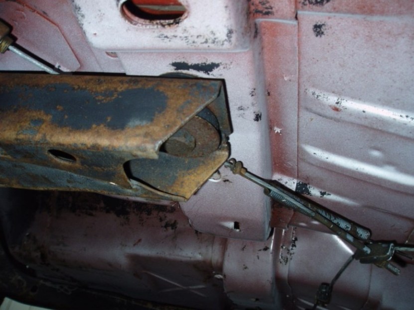

Driver's side floor front area.

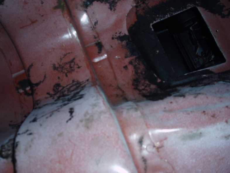

Default Re: Spray Day

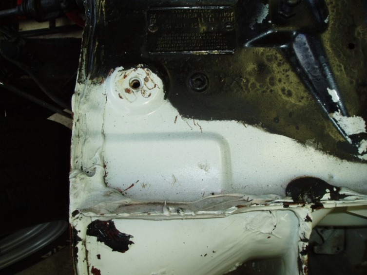

The inside of the tran hump where the shifter goes through. This area had a random coating of the same body shutz (heavy undercoat) that the rear wheel wells had. An interesting note: It appears that the body shutz in the rear wheel wells was applied before paint. The undercoated area is painted white and when a section is peeled away, shows red oxide primer underneath.

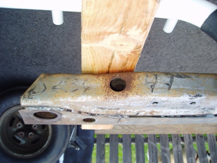

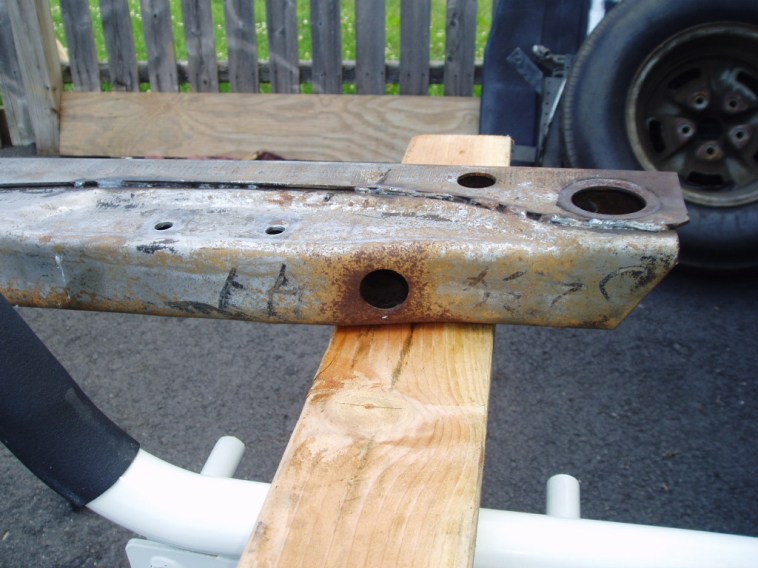

I spent the day powerwashing the frame and then using some paint stripper to get the real yucky stuff off. Look what I found under the paint by the passenger side rear of the subframe. It looks like it was hand-printed with a magic marker "5236 44." Does this correspond to anything?
Here it is upside down so you dont pull a neck muscle looking at it.

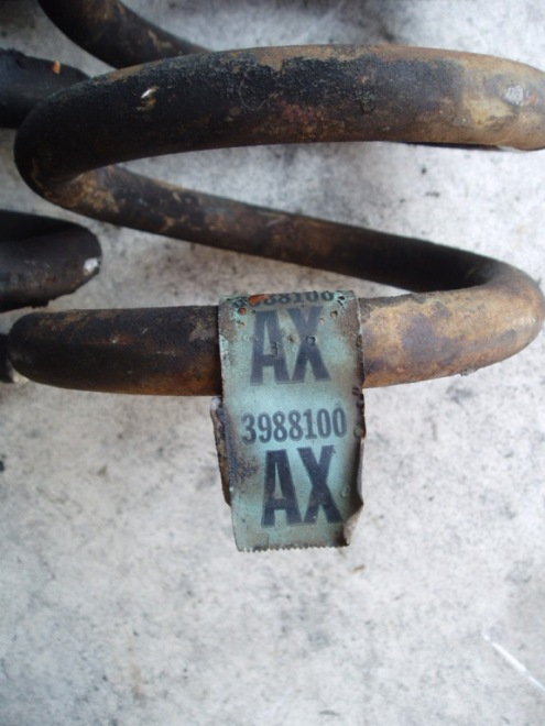

And here is a close up of the front coil spring. As you can see it was painted black originaly and still has the part number tag attached, #3988100 AX. Does anyone know if this tag is reproduced? I couldnt find it on Jim Osborn's site.

Steve:
If you want the original factory order sheet and dealer info. on your car there is only one legitimate source, Pontiac Historic Services.
