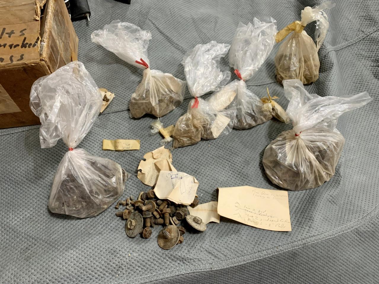

Small updates. Been too cold to get out in the garage for very long here but started on bolts, screws etc of cleaning and preserving.
Process is as follows:
I’ve setup several small plastic containers. First one is citrus degreaser to soak the bolts etc. pull them and clean them with a blue scotchbrite pad and dry off. Then into 1st container of evapo. Sit for 24hrs, pull out clean again using the evapo as the cleaner along with blue scotchbrite pad then into another container of evapo and wait another 24hrs. After that pull out towel dry then use PB Blaster silicone lubricant.
Photo 212 - 213 - Hardware as found. At least it was bagged and tagged back in the late 70’s early 80’s.
Photos 214 - 215 - 1st rd of hardware after cleaning.
Photo 216 - 217 - Sunvisors after cleaning. Forgot to snag a before.

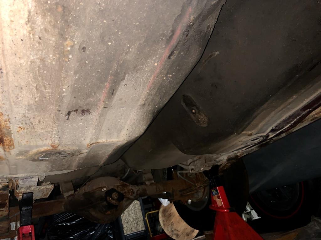

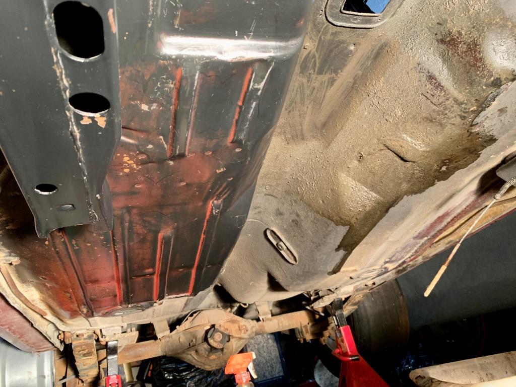

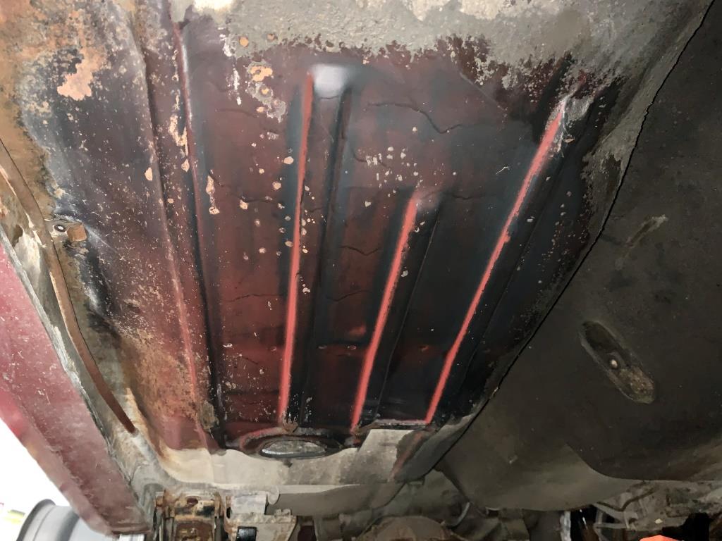

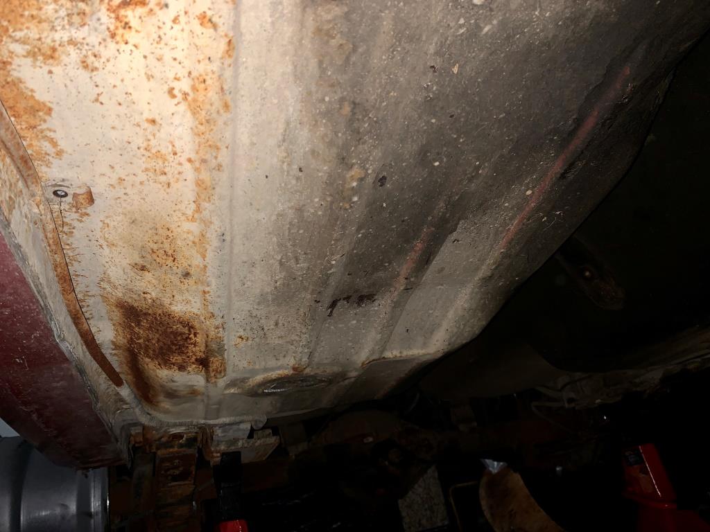

Starting the long and slow process of the undercarriage cleaning. Be prepared to be underwhelmed with photos of dirty and then clean floorpans.
Photo 221 - 222 - Before Cleaning
Photo 223 - 224 - After 3rd Pass
Photo 225 - 228 - After 5th pass across area
As I said this will be a slow moving train down the tracks so I probably wont post much if any until I get the full mid section completed. And yes the plan is to pull the subframe, springs and diff out of the car but that will have to wait until I can pull the front sheetmetal as well.

That looks great. What are you cleaning it with?...Joe
  #68
Old 03-23-2022, 02:13 PM
cook_dw's Avatar
cook_dw cook_dw is offline
Join Date: Oct 2003
Posts: 4,391
Thanks: 674
Thanks, Zep citrus degreaser with a blue Scotchbrite pad and then wiping with cheapy microfiber rags and then hitting it with #7 Meguiars.
