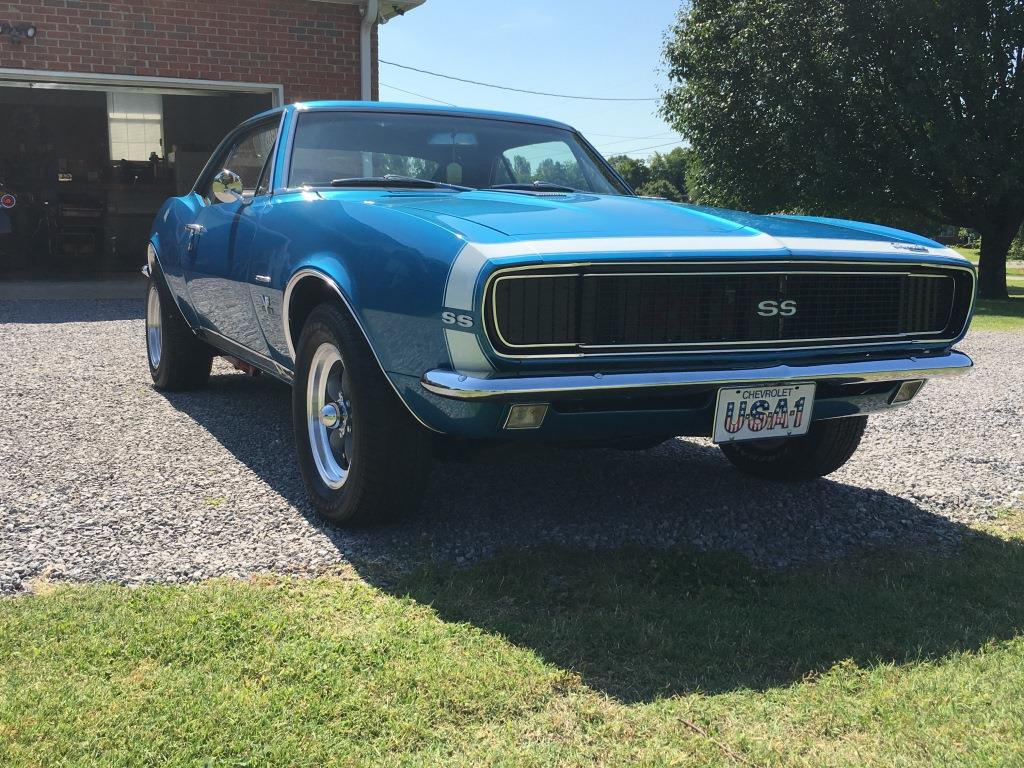

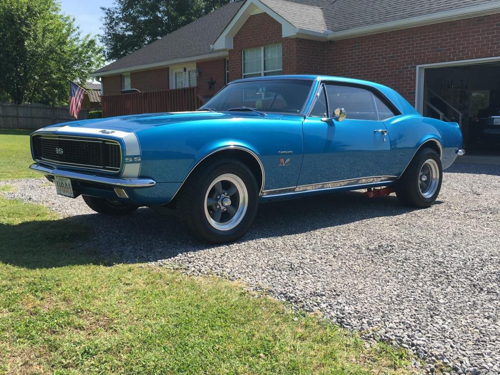

69 can take a tall/wider tire than 7 & 8. Depending on the wheel bs I would go max 7" with 3.75" bs wheel. Here is TT D's 15x6" 3.75" bs with 215 65 15
