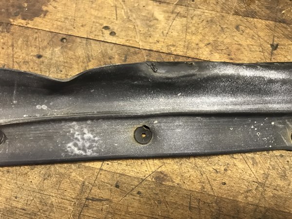

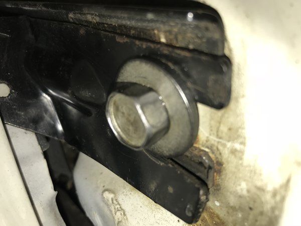

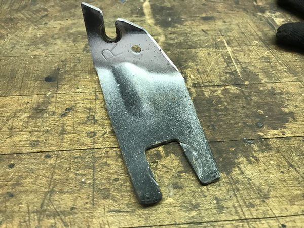

While we had the fender on the passenger side loosened up to remove the antenna it was a good time to fix some cosmetic issues that have badgered us for a while. About 20 years ago Dad had new rust free doors installed (the rest of the car is remarkably rust free). When the shop painted them they got some overspray on the forward jamb pieces. A little light wire wheel and some mineral spirits made short work of the overspray. Since the passenger side now looked much better we decided to do the driver side as well. Now we are just waiting on the rebuilt antenna to return and hopefully we can enjoy this summer.

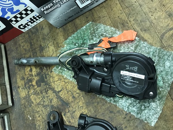

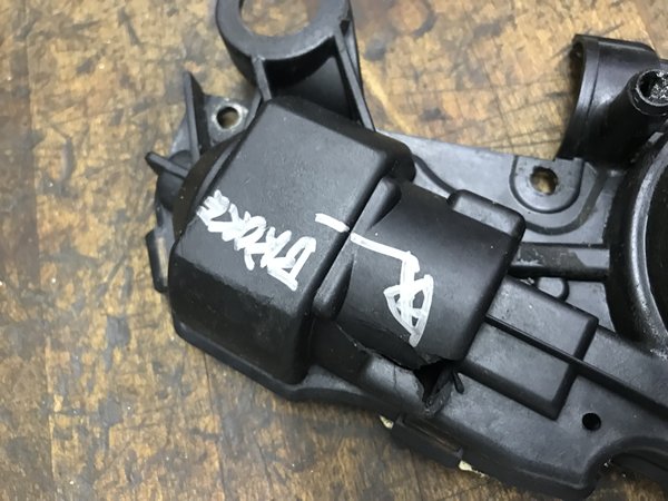

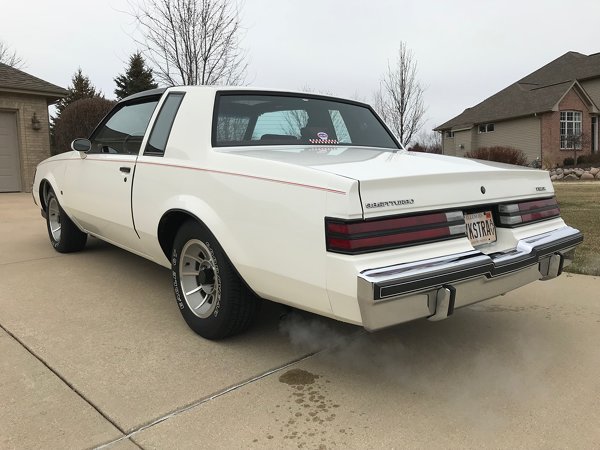

Came home to find the antennae delivered back on Saturday (less than one week turnaround time). Evidently the plastic case was cracked (must have broken in shipment) as they replaced that for no charge.
So our Easter project was to get it installed.
Jake Dykstra
Dykstra Motorsports

After we installed the antenna I buffed out the rear quarters and roof/trunk as they had some scratches in the original paint. Then power washed the engine and washed the whole car to get the compound off. After it was dry touched up all the paint chips and waxed it. Finished detailing the door jambs and washed the windows inside and out. Ready for the summer.

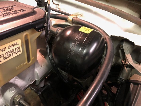

The Turbo Regals used a Powermaster electric/hydraulic brake system that is prone to problems and unique issues. We had been having an issue with the brake light in the dash coming on briefly when the pedal was initially depressed. Not many shops are willing to work on these systems due to their uniqueness and lack of replacement parts.
After some diagnosis with the help of online forum information we determined it was likely the accumulator that was the issue. Dennis Kirban sells an accurate reproduction of the factory installed accumulator units. The one that was on the car was an over the counter replacement from back in the day.
Replacement is simple, just de-pressurize the system by depressing the brake pedal 10 times with the key off, and then simply unscrew the old one and screw on the new one. We also replaced the brake fluid as advised. *****EDIT 8/13 - test drove and brakes are way better, what a difference, son has been driving it 40 miles each way to work. *****

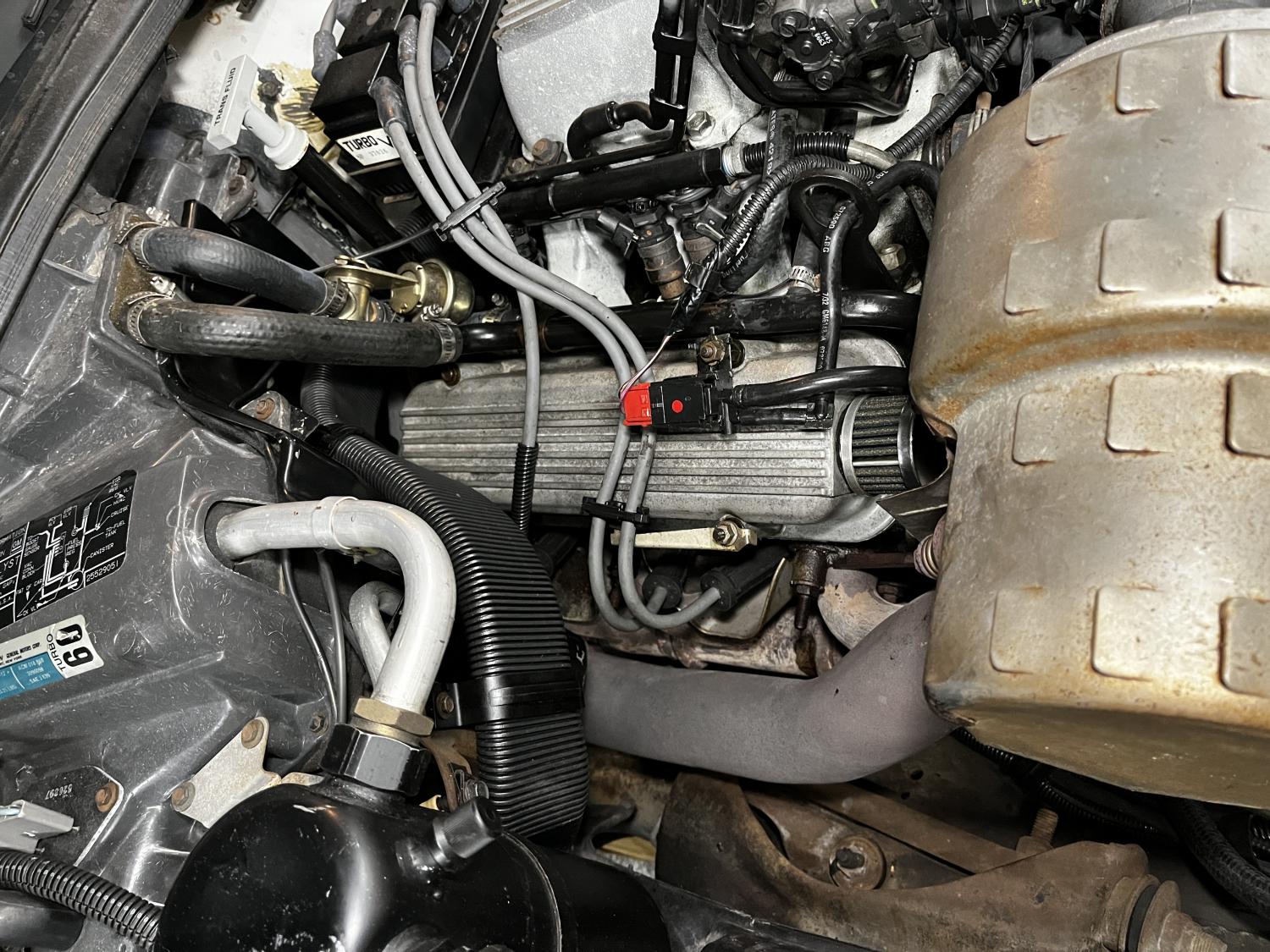

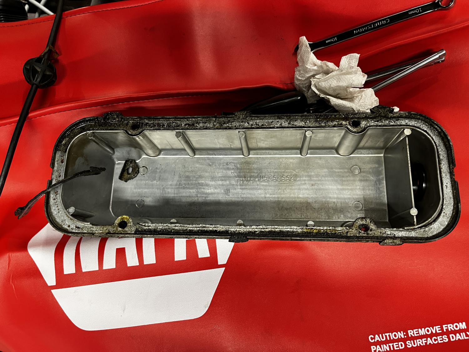

Winter project time here as the snow has started to fall already.....The valve cover gaskets have needed replacement on the Regal for some time now. Tackled the passenger side last night as it was leaking the worst and I assume the most difficult side. I don't think Dad ever had the valve covers off this car in over 130k miles - silver cork gaskets still. Bit of a challenge to get everything disconnected and get the valve cover off with the A/C box so close but after about 90 minutes everything was complete. Amazingly clean inside given the age and miles - a testament to regular oil changes and Mobil 1. I'll tackle the other side soon and get a correct breather installed too.
