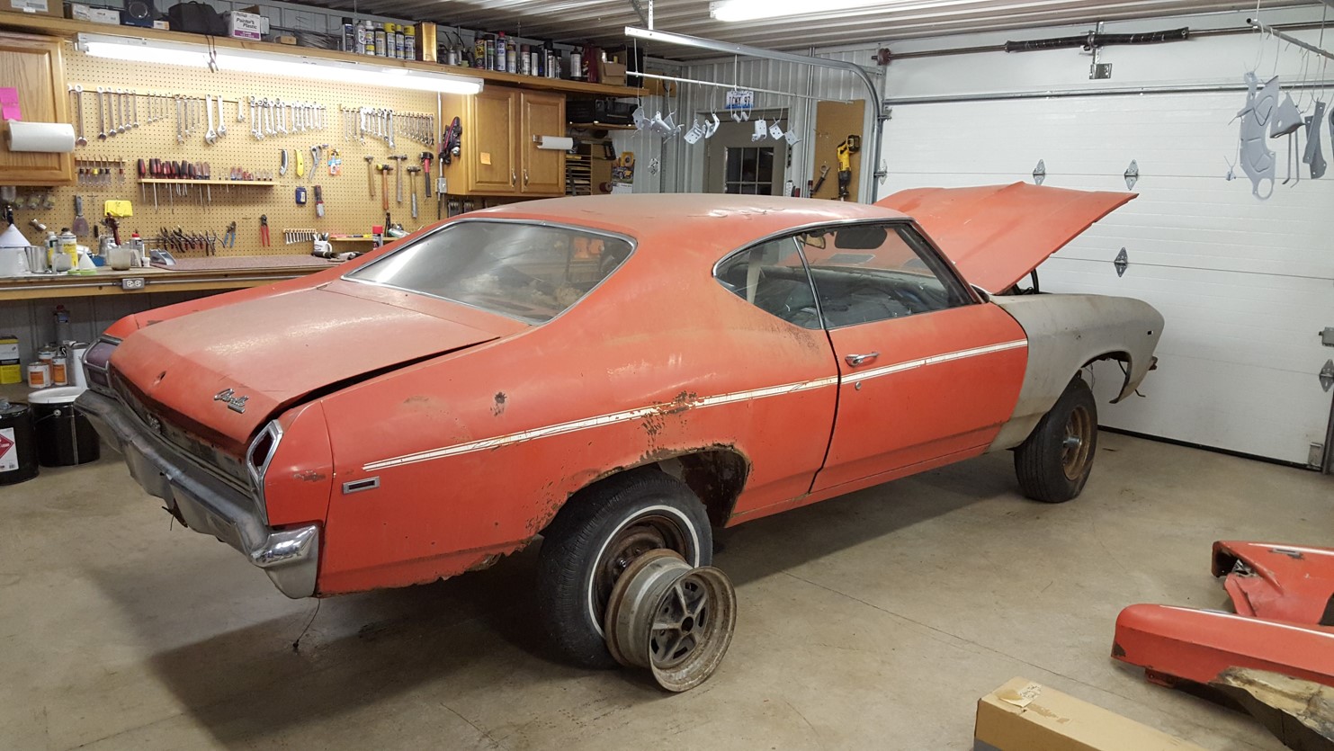

Chevyman0429,
I was wanting to understand, did the car originally come with wheel well moldings like other SS cars or because it was a 300 deluxe did they drop those? Maybe PostSedan has the information on this? I only ask as I have a hugger orange 300 deluxe SS and have been back and forth with my dad on wether I should pick up an OEM set or not.

Mine has the holes for the molding but no molding wether it was there when new I do not know! I believe it was and option! U have a 300 deluxe hardtop in Monaco orange?

Default Hugger Orange 300 Deluxe Hardtop
I do. Mine also had the holes but my car was wrecked and repainted and I was suspect that any previous owner could have added them. This car was talked about on the website here years ago. I managed to come across it and pick it up for cheap. It looks rough, but is actually very solid in the floors and trunk. It will take some work but will be a top end show car when im finished.

All SS396, Z25 equipped chevelles in '69 received the wheel well moldings no matter if they were 13427, 13437, 13637, 13667, or 13680 models. Chevy pierced the upper 5 holes in the fenders and quarters, but drilled the rest of the holes when the moldings were required. When I say drilled, they were drilled with the self tapping screws for the moldings. So the moldings were located with the upper 5, then the linesman would self tap the rest following the molding. Also, the oem moldings have the upper center hole as just that, a hole. The rest are slotted. The repops are all slotted, including the upper center.
