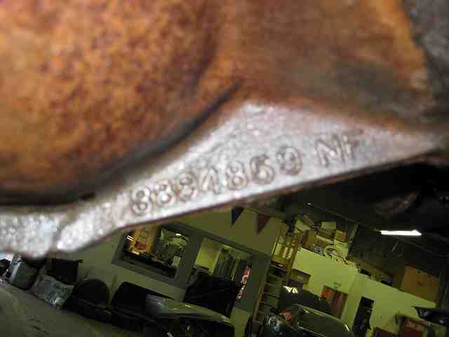

Rear axle casting number #3894859NF GM 10 bolt casting date is D 2 9...April 2nd, 1969.

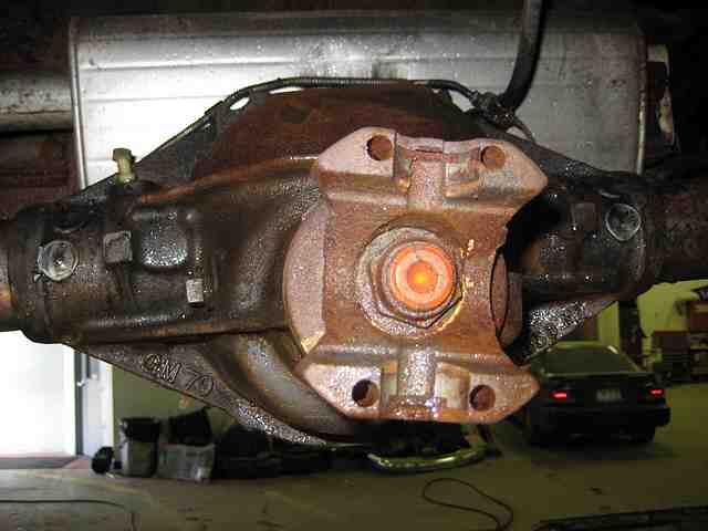

Inspection mark (orange) on the pinion nut...

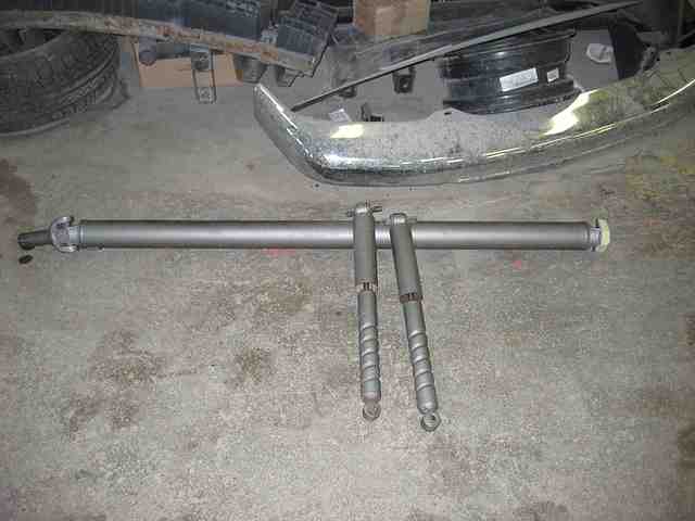

We spent a little time cleaning the driveshaft and rear shocks...quick paint job and they were ready to re-istall. I didn't find any paint marks on the driveshaft...but it did have a lot of undercoating

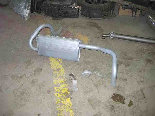

We also removed the exhaust system, cleaned it and painted with some Eastwood exhaust paint I had kicking around..

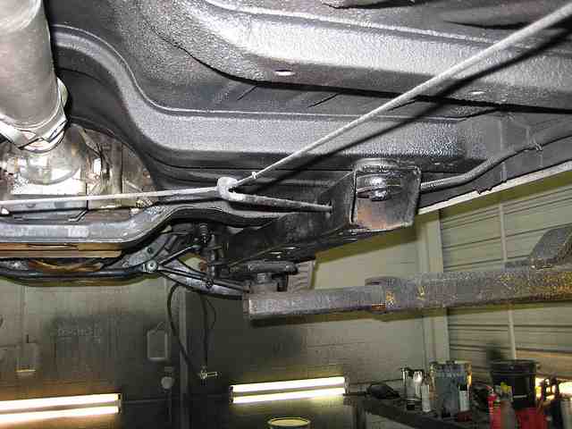

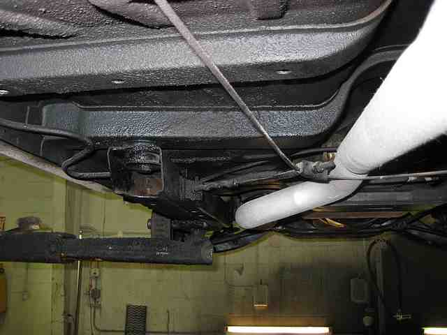

Default Re: Winter Granny Project..

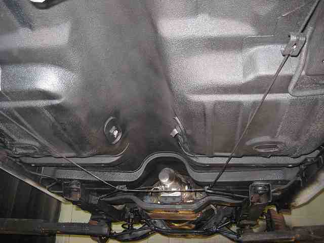

Here are some "after" shots...since this car had HD undercating from the selling dealer we decided to just e-spray some where needed and finish with a nice coat of chassis black paint. It's not a concours job but, it certainly makes the underside look clean and neat. I will probably do a little more detailing to touch up any little things we missed.
another...
one more..the work lites give a reddish glow in the photos..??

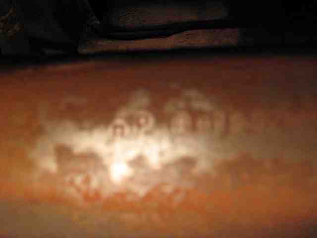

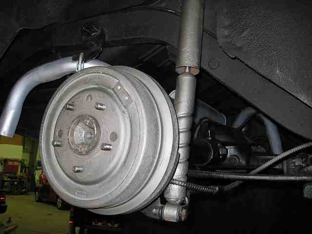

RR brake drum...there was a sticker on the drum with BP letters in red...obviously to signify the axle code. Never saw this before...
