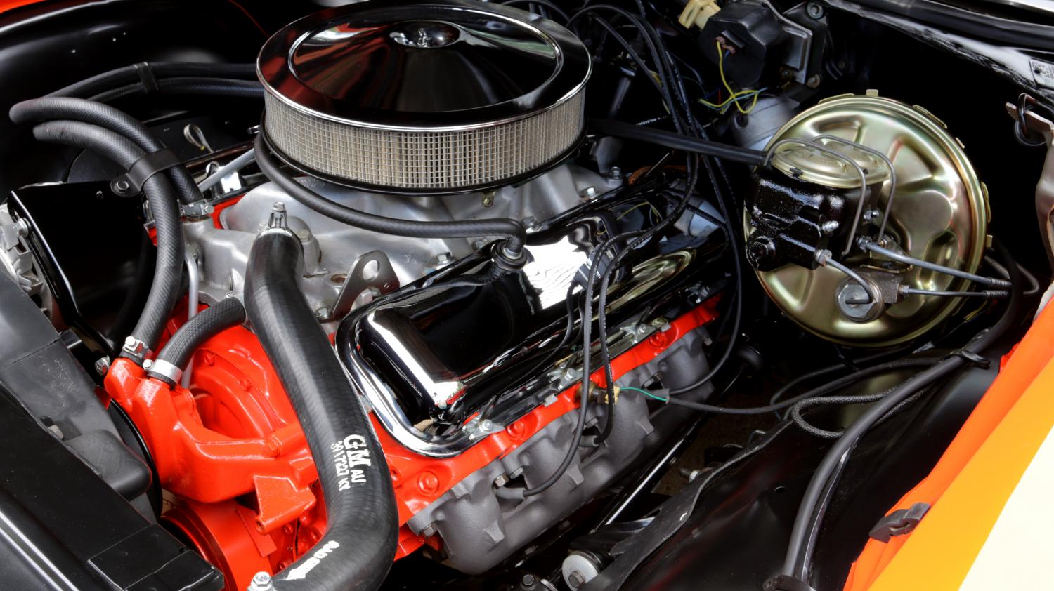

Your Master Cylinder should be black and your exhaust manifold bolts should NOT be ALL Flange Bolts.....just saying.
Hey Dan:
Good eye - Thanks for the heads up
If memory serves, my OEM MC was not painted but, I may redo it black or, whomever owns it after me can do it
I hear ya on the ex manifold bolts
Which ones should be non flanged?
Maybe try to find the correct ones.
How many do I need and do you have any extras
I should try to locate a set of “AIR” ex manifolds and plug them (Harrell’s shop removed the smog stuff and plugged them) but for now, most likely just stick with the “NA”’s

The Exhaust Manifold bolts....The eight outers are all Flanged.... the remaining inners are Non-Flange and No Washers.
Is your plan to ever put the smog system back on the car?

No plans to change any of the Harrell shop mods.
Any chance you have the non flanged ex man bolts I need
PS: A friend just phoned @ 3PM today - NF manifold bolts on the way

This picture update is for Postsedan AND anyone else interested in details

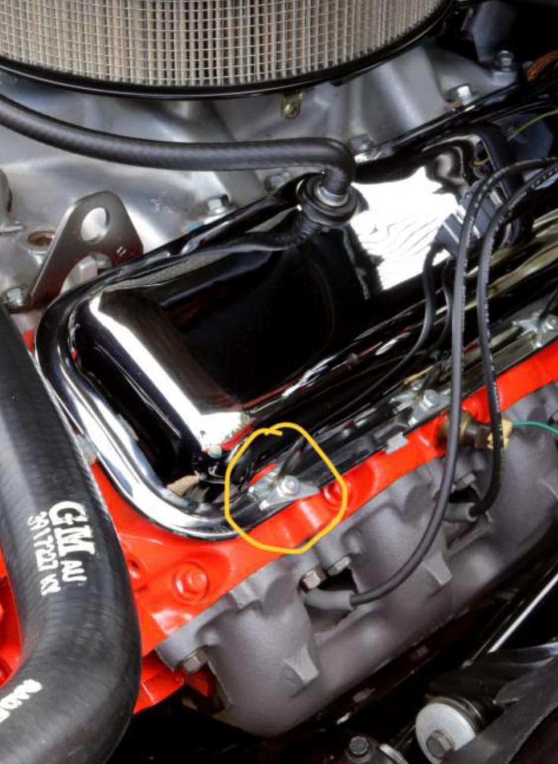

Roger,
Well done Looks Great!
Now just straighten this one valve cover retainer and your all done
