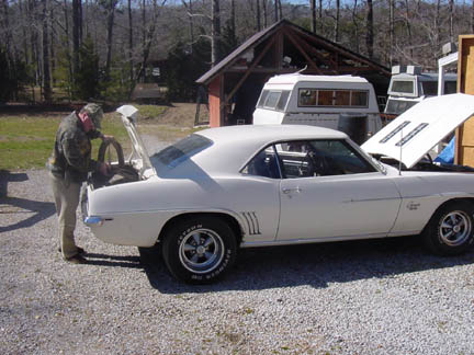

Hey Guys, I just wanted to Thank you guys for all the good info and "insight" on my original question about the possibility of this car being a original COPO camaro. Today, (thursday 5/29/08) Jerry Macneish inspected and Confirmed that we have a "real deal" Copo here! I want to thank Mark B. for spending time on the phone with me and giving me enough good info for us to actually go and bring the car home. This car is a two owner car, that has been kept inside most of its life. ( granted we will need some parts to get it back to original). I guess this go to say "they are still out there". Its kinda funny how every time you hear a story, starting out with .......yea, my buddy knows where a real ....(blank) (car) is........you say to yourself .....yea right.
This is how we found out about this car... with just that kind of lead. THANKS AGAIN GUYS!!!!!! Mike H.

Hi , Dont get me wrong, I may have used the word "confirmed" loosely.
I dont have a single thing (yet) to confirm it to be a 100% copo car, I can only say, that Jerry, said the car was pretty much all factory in having the early series engine mounts, (coded), the 3/8 inch fuel line that has never been touched, correct original radiator ,the cowl hole/harness, riginal leaf springs, original transmission, original breather (flat bottom), and numerious other copo specific items,. I have also contacted the original owner who bought the car new, again, guys, im not the expert, and I know how discussions boards go ...... I dont want to start a big arguement here, just wanted to say thanks to all who has given us the balls to actually buy the car.
(again, as I type this , Jerry has NOT given me anything to "prove its a copo" ...he just left here at 5pm today, However, you must admit, the guy does know his stuff, and everything he saw today indicated it was a copo.

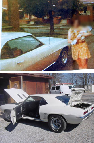

hey what is the date on the picture with the cowl hood on the car?
