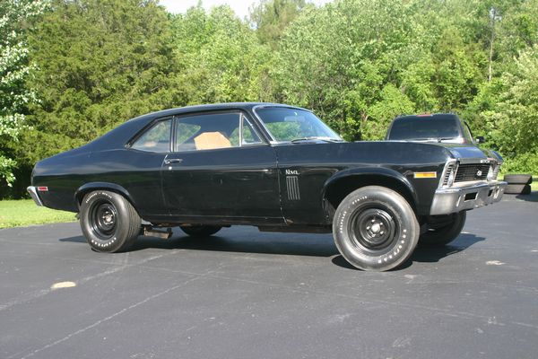

Old 06-14-2006, 08:30 AM
WILMASBOYL78's Avatar
Location: new york
Posts: 8,434
Thanked 2,317 Times in 618 Posts
Default Re: Winter/Spring project..
finally some lousy photos...
