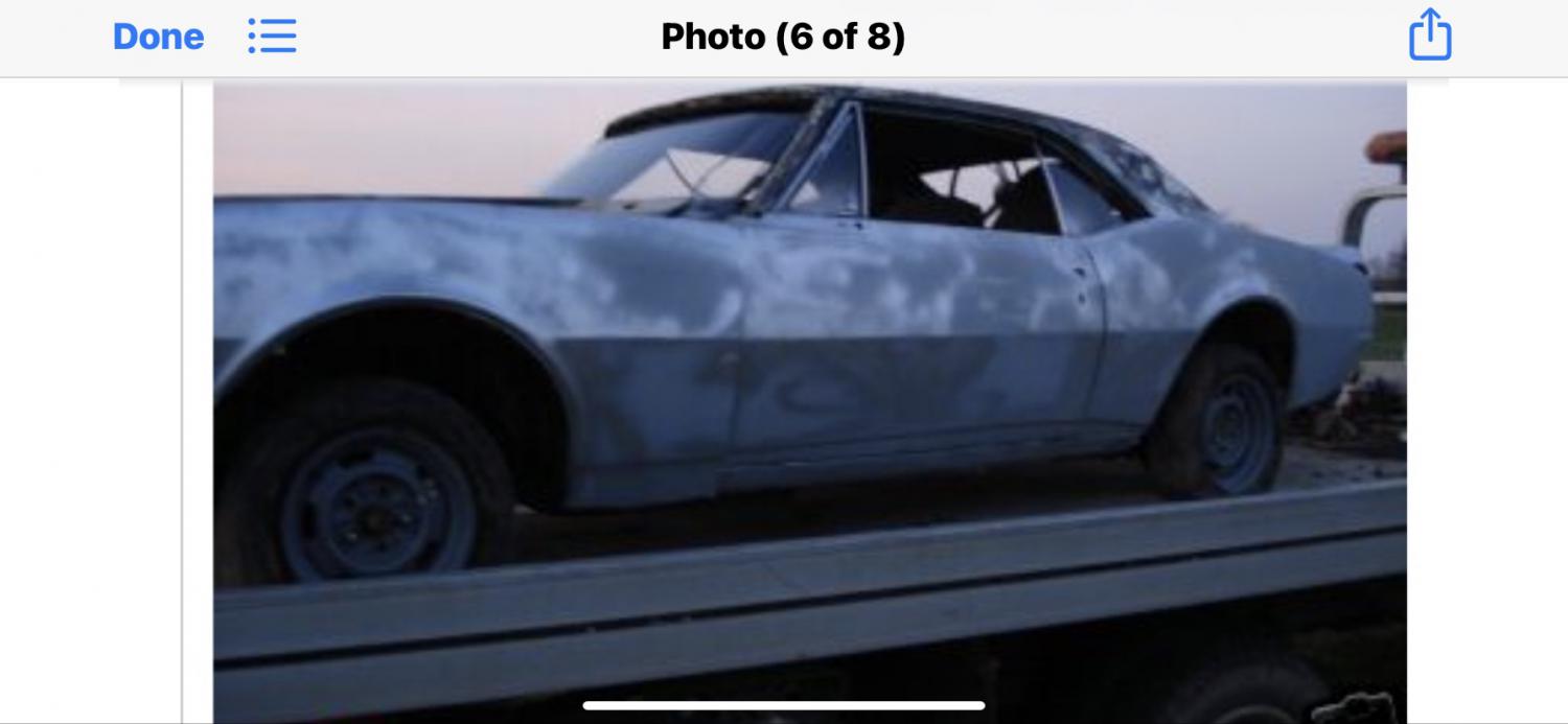

Old 12-05-2020, 12:48 AM
HuggerSS HuggerSS is offline
Join Date: May 2017
Posts: 522
Thanks: 79
Thanked 939 Times in 194 Posts
I was told this was the trim tag and the car when it was initially found in a field.
