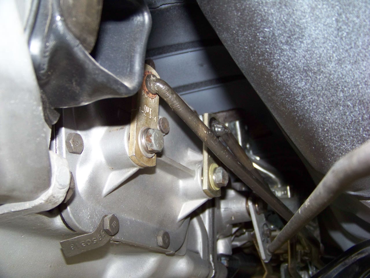

Replated the 1-2 & 3-4 levers yellow dichromate.
Striped the driveshaft -
Installed red plastic plug in the clutch cross shaft.
Removed the binding between the front seat bolts as original cars were.
~JAG~
NCRS#65120
NUMEROUS Lemans blue Camaros,
& a Chevelle or two...

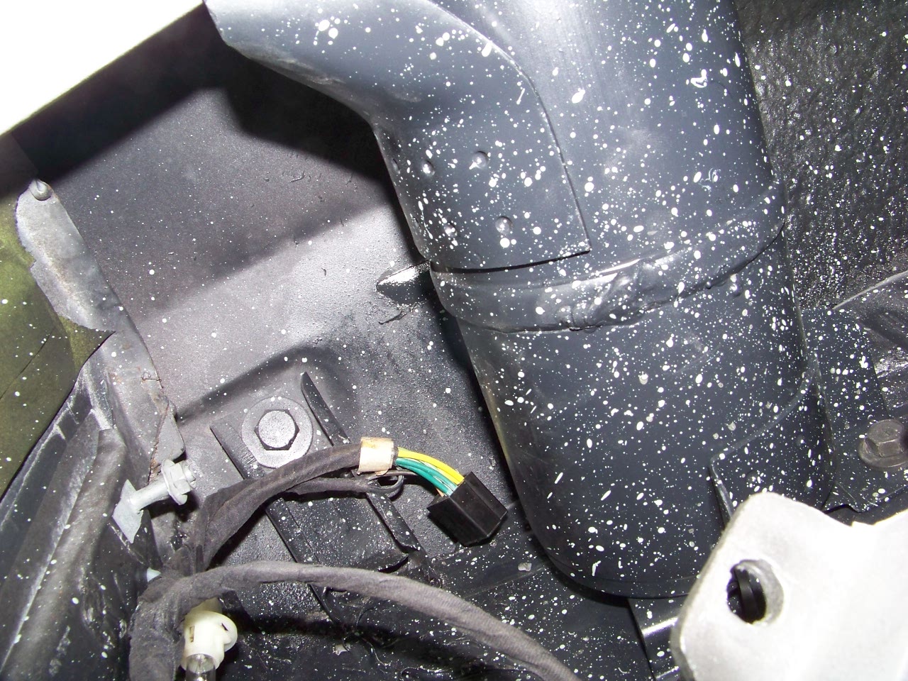

What technic (gun) do you use for the splatter paint on the trunk? It looks amazing. Well done. Also great tip on the tail light housings.
The NOALOX is one of the biggest improvements in ensuring grounds and electrical connections I have found. It's specifically made for bimetallic electrical connections which often develop galvanic corrosion if left exposed.
Most of our muscle car connections are brass on brass however there are a number which are brass on steel or brass on zinc.
The Spatter paint is a mix I make using a not quite black Enamel with Catalyst and a waterbased aqua pickling tint from MINWAX.
I spray it using a pressure fed gun which mixes two products internally and has separate controls for the volume of each. I believe it was originally for Gelcoat or similar viscous liquid.
~JAG~
NCRS#65120
