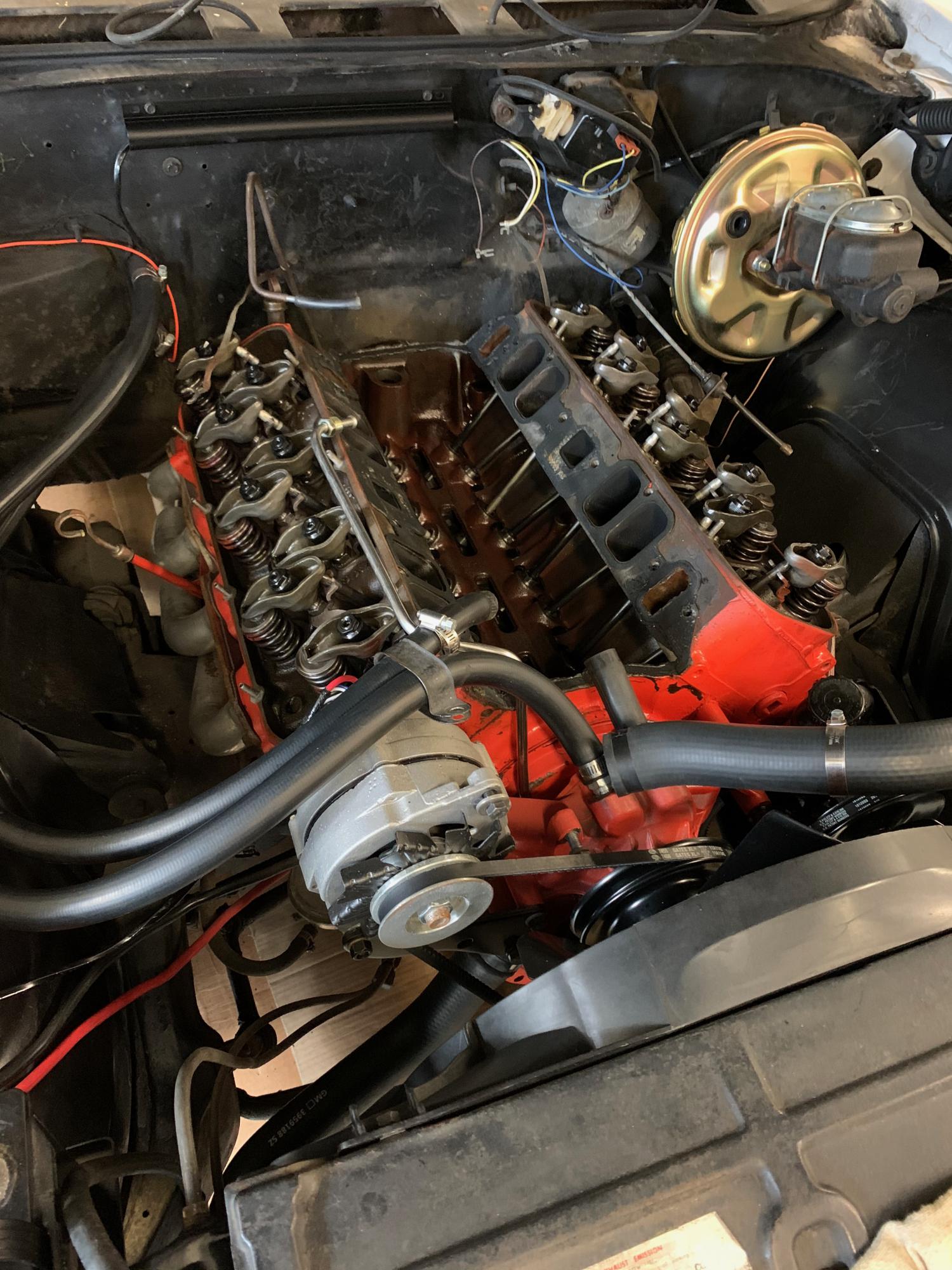

Maybe one of you have had experience with something like this. What would happen if a car with resistor wiring also had a coil with an internal resistor?
Still trying to figure out why car has no power.
I'm also looking at the cam as a possible problem too. I've set the valve lash a few times and the 'clicking' always comes back. I had blamed it on the crimp style adjusting nuts but last time I put on poly-locks.
Been busy on other projects so haven't been working on this as much lately

Well, I did adjust the valves and then take the car out to see if it was any better ... and it was only a little better
But when I got back home (5 miles top) there was those clicking lifters again
Cam will just have to come out

I think the cam and lifters are just gone - maybe never broke-in right

My 72 y/o back is bothering me so I might be a little slower now - for a while - getting to some of this.
But I am hoping to start getting the fluids out of the engine so I can start taking things apart before to long.
