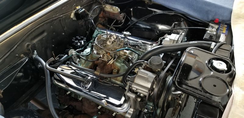

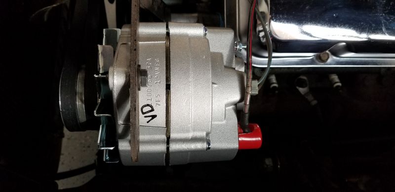

Just about ready to fire it up. I just got my restored and correct "768" stamp number/dated alternator from Ken Bruno installed. Primed the engine again yesterday while checking oil pressure with a manual gauge, got an instant and consistent reading of 62 lbs each time. Got the distributor dropped in and then pulled the plugs to blow out the Marvel Mystery oil that has been in there for months. The engine turned over smoothly with no odd noises. After testing the original spark plug wires, I decided to buy a new set of repro's. Half were within spec, half were not and the one #7 wire that had been replaced was dead. New ones should be here next week. Also got the new vacuum hoses ran today. Anyway, hope to have it running next weekend if all goes well!

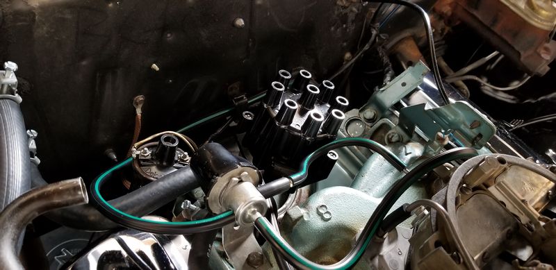

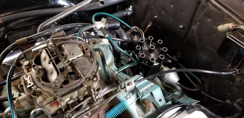

----Grant,,,I don't recognize the contraption on the right rear of the intake with all the green stripe vacume (sp) lines going to it. Is that California only, and what does it do?......Bill S
Bill... that's correct, the '67 CA cars with manual trans and A.I.R. were the first to use this valve together with a dual port vacuum advance that both advances and retards timing. It was also used on '68s and some '69 applications. Not sure exactly how it functions, but I hope it all works!
