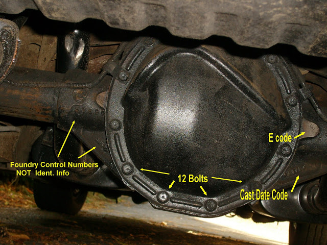

I crawled under this old beast yesterday to get the dated code off the center section to try and verify if the rear is possibly original to this car! Well I don’t believe it has a date cast into the back passenger side of the center section. The axle tube reads Kf. 0529 F
E
So that stamped date I think reads may 29 correct ? Would the date that’s usually cast into the center be some place else? My other Fremont built chevelle has it cast in the center section.

Thats the rear axle tube stamping. Rear was built May 29th.
KF = 3.55:1 ~ 12-bolt Positraction, large ring gear (L35/396, L34/396, & L78/396)*
The pumpkin will have a casting date code on it.

Chevelles 12bolt casting dates are in a different place.
