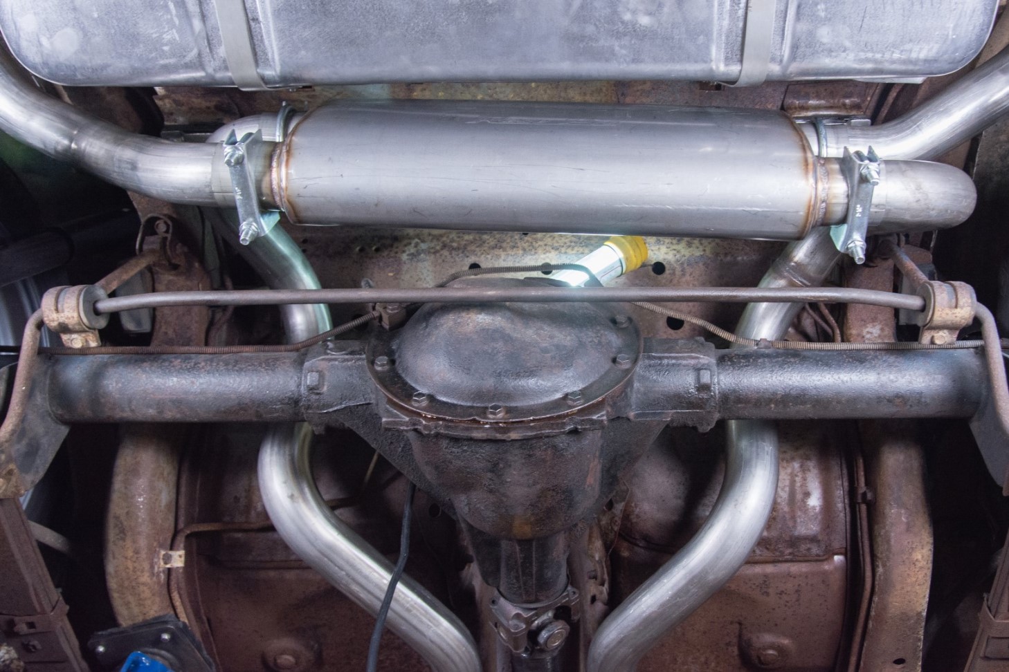

I will take a look at the archive. Pypes themselves did the install in PA. They employed a hanger bracket that uses the factory slip-in rubber bushing at the top, near the gas tank hangers.
  #565
Old 02-18-2020, 11:45 PM
njsteve's Avatar
njsteve njsteve is offline
Join Date: Nov 2003
Location: NJUSA
Posts: 8,502
Thanks: 9
Thanked 3,032 Times in 928 Posts
You can just barely see the edge of them but they are the u-shaped brackets that slip under the top exhaust clamp and also slide into the bulkhead rubber grommet bracket above the muffler. Pypes sells the brackets. I think they are an extra cost items not included in the kit. (of course)
