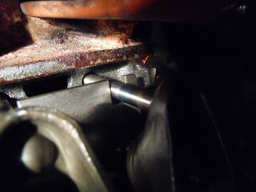

Blue on pushrods

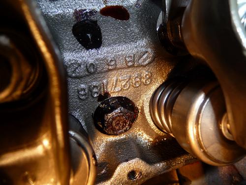

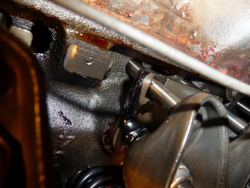

Does John know if they used what looks like #2 Permatex during assembly ? It looks like it on head bolts and screw in studs ? They used guide plates in 70?

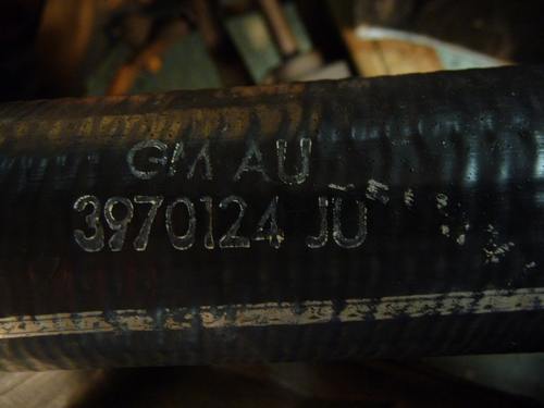

upper radiator hose #'s

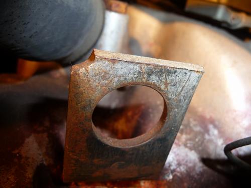

This front bracket almost looks like it has the remains of some grey paint near the top but at the bottom is bare steel.

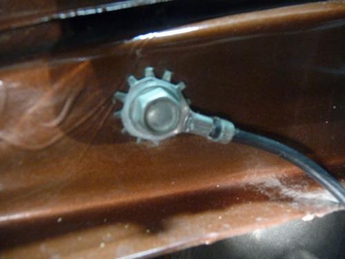

negative bat cable ground wire bolt.

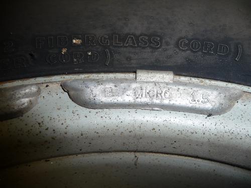

I may be insane but... Is that a remnant of a wax blob...indicating where the weight went?

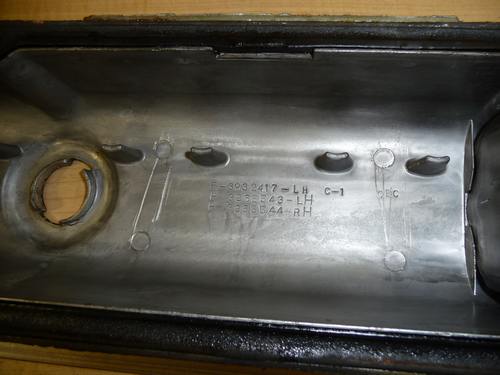

------Charlie,,,Were the four valve-cover bolts exactly the same length???.........Bill S

Actually, grease paint, but yes, that is the mark that was determined to place the wheel weight.
I work in the paint shop at the Ford KC plant as a supplier. A few years back, we had some warranty issues with yellow spot on units. Started to do some backtracking and the grease paint (using yellow titanium dioxide) was being applied too heavy and was flinging off the wheels as it was going thought its 'road test'. The paint, although cured, was still fresh and getting stained. We saw staining from storage additives from gasoline too.
