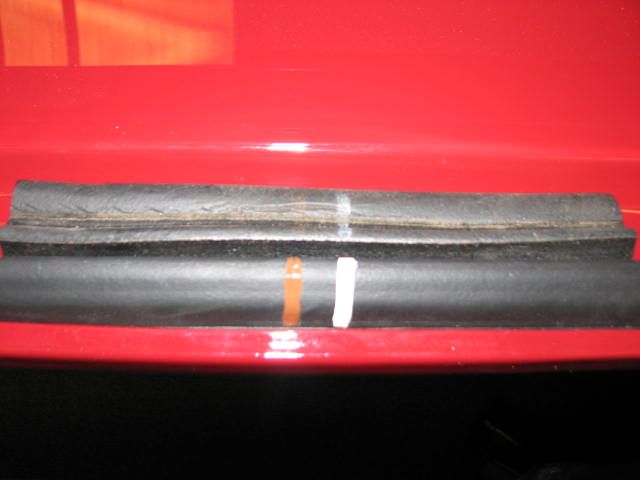

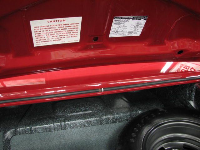

Using a section of the original assembly line trunk weatherstrip I replicated the inspection striping on the replacement weatherstrip. About 99% of the time I find these stripes about 4-6" right of center on the 70 Chevelles. This car was almost dead center so possibly different and normal on the 69's. Where the two ends meet at the base of the trunk opening is similar to the 70 Chevelle and approximately 6.5" left of center.

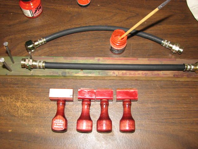

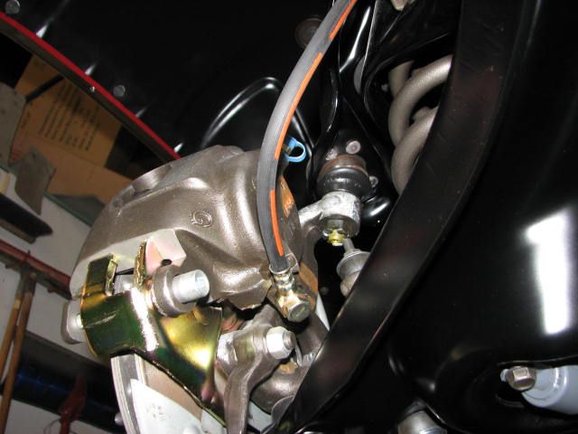

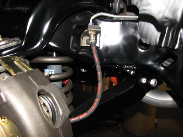

My attempts to locate NOS front hoses failed so I decided to go with reproductions for now and restamp them until I can locate originals. These were stamped with the orange colored as opposed to the rear which was a greenish blue.
