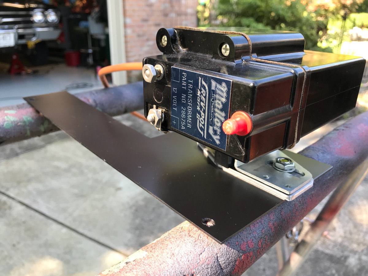

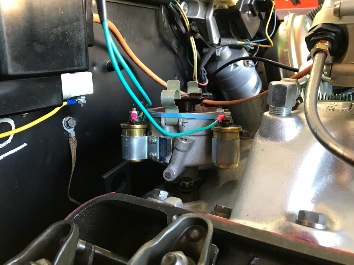

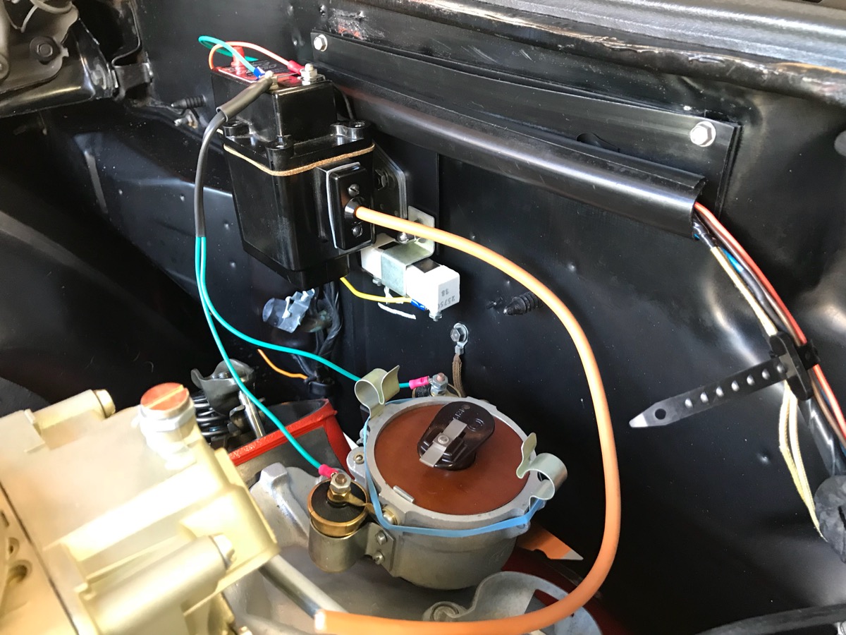

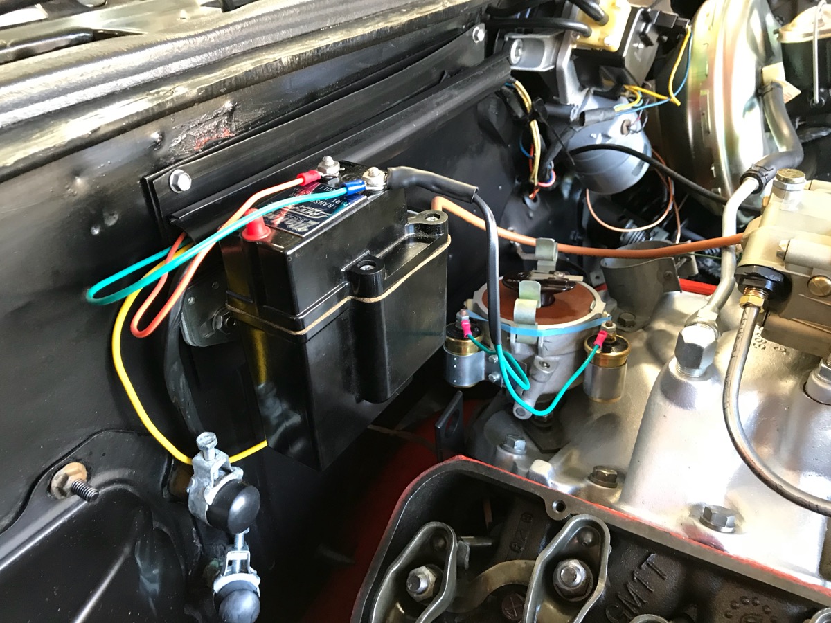

Thanks! I am using a Mallory “Rev-Pol” coil and double life (2 sets of points w/ 4 lobe cam) distributor. This version of the YC-310 HP distro uses 2 of the “trash can” style condensers each with a bit more oomph than the stock single condenser installed by GM. Also, each condenser feeds each set of points independently which for the day may have meant better performance at higher revs (charging time increased for each condenser prior to discharge).

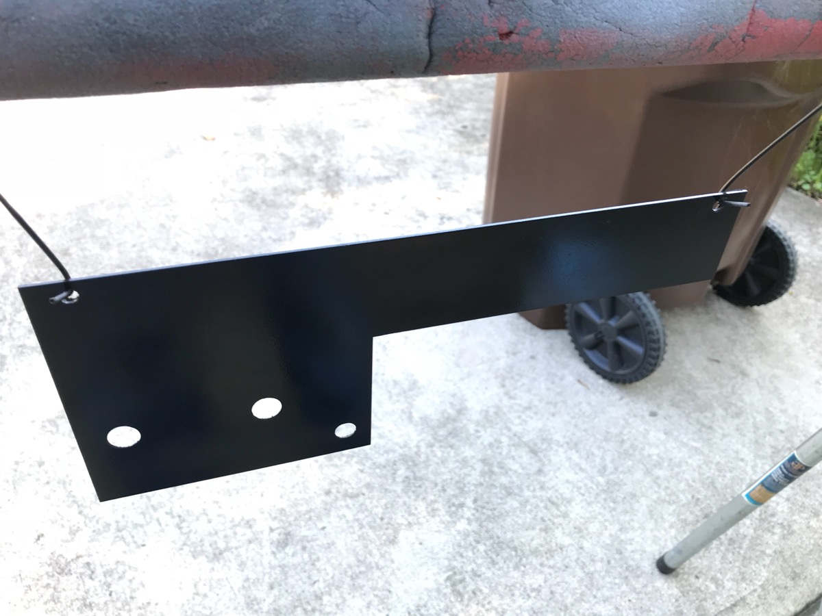

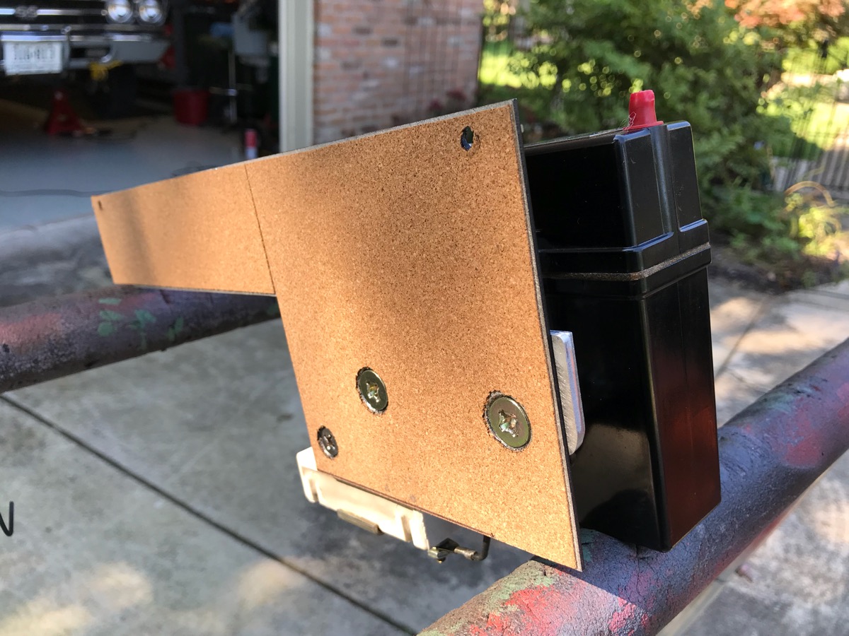

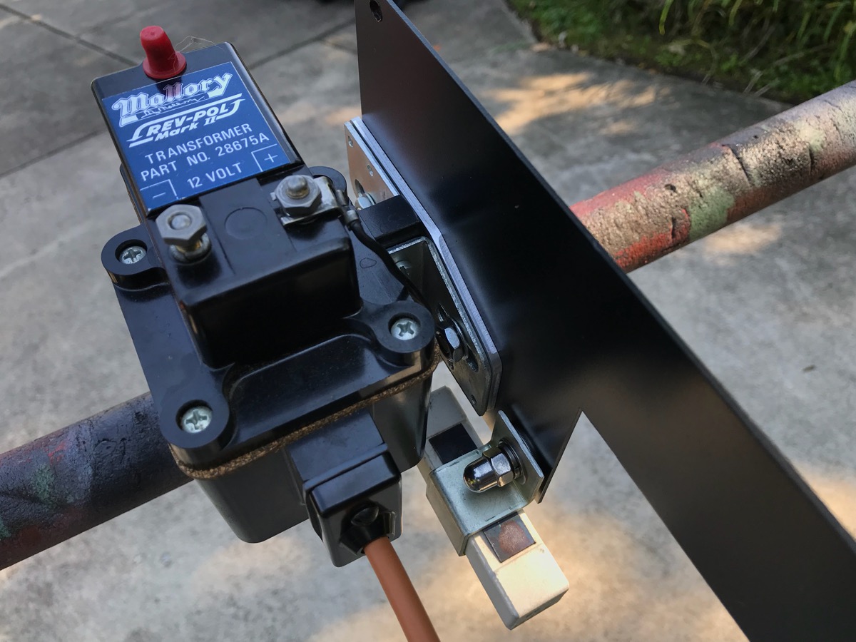

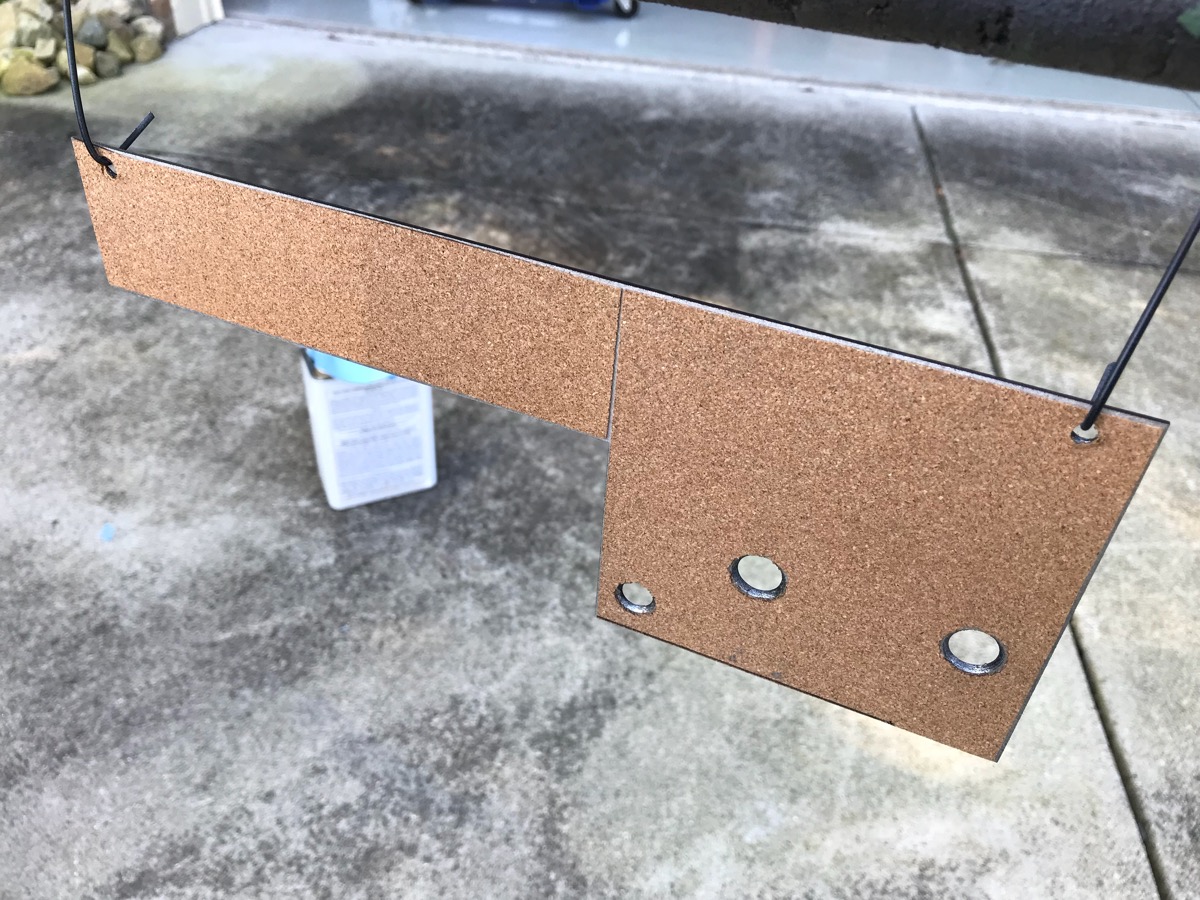

As I did with my ‘70 Nova, I created a detachable mounting plate for the Mallory coil and resistor so as not to alter the firewall by using existing fasteners.
Sam...
