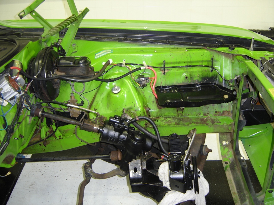

Here is an original paint FJ6 T/A - battery tray and some of the inner fender that got hit with black-out.
The T/A's and AAR's cowl and fender blackout (Organosol was used on them only) was done neater (masked) at the cowl area because of the fender Organosol.

I think I see something in that photo: could it be that the blackout you see around the battery tray area was actually the overspray coming through the small square opening to left of the radiator open area that happened when the front end blackout was done? It lines up perfectly with that square opening.

Some of it - yes. Good detective work!
Check out the lower core support - towards the front. No way was that black sprayed from below.

Interesting, but I think that tray was replaced, no? It’s a uniform color, no overspray around it if it was shot in the car, and there is one body color bolt on the forward portion of the tray. If that tray was blacked out in the car there would definitely be more overspray around it, I’d think. Just throwing that out there. You can see the overspray on the inner fender from the fender black out (top portion crisp, lower portion not so much), so I’d think that if the tray was blacked out inside the car there would be a little a little haze around it everywhere.
Inner portions of that area show overspray undercoating from the wheel well since the cam adjuster covers were not installed during that time. The covers when installed, squished the undercoating remnants that were sprayed around it sloppily. It was like that on my Bee as well. These clues are fun stuff!!

Yes, the tray was removed, repaired (battery acid pitting) and re-installed. But it originally showed a bunch of blackout.
Somewhere I have a few pics of some of my past cars and pics I got from Roger Gibson and Frank Badalson over the years, showing some original blacked-out battery trays. It was not always done. I'll try and dig those up, for research reasons

See if they having matching ballistic trajectory patterns from the square entry window in the rad support. It’s the “Magic Overspray Theory”, I tell ya!
