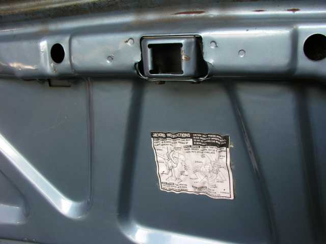

Default Re: Early production 69 Camaro details.
trunk latch is painted.

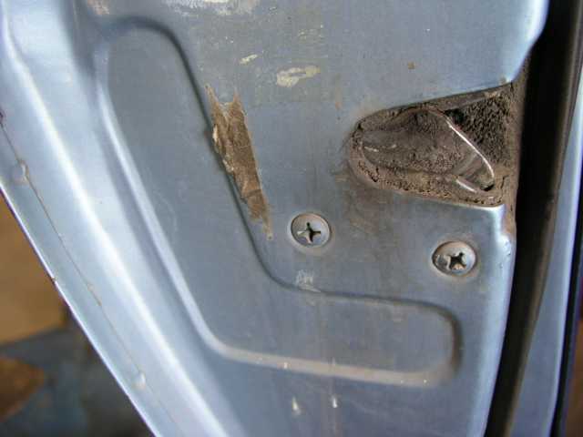

Door latch..screws are painted.

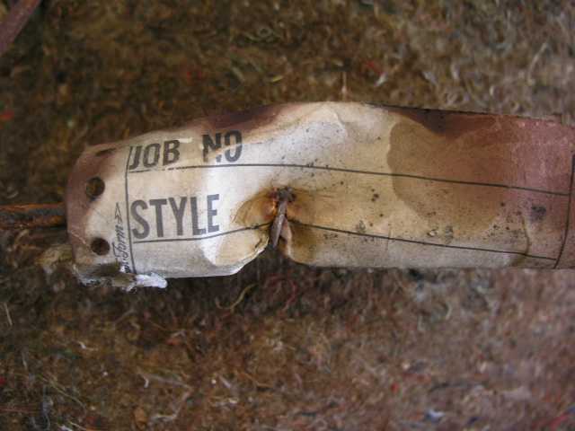

Tag around spring in rear seat bottom.

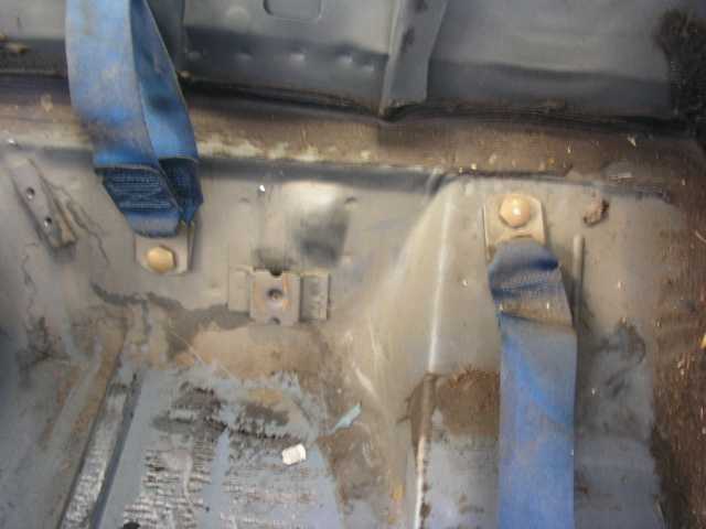

rear seat belts..Inner ones point up while the outer ones point down.

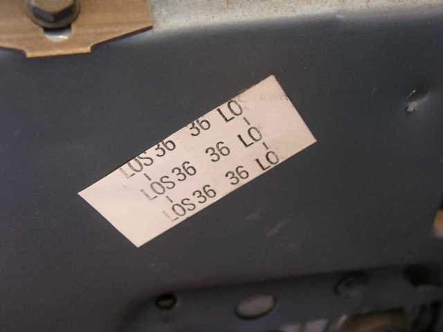

4 tags..under each door panel and 1/4 glass area.

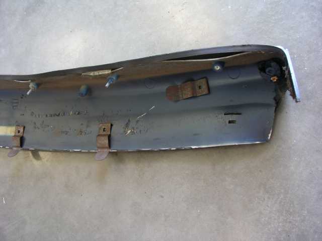

Blue dash pad is sprayed blue.

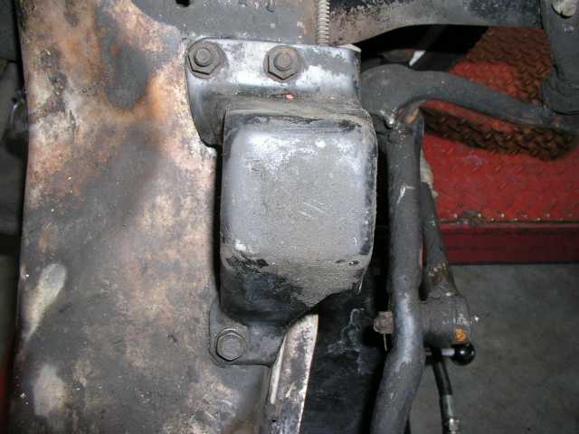

Engine stands...2 bolts point up and one down. Same on each side.

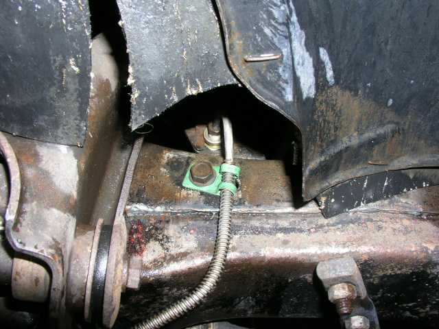

another green brake line clip.
