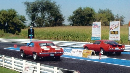

Who wins the race between two stock Z's.....the '69 or '70 version?
Just curious.
This type of race?
Rob
69 <font color="orange">HO</font> Z-28
  #47
Old 08-29-2005, 05:49 PM
Location: Pennsylvania
Posts: 9,913
Thanked 229 Times in 193 Posts
Default Re: Z-28 1/4 Mile Times
The 70 car if all is equal.
