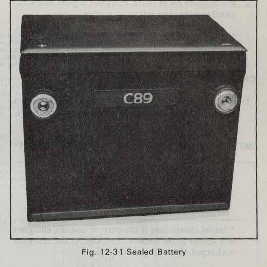

Here is the C-89 sealed, side post battery available in the Lemans and GTO in 1972. Did the Chevelles use it?

In 1972,the R89 was still the Battery used in the Chevelle.
