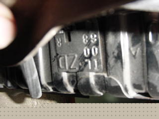

Hi! I cruise thru here from time to time. I am definately interested in this topic. I have a 69 PaceCar with the original drivetrain and this radiator. My car is a 325/396 4-Speed car built with an 02B trim tag, drivetrian is ALL matching #s and seems to all be within 4 weeks on casting dates/run #s(2nd-4th week Dec/68,1st &amp; 2nd week Jan/69). My radiator Tag is a "ZD" tag. Will this help? <font color="blue"> </font color> [img]/ubbthreads/images/icons/grin.gif[/img]

OK, there ya go! After many attempts, here is the Tag pic! [img]/ubbthreads/images/icons/grin.gif[/img]

rpoZ11
Is that a "A" next to the tag in the picture? On the right side of it? Looks like its upside down.
