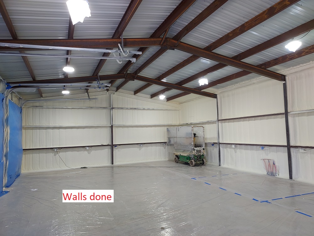

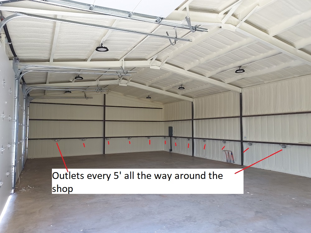

Well, I finished the other 12 or so outlets. Dug another shorter ditch between the 2 buildings. I ran 2" flex in that ditch along with a 1/2" soft copper air line. I can pull power through that flex for my Mini-Split Heat/Air unit. So I can come off the 200amp main panel and save power in the new shop 100amp sub panel.My girlfriend bought me a 48,000btu unit.
https://www.premiumhomesource.com/pr...SABEgIonPD_BwE
So the double compressor mounts out side. Then there will be 2 wall units inside both 24,000btu's each. It says it will work for about 18,000 cubic feet. My shop is probably about 18 or 19,000 cu ft. 30 X 50 X about 12 = 18,000 cu ft. Going to run power from main panel to disconnect box, then into unit. I bought an extra 50' line set. So one wall unit on each side wall. Too much work and money to get the radiant heat going. And it's only heat. This will be heat and air cond.
I am putting the compressor in the small shop. It is insulted with closed cell spray foam. Then 25' or so away in the new shop will be the outlet. That way I don't have to listen to it turning on/running. I might be able to hear it some, but it won't be like having it a few feet away... LOUD.

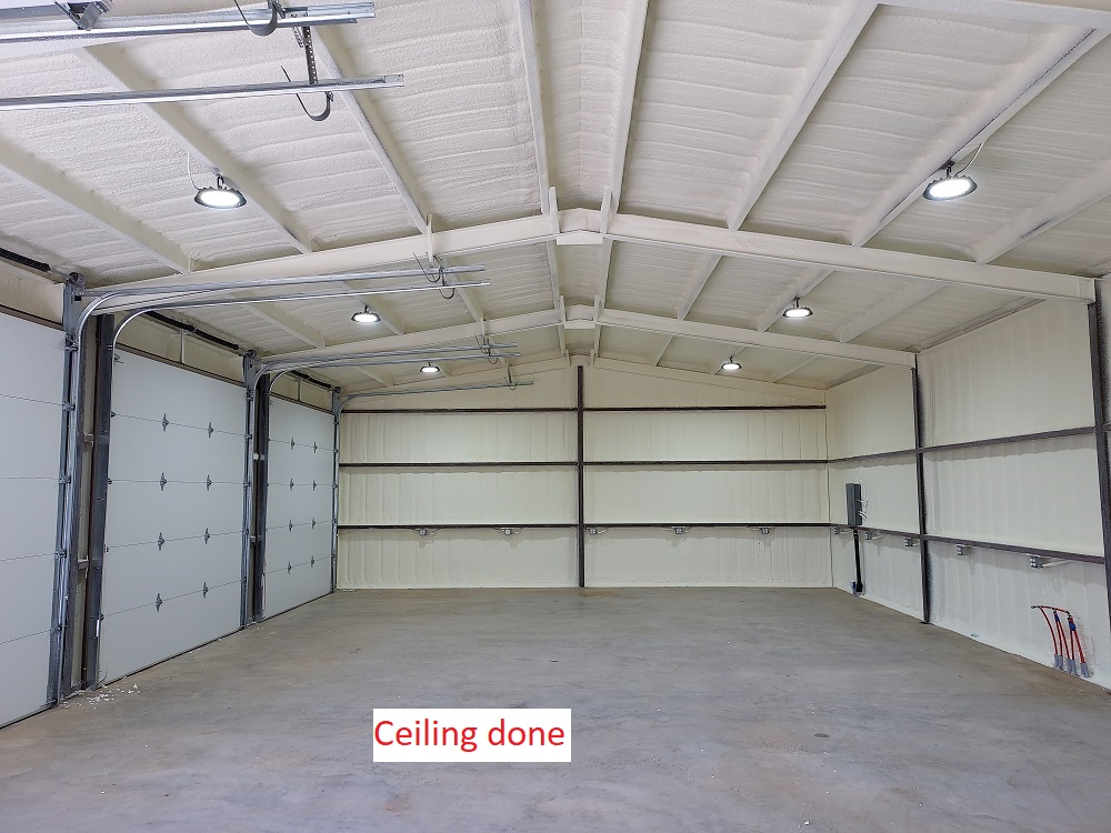

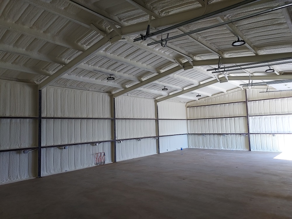

Paid $6,500 for closed cell spray foam insulation in the new shop. 2" on the ceiling and 1-1/2" on the walls. So this should be a big help with temperature control. Getting excited... D

That foam looks great, but where do you live that you can get by with 2" ?? I blew in 24" of fiberglass in my ceiling.

As far as outlets, I HATE not having power where I need it. So now glass beader, grinder, wire wheel, parts cleaner, drill press, welder, buffer, vacuum, etc. etc. No matter where it is placed in the shop, there will be power. Most all things come with a 60" cord. D

Nothing like that spray in foam. You shop looks great. I checked on doing my large 3 garage here in Illinois and it was close to your price so I used batt insulation for about half of that which was still too much but I put in a higher R value than was suggested too. However, I never needed to turn on my A/C on my mini-split as it never got that hot inside and always stayed around 72*. If you don't mind me asking, what is your total investment so far?

I spray foamed my shop at home. Nice and warm. Don't overlook humidity control when planning out your HVAC. I fight it in my shop with the hydronic heat here in the great white north.

Awesome shop! Are you going to put something on the walls (at least in the lower sections) to act as an ignition barrier for the spray foam?
