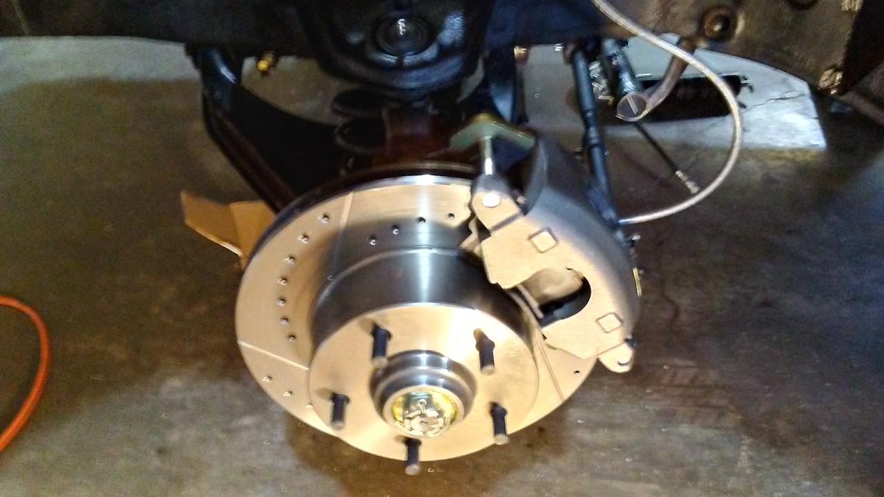

Got the springs in....that was NOT fun....the rest of the front end stuff went smooth...next weekend install rear brake hose, bleed all brake lines, route the 3/8 fuel line from rear to front.

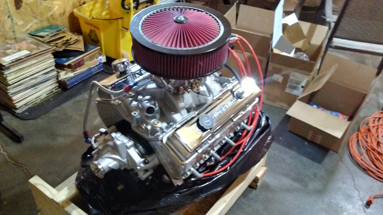

I got this air cleaner from Speedway....it has a velocity base...should flow very good!

Installing front springs without the engine in for weight is a PITA. For that situation, I use a 30" piece of 5/8" all thread to pull the lower arm up to attach the spindle.

Thats what we did, it was a little spooky, glad its done!

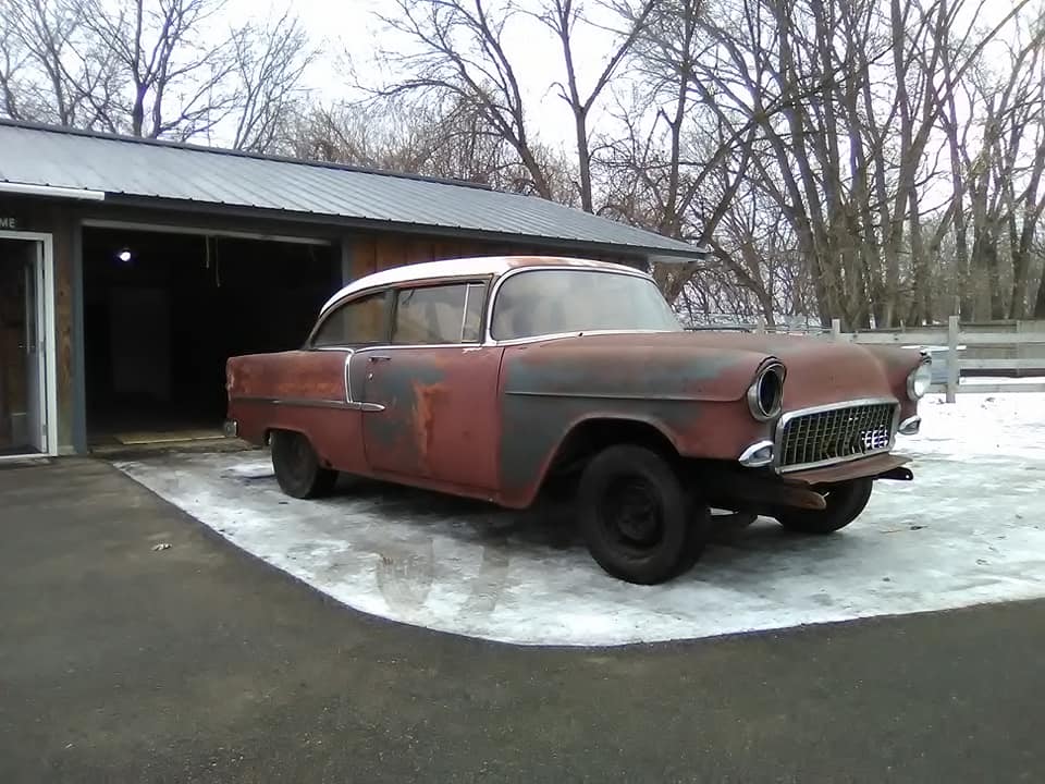

December 2019

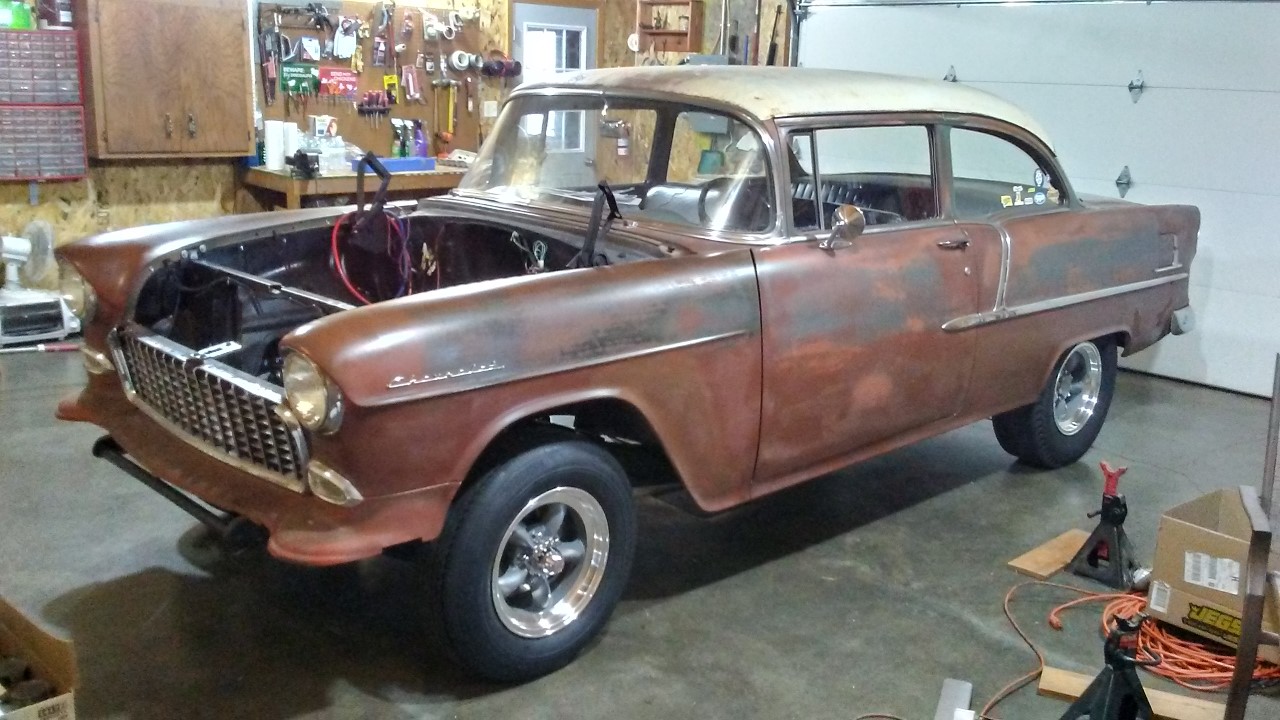

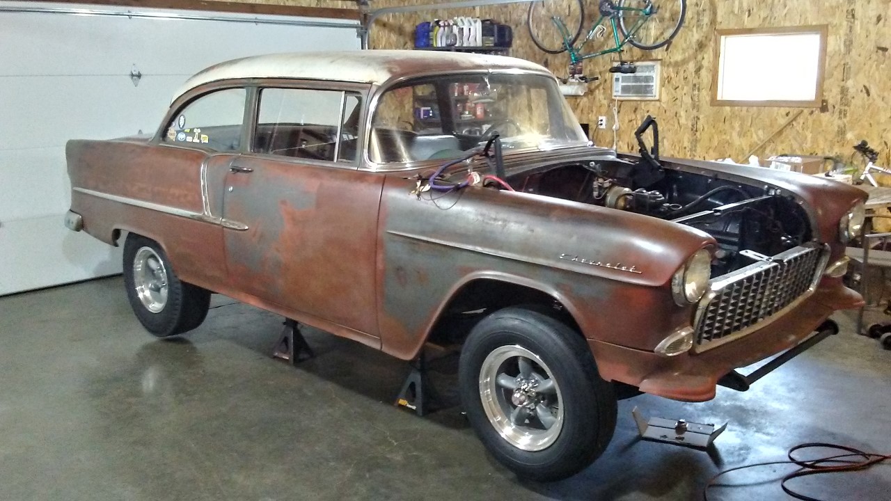

Got it back on the ground after months and months....stance seems pretty good, front will come down a little when engine, trans, hood etc are back in

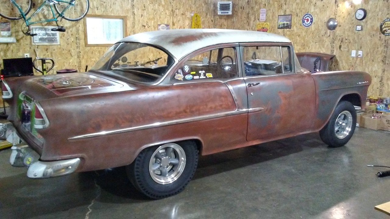

Pass side

Front should come down about level, if it retains original small block springs.
Are those pie crust slicks from Towel City ?
