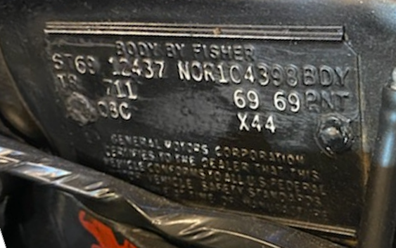

I thought I had a picture of the trim tag on the silver 69 but I don't. All I have is this photo from the Super Chevy Show at Gateway in 2012. The information I have from the tag is NOR104398, 711 69 69, 08C X44.
Looks a bit flaky to me.
Agree. That's a fake tag, as well as the one on the 69 Azure Turquoise L-78 car.
A really impressive collection, but as has been stated, not a lot of attention to correctness or realness of many of the cars.

That for sure is a fake tag. One of the obvious ones!
