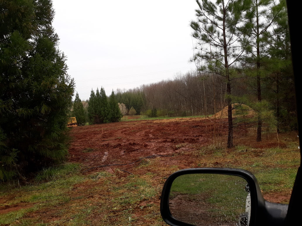

I know that I am in the whole thing at just under 50k. - no elect -no plumbing
5k - site prep
Pushing down an acre of trees and then grading, contouring, and filling and compacting then Laser scraping it level - that included the initial 20 tons of gravel at the drive cut off the road (This was a good deal, friend of my dad's, it was convenient for him in regards of location)
