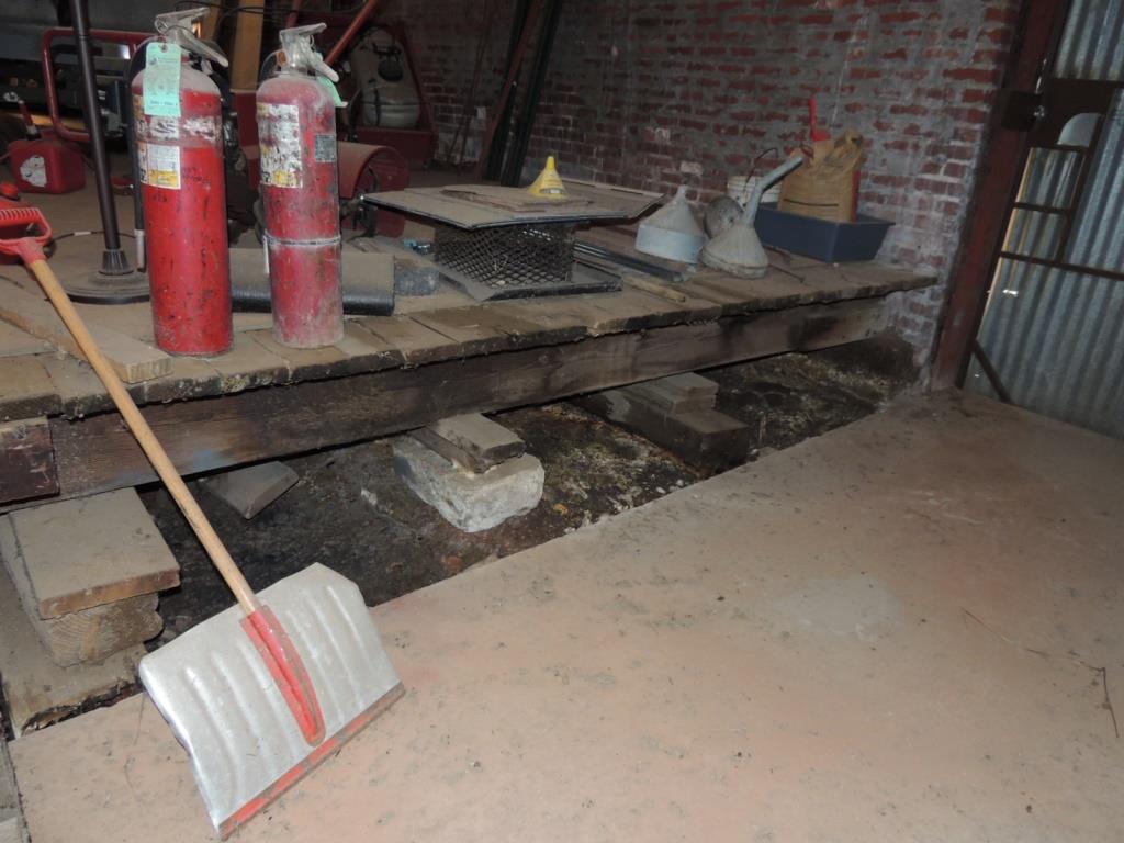

The floor was already concrete with virtually no cracks, except around the pole I removed making it a clear span area. The flooring just to the east is the original wood floor (building was used for coal storage in the 1920’s). 2 x 12 joists on 16 inch centers with 2 x 6 flooring planks. Previous owner was driving cars on it, so it was plenty strong. But, I wanted to wall off my work shop area so that I could heat it in the winter. I can stand the summer heat, but not the winter cold. The only ventilation for the crawl space was out to the shop area. You can see the crawl space in the first three pics below. First one is looking East from the North end of my work area. The building has no crawl space ventilation on either side. Well, not DESIGNED ventilation; but plenty of air gaps in the tin siding on the North. It was VERY damp under the wood floor. I mean really damp. I bought a bunch of steel grates to place strategically in the floor and was getting ready to wall that area off. Then I got greedy. Wouldn’t MORE shop space be better? Of course it would. So, the next plan was to remove about 1/3 of that wood floor. I planned to concrete it on the same level as the work area, so that I could store welding equipment, gantry crane etc. and be able to roll them over to the work area.

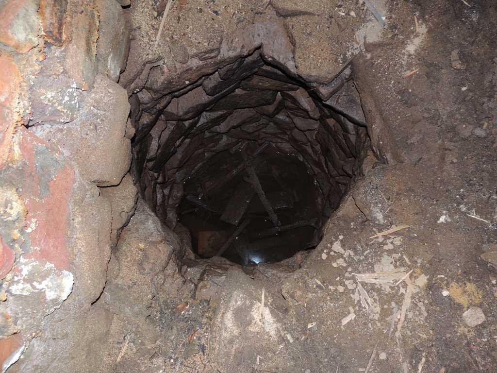

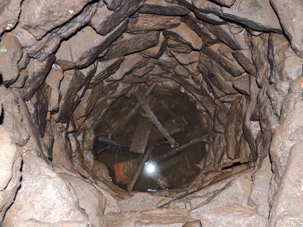

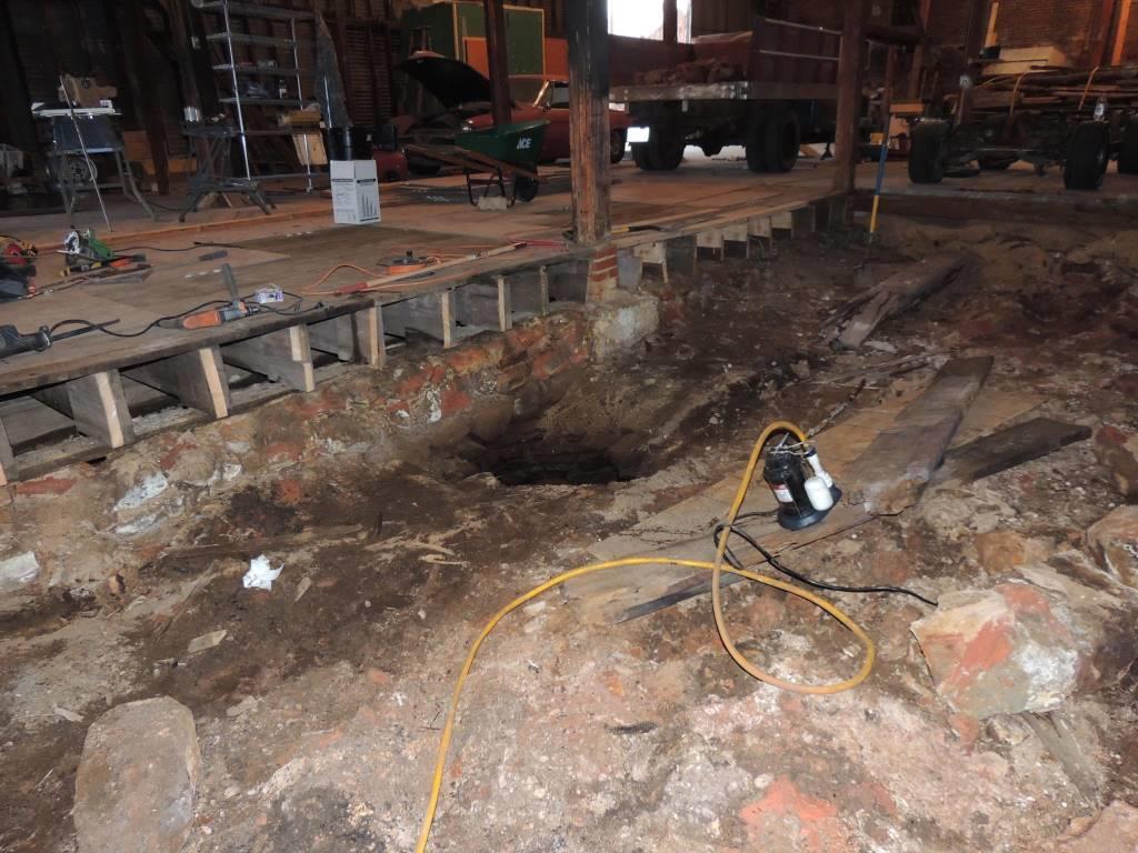

At first, I started pulling nails one at a time. Screw that, get the circular saw, and cut each floor board even with one side of the joist, and just use it as leverage to pull up the floor boards. Fortunately, one of my brothers was able to come over that Saturday and help. After removing about a third of that third of the floor, I noticed something black on the ground under the joists. I poked it with a pry bar, and found it to be a puddle of water. Talk about damp. No, not damp; wet. After removing enough of the flooring and joists that I could access the puddle, I stuck my pry bar all the way in. Didn’t hit bottom. Had my brother hand me a 6 foot piece of conduit; stuck it in. Still didn’t hit bottom. WTH??
We had uncovered a freakin artesian well. Pics below. No wonder it was always so damp under there. Went to Ace and bought a sump pump with float. Pumped it as dry as I could. Two nights later, we got ½ inch of rain. Thought I would go down to the shop and see if there was a couple more feet of water in the well. It was full again, after just ½ inch of rain. I have still not cleaned the well out completely (may find Jimmy Hoffa in there). There are pieces of wood at the bottom that are water logged. No telling what we will find when we finally clean it out. Hoping it was a wishing well. Photos of the well were taken about a week after we removed the flooring on that third. The well is bigger than it looks in pictures. It is 36 inches in diameter.
