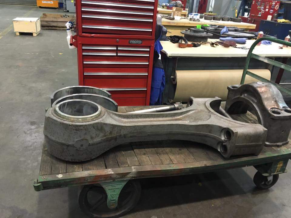

That's the smallest tool box I've ever seen. [img]<<GRAEMLIN_URL>>/naughty.gif[/img]
