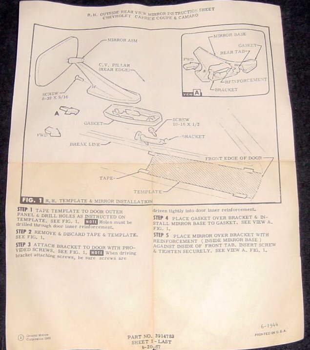

<div class="ubbcode-block"><div class="ubbcode-header">Originally Posted By: Kurt S</div><div class="ubbcode-body"> A template would be a good thing to find. </div></div>
For what it is worth, I used an NOS passenger side GM mirror on my 69 Z, still in the box. No instructions or template included. I realize it COULD have been removed, but doubt there was ever one in there.
  #42
Old 05-03-2016, 02:49 AM
70 copo 70 copo is offline
Posts: 3,834
Thanks: 219
Default Re: Aftermarket bumpers and Mirror Location 68 Camaro
Did an image search--found one dated June 1967. I hope this helps.
