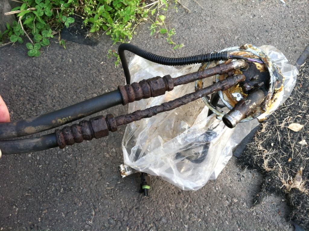

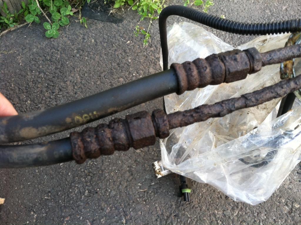

An addendum to the prior posts: If your fuel lines and brake lines are rusty and you replace them, make sure you drop the tank and replace the sending unit as well. The factory fuel lines have a rubber section that is crimped onto an additional length of steel line that connects to the sending unit outlets. The other day after filling the truck up with diesel I saw a puddle under the front of the tank where it was running down from the topside. Looking through the fenderwell with a flashlight we could see that the outlets were corroded so I ordered a new sending unit for $70 from rockauto.com. We dropped the tank and this is what the sending unit looked like. We were also not happy with how the tank looked so I ordered a new one from rockauto which should be here next week. Lots of crud was in the bottom and after checking with a mirror inside we saw corrosion on the inside ceiling of the tank.
Here's the old sending unit:

Just went through the same thing on my `95 7.4 Suburban a couple of years ago. I'd really like to replace all the hard lines on the chassis, but no one reproduces them.

The aftermarket makes the full set of stainless steel brake lines. The fuel lines were relatively easy to do with just the lengths of modern steel lines. Not a lot of bends in the suburban, and the factory frame brackets keep them clipped into location.
